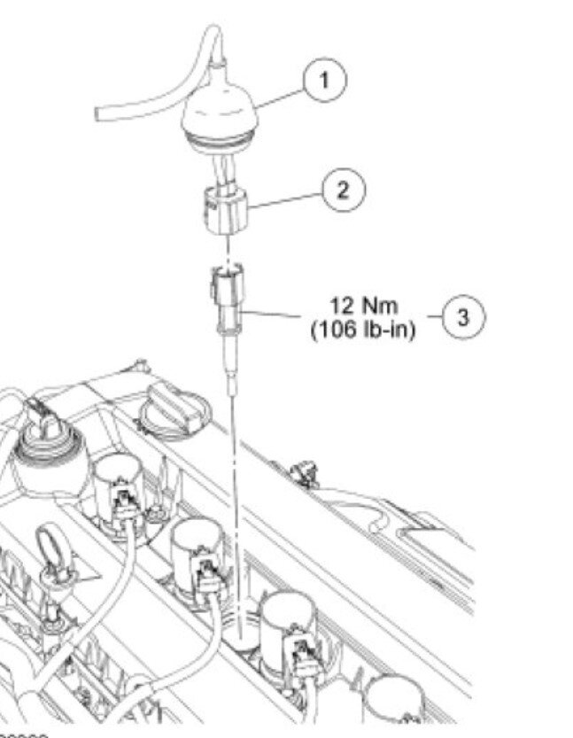

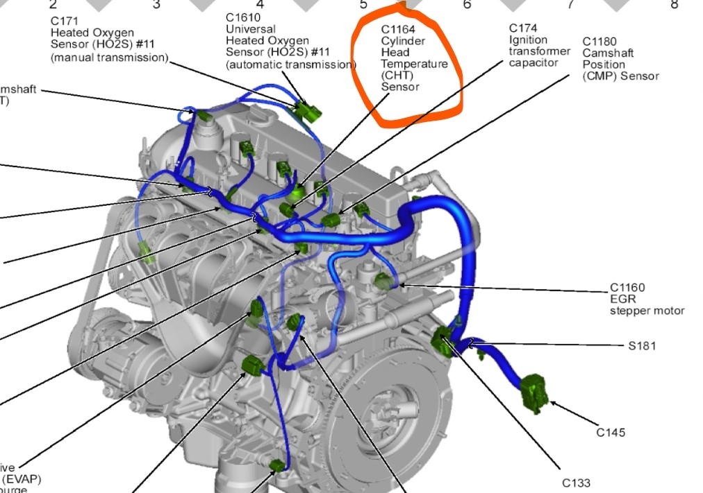

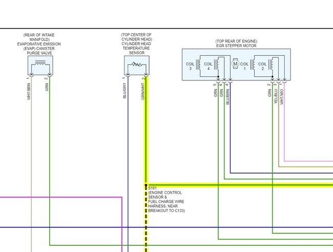

Not likely an issue caused by the oil as the cooling system sensor is on top of the engine between the cams and between cylinders 2 and 3. It could be a bad valve cover gasket letting oil into that area or the sensor is damaged by corrosion which is somewhat common. Replacement is simple, pop the cover off, unplug the connector and unscrew the sensor. Screw in the new one and connect it and put the cover back in place. If you find corrosion you will want to get a replacement pigtail and wire it in as cleaning usually isn't enough.

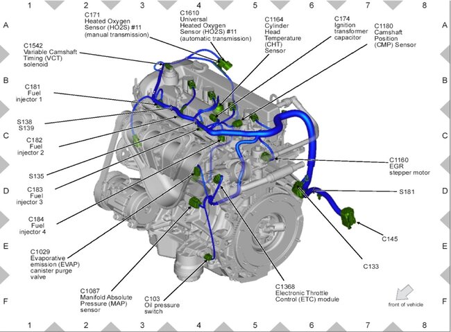

Hi Steve, thanks for the reply. Does this engine have 2 sensors? While researching the problem I’ve been getting conflicting information. Some say it’s on top and others say it’s the one under the air intake in front of the first cylinder by the oil filter. Do you also know if different engines were put in these cars? None of the videos or information I could find were about this engine. Thanks again!

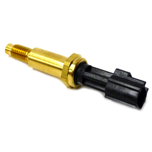

Single sensor up on top of the engine. Part #8S4Z6G004A Ford used both types on some applications when they used a different control for the cooling fans and gauges, then they went to the single CHT on others.

I appreciate the response. I just picked one up and will give it a try. Thank you.

Hey Steve, I was able to replace that sensor this afternoon and that doesn’t seem to be the issue. I was hoping not to have to bring it to my mechanic, but I don’t know what the problem is.
