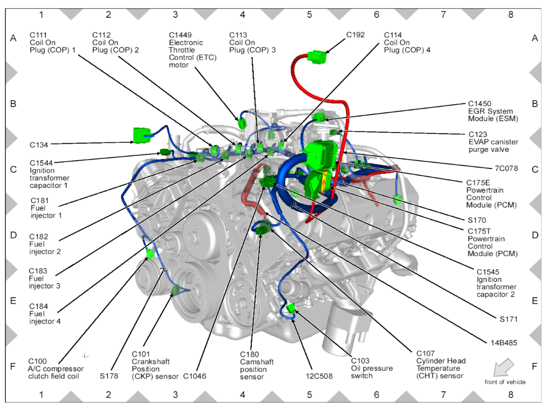

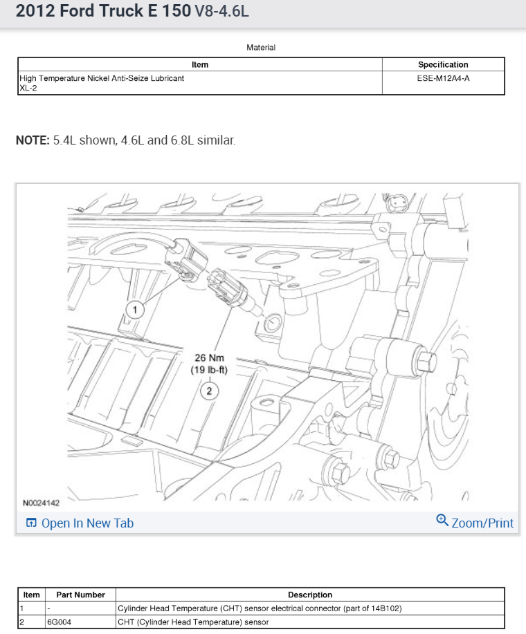

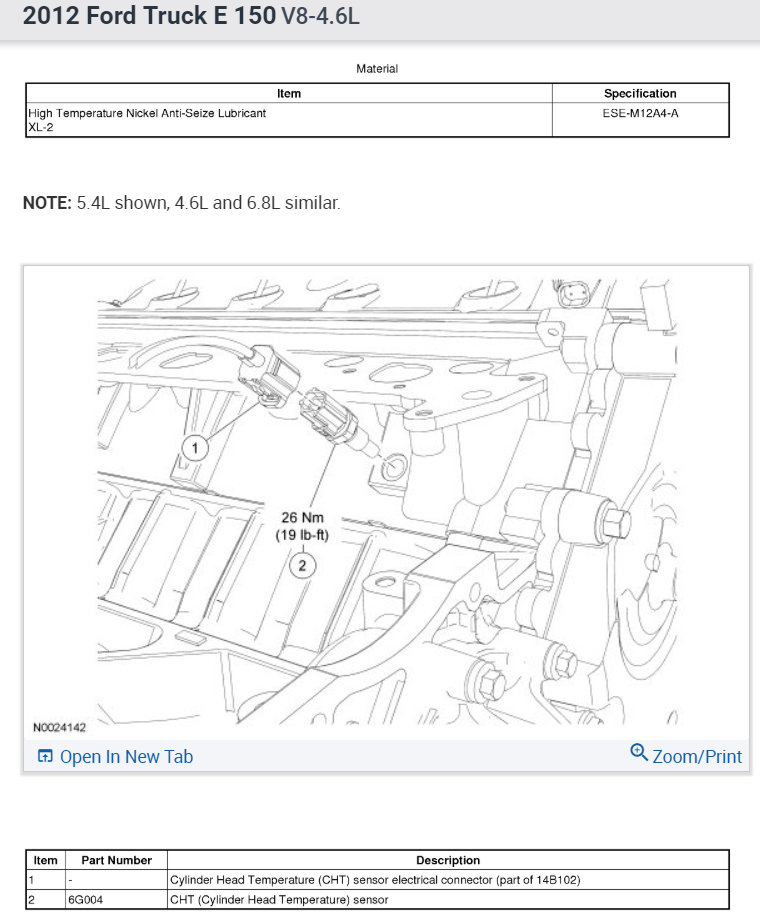

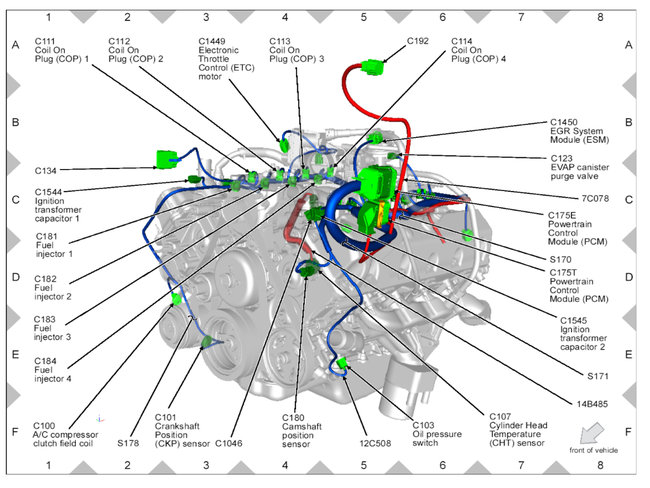

The engine coolant temperature sensor is in the front of the left cylinder head. Here is a guide that will walk you through the steps and diagrams and instructions below to show you how on your van:
https://www.2carpros.com/articles/coolant-temperature-sensor-cts-replacement
Check out the diagrams (below). Please let us know if you need anything else to get the problem fixed. Cheers, Ken
