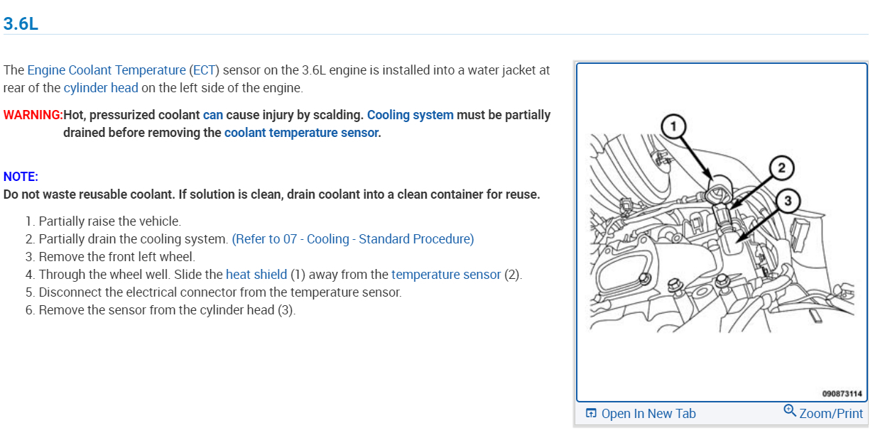

The blue devil is wild stuff, and it can plug things up or coat things internally. I would disassemble the system to remove as much of the blue devil as you can, (you will see it). Please remove the coolant sensor as well to make sure nothing is blocking its ability to read correctly. Here is the location, also replace the thermostat with an OEM unit. Check out the diagrams (below). Please let us know what happens.
