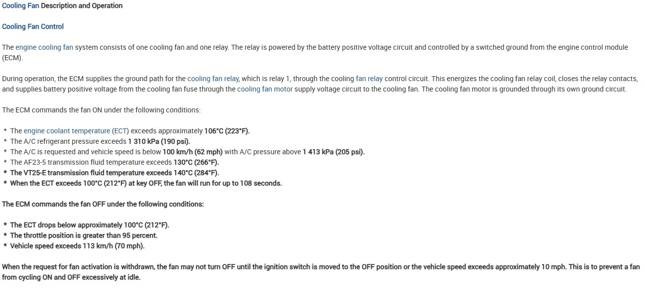

That truck should run about 210-220 normally. The fans should cycle on starting at 226 degrees and then off at 212. Turning it to defrost would turn on the AC compressor which is the reason it bogged down at idle. From your description it sounds like it's working as it should. The attached is the OE description of the fan operations.
Mar 1, 2025 at 7:30 PM
