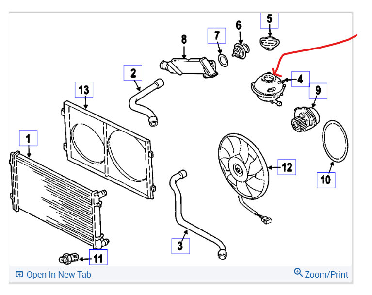

Please allow the engine to cool completely then open the radiator car and coolant reservoir cap to check the coolant level, it sounds like it is low.
Here is a video to help with instructions for your car in the images below:
