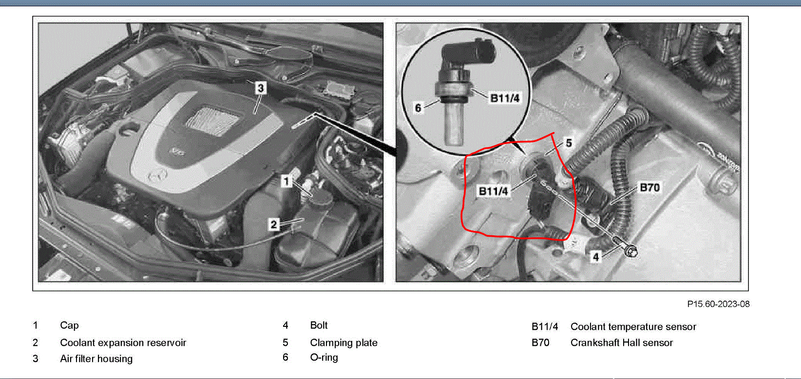

The car listed above is the sport sedan model.where is the coolant temperature sensor located and how to replace it?
Mar 23, 2020 at 12:38 PM
CERTIFIED EXPERT
110,175 POSTS

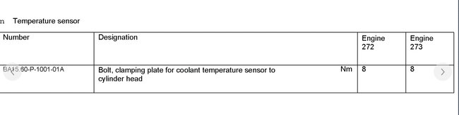

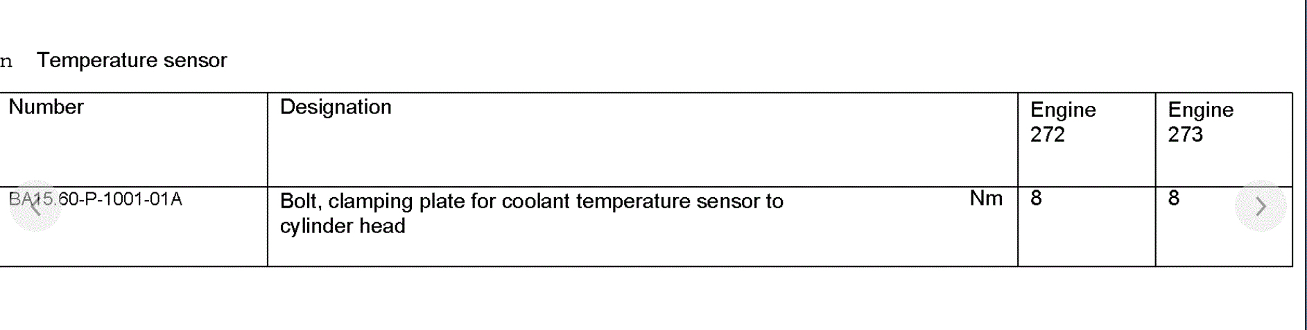

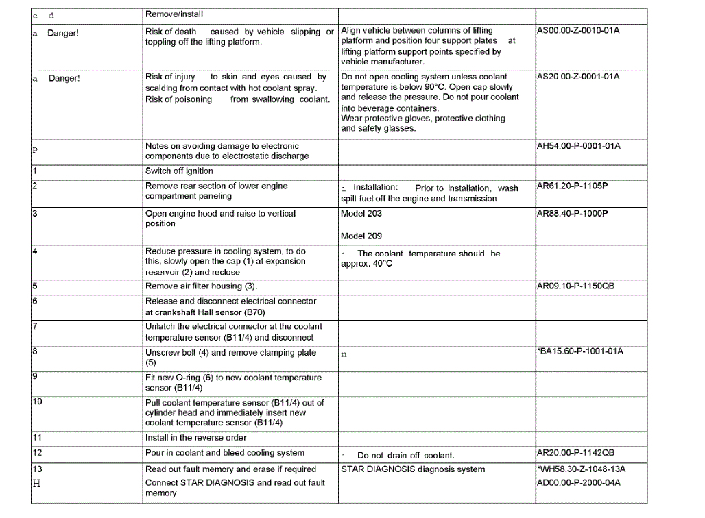

I attached pics below showing where the temp sensor is located (pic 1). The remaining pics are the directions for replacement.
Are you the person that is having the fog in the vehicle?
Let me know if this helps.
