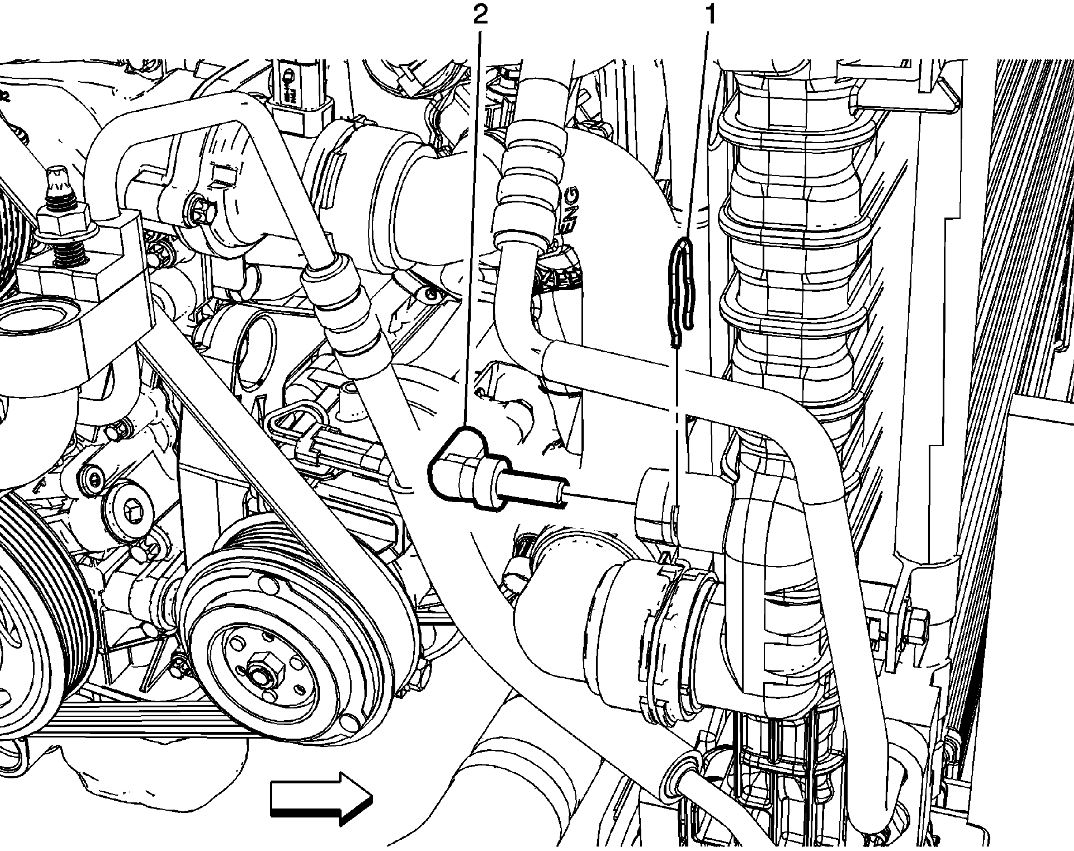

Anyone have a diagram of the coolant temperature sensor location?

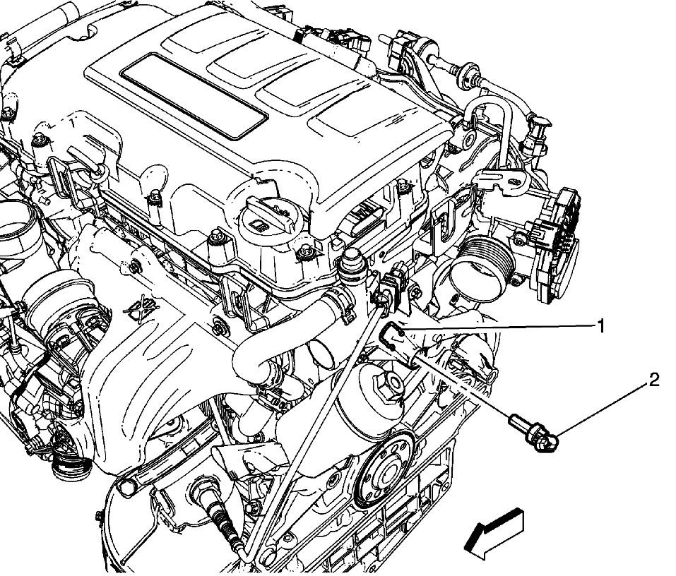

There are two different coolant temperature sensors on that vehicle. One is on the bottom right side of the radiator in the first pic item 2. The other is on the rear of the engine as in the second pic item 1.
