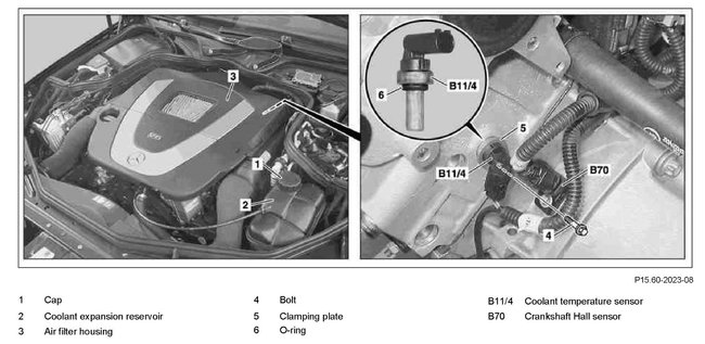

I was trying to find the location of the coolant sensor. All the videos and pictures are of a 2004. I need to know the location on a 2007 c230 sport. If you can give a description or video of the location that would be great.

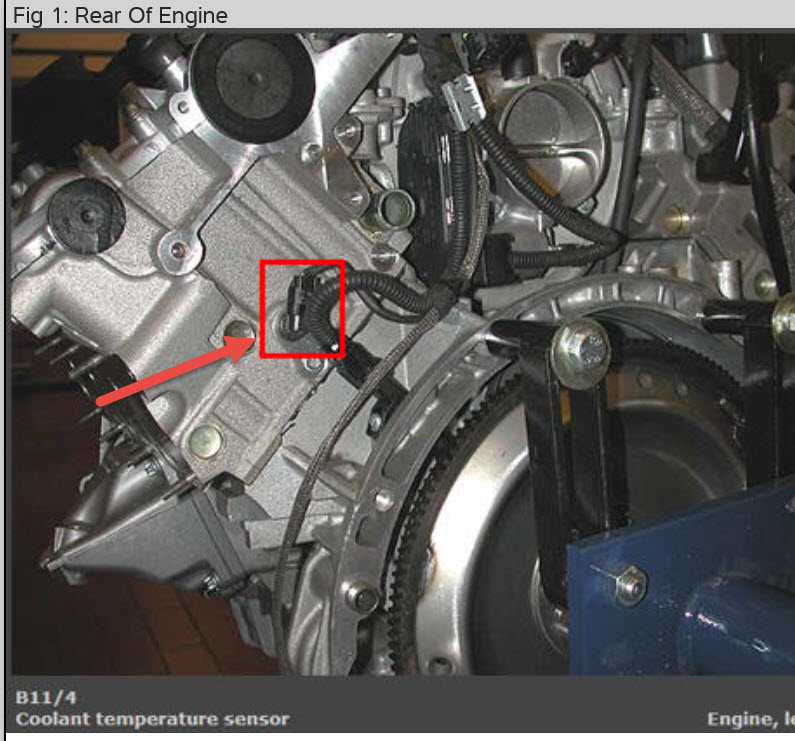

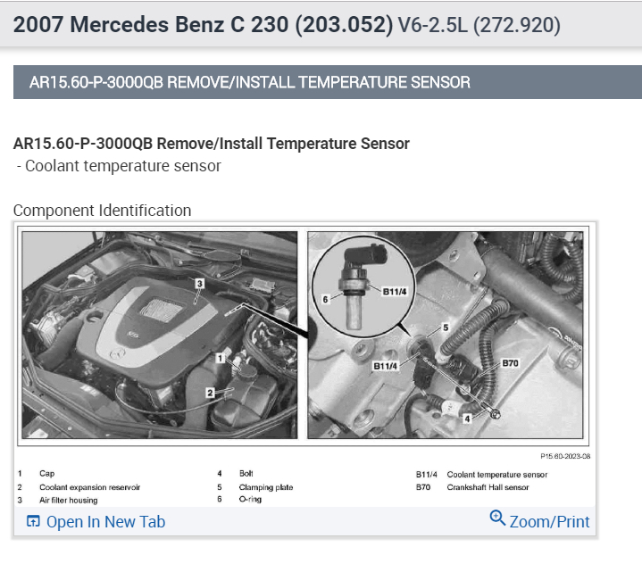

The coolant sensor is in the rear of cylinder head. To change it start by draining the coolant. Check out the diagrams (Below). Please let us know if you need anything else to get the problem fixed.
