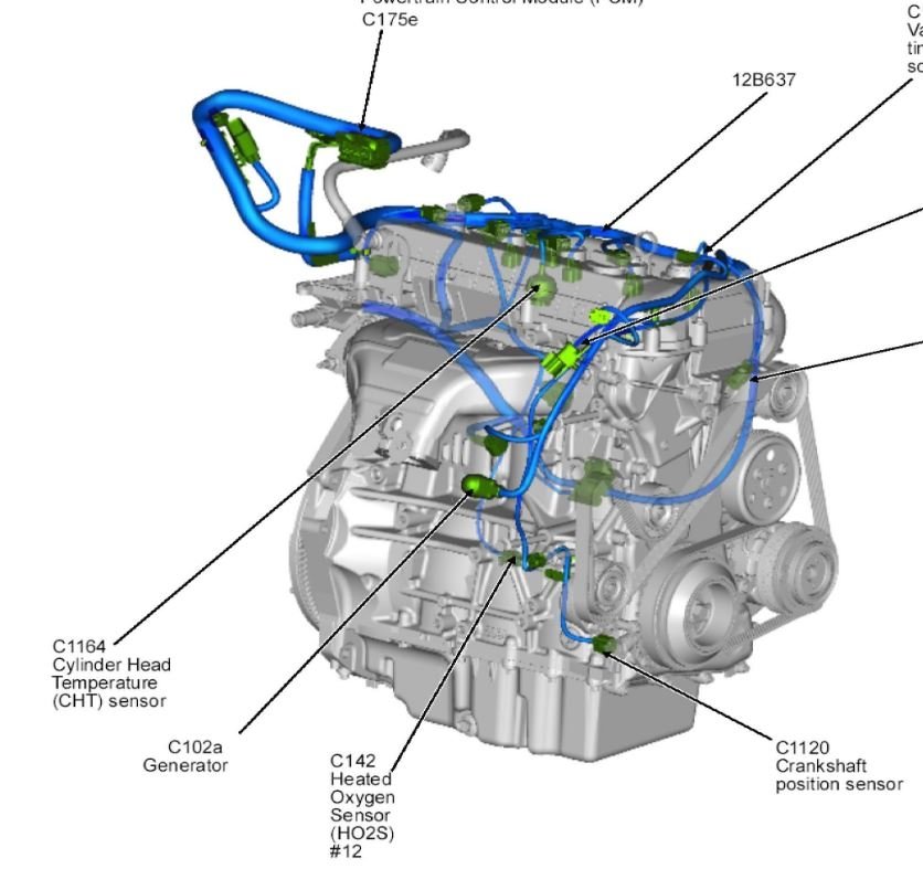

I ask because there is a known issue with the ECT setting false codes and causing unrelated issues due to a corroded connector (1164) on the ECT itself. The connector and sensor are located in the middle of the valve cover in the center of the top of the engine. Inspect the cover for dirt/debris that can block the drain area in the rear of the cover. Clean as required. Then remove the connector and check it for corrosion. Minor corrosion can be cleaned and apply some dielectric grease to prevent further damage. For extreme corrosion you will want to get a replacement pigtail for the ECT and a new ECT sensor. Replace the connector and sensor.

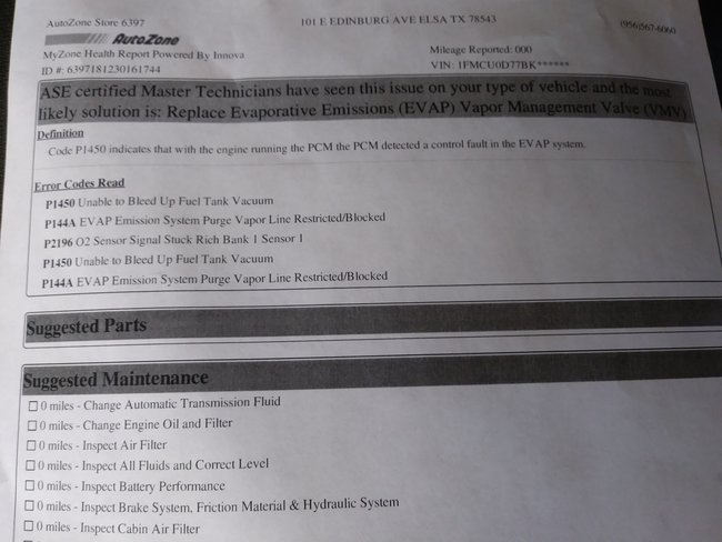

The vehicle has been jerking at stop lights occasionally, high gas consumption, will sometimes just turn off while driving-no mph change, just completely shut off, but lights still work, it also has a high idle, and the check engine light goes off and on. We did change the spark plugs recently, as well.
We got it tested and was told it was most likely the coolant temperature sensor.

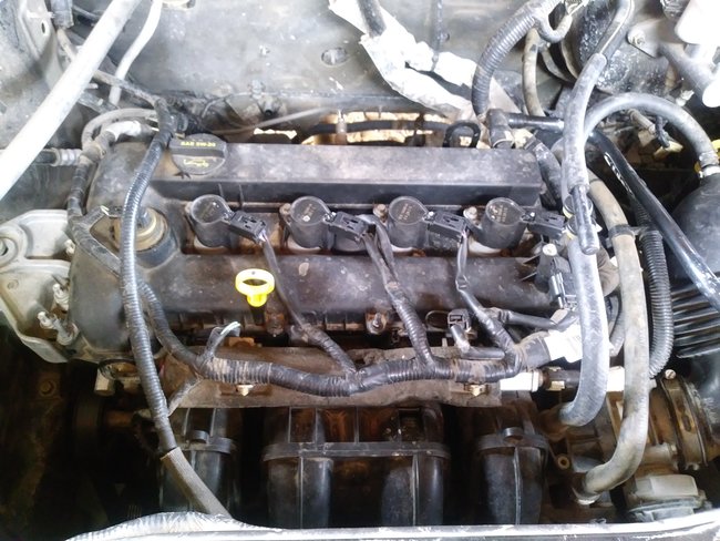

Attached are images of the codes we were given, the sensor we bought, and a top view of our engine.

From those codes I don't think it is the coolant temperature. It looks more like the EVAP purge solenoid is stuck open and allowing the engine to draw in a lot of extra fuel vapor. That would give you the rich mix, poor mileage and other codes.

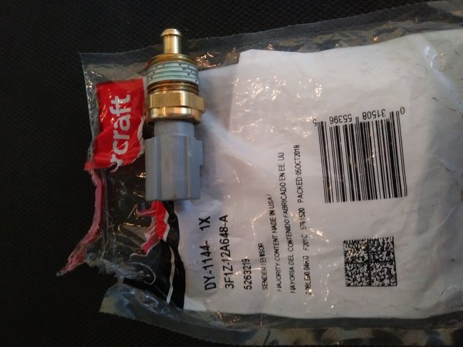

The sensor you show only feeds the temperature gauge.

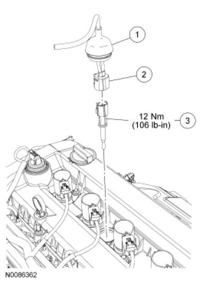

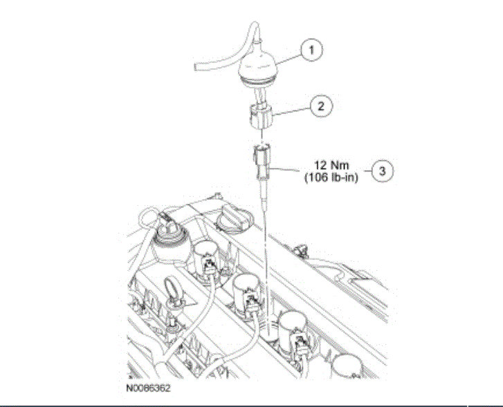

The engine temperature the PCM monitors is through the sensor located between the center two coils on the cylinder head. Under the rubber boot. That is the cylinder head temperature sensor.
It could cause a rich condition but it wouldn't cause the EVAP codes and a rich condition both like a stuck open purge solenoid would.

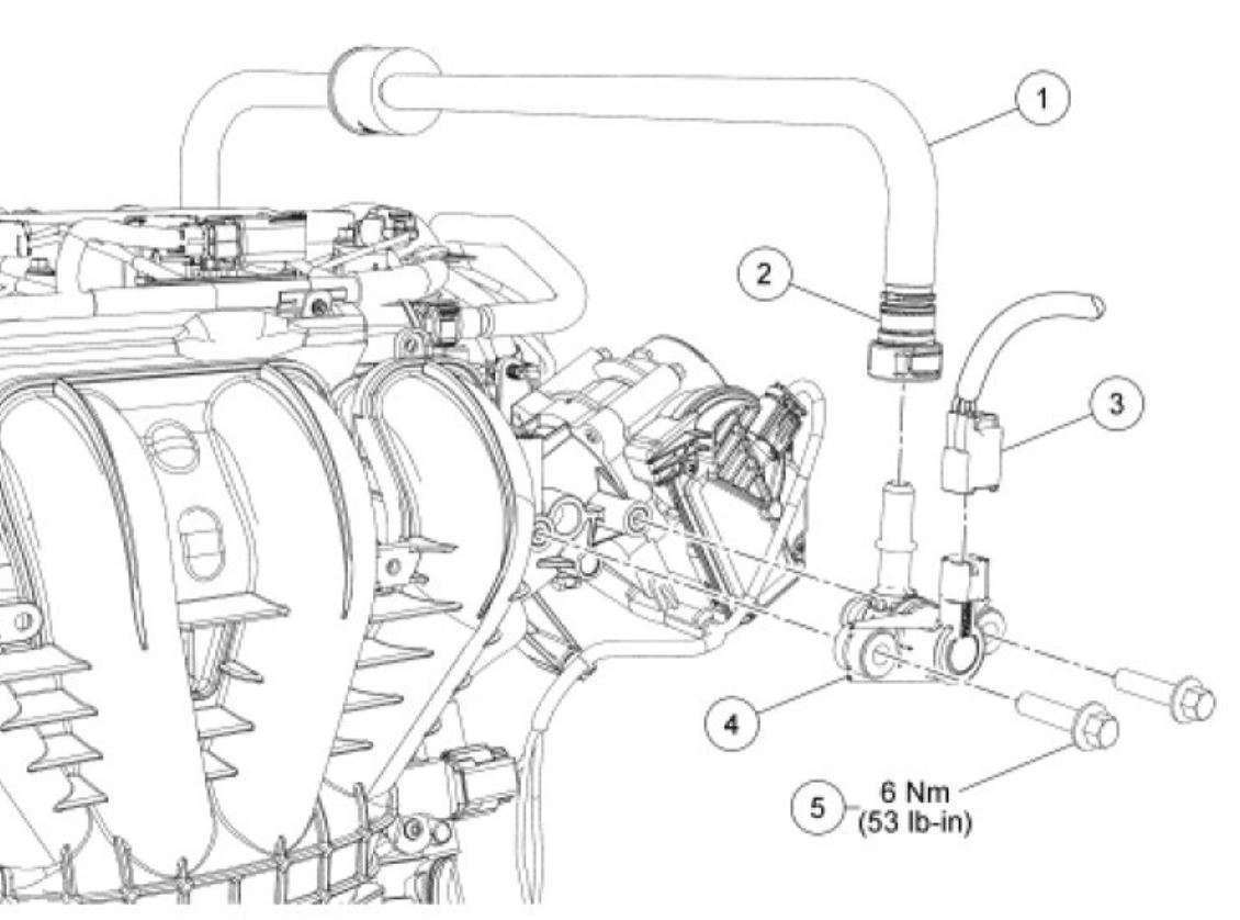

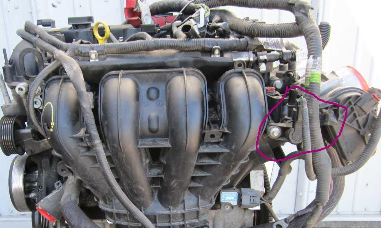

The solenoid isn't hard. It bolts to the engine on the intake manifold between the large plastic section and the throttle body. See the attached images. There is a quick disconnect that leads to the fuel vapor tank that just unclips. To test the solenoid valve you can disconnect the tube from the top of the valve at item 2, Disconnect it's electrical connector item 3 and then start the engine. There should be no vacuum at the port connection you removed item 2 on the solenoid. If you can hear/feel a vacuum the valve is stuck open. Changing it involves removing the two bolts and pulling it out. Reverse the process to put the new one in, if needed. If the solenoid seems to be okay then you need to do more testing to determine what is causing the issue. For that you really need to have a scan tool to watch the fuel trims and test the system to see what is wrong. A stuck injector could cause the same issue but you don't show any misfires so I'm thinking that likely isn't the problem.

Hmm, the images for the purge valve didn't load for some reason. I'll add them here.
For that sensor all of the information I have doesn't show the ECT sensor you have being used on your engine in your vehicle, it shows only the cylinder head temperature sensor being used for the coolant temp input and fan control inputs to the ECM. Normally the newer Fords only use one or the other and not both types of sensor. It shows the 3.0 V6 engine as having the coolant sensor that you have.

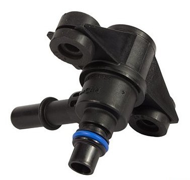

Can you maybe send a picture of what the part is suppose to look like for our vehicle? We would much appreciate it.

It is item 4 in the outline image above. Also the attached. The part with the blue ring goes into the intake.

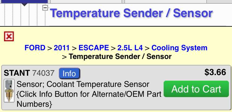

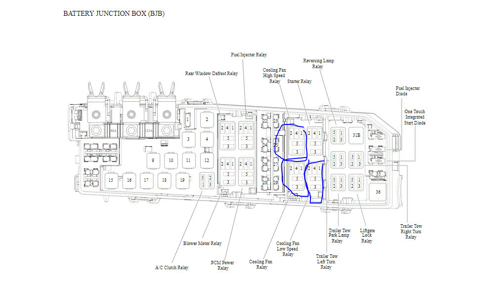

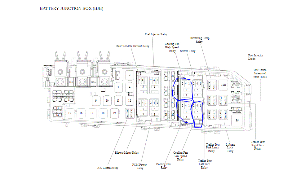

I'm having trouble figuring out if the engine coolant temperature sensor is the same thing as the cylinder head temperature sensor. I've replaced that one in hopes of getting my cooling fans to return to full operating function. I bought a coolant temperature sensor off of Rock Auto that states it's for my year make and model but I can't find this anywhere under my hood at all. Also can you please tel me of 30A 30C 30D which is what of the cooling fan relays so I can work on those if they need to be replaced.

This is the coolant temperature sensor I purchased already:

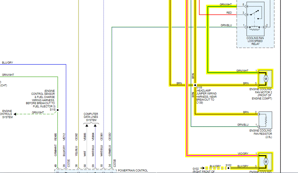

Good afternoon,

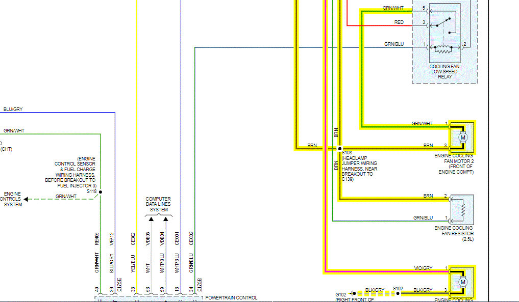

I attached a picture of the location for you of the sensor.
To test the system, turn the key to the on position and remove the connector from the sensor. The fans should come on full speed.

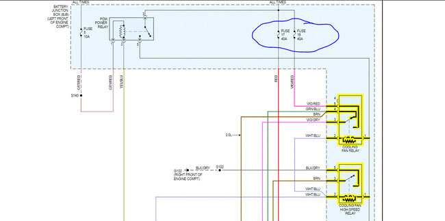

I attached a wiring diagram for you to view. You will need a test light and voltmeter to do some testing if it does not work.
Jul 5, 2021 at 11:44 AM (Merged)

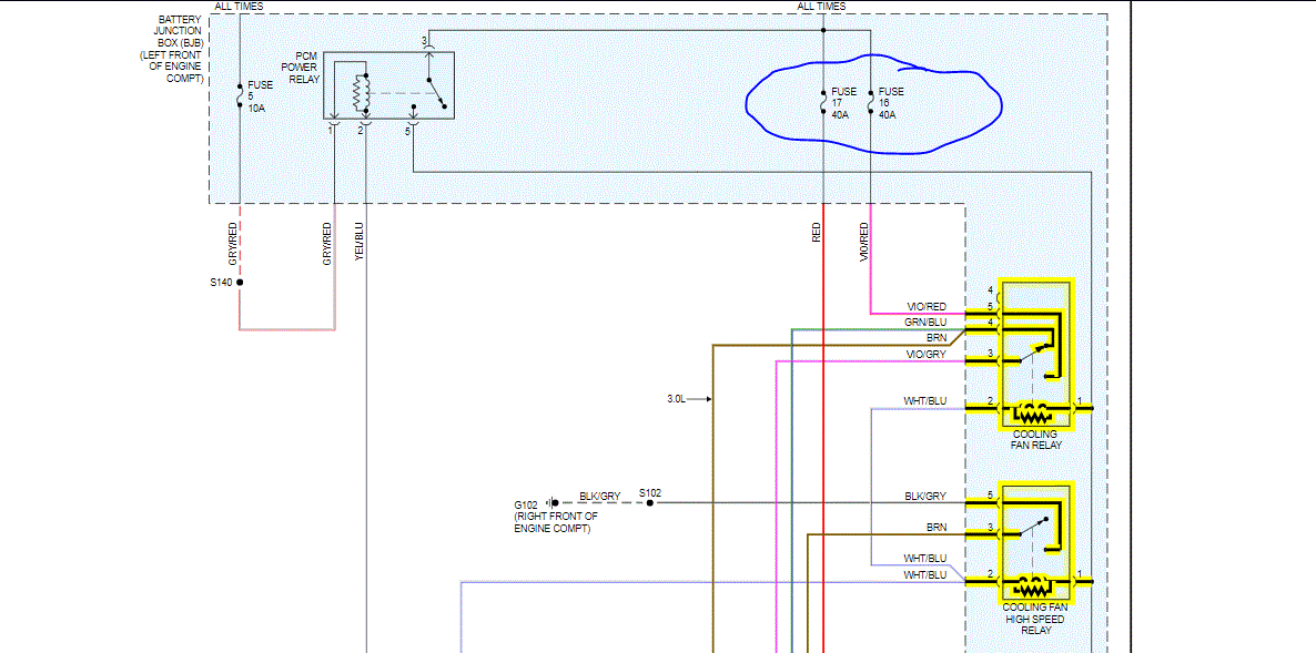

I also pulled the sensor to visually inspect it and it looks fine, I also blew out the dust in the port where the sensor goes along with the threads of the sensor. I also question the connection it might’ve had as well as it didn’t seem nearly as many turns to unscrew it as it was to put it back in fully with (1) 1/4 turn once fully threaded in. I inspected the wiring pigtail as well and there are some questionable spots but per my inspection I don’t see any breaks in wiring, bends yes so I smooth those out to be best abilities. I reset the error code as well and was gonna allow it to just run for a good 5 minutes get fully warm etc., and see what happens. What do you think I should do? Those maxi fuse 16 and 17 appear to be okay I don’t see any breaks in top portion of the fuse but truthfully those are hard to see.
