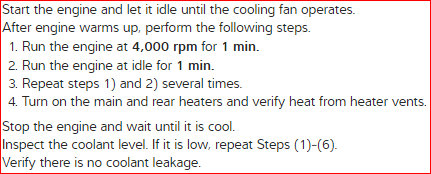

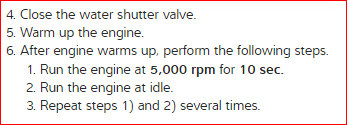

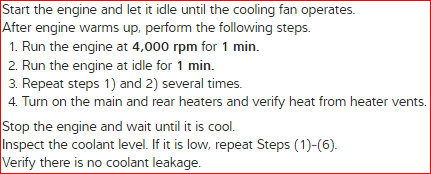

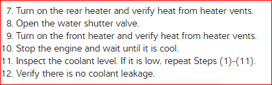

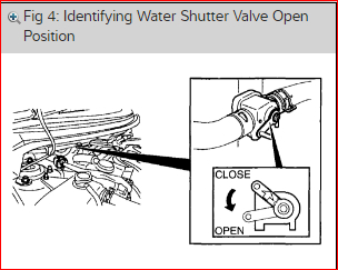

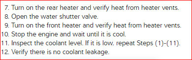

I drained my coolant system pulled drain plug on radiator to change my thermostat. I filled up my coolant reservoir and the radiator is not sucking up the coolant and the system is not burping and there is no cap on the radiator. So I could use all the help I can get. Thanks, Matt
