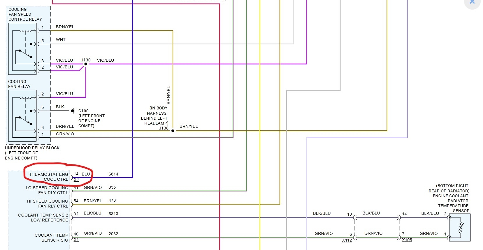

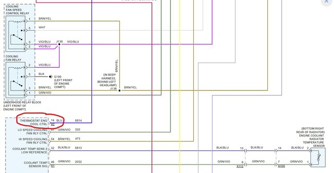

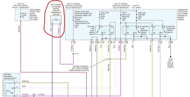

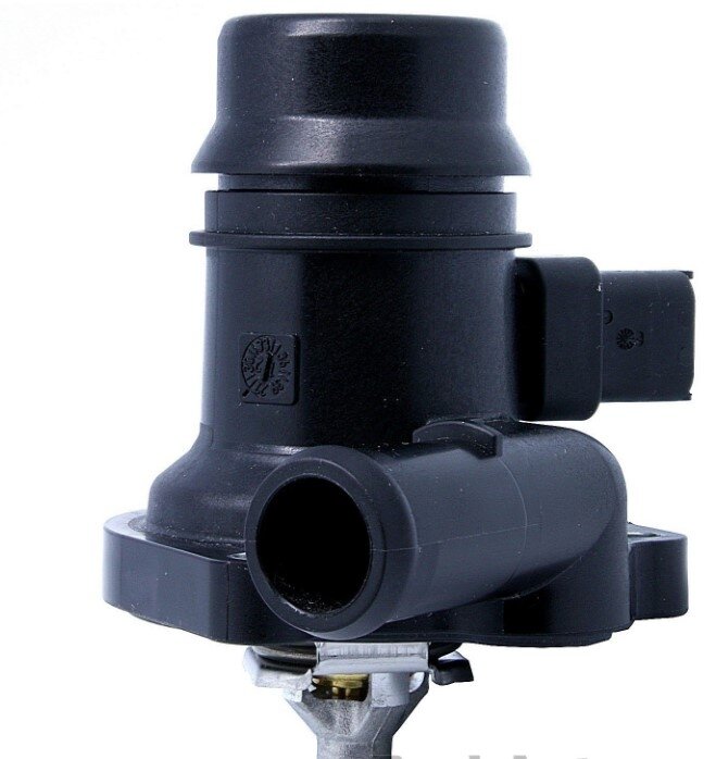

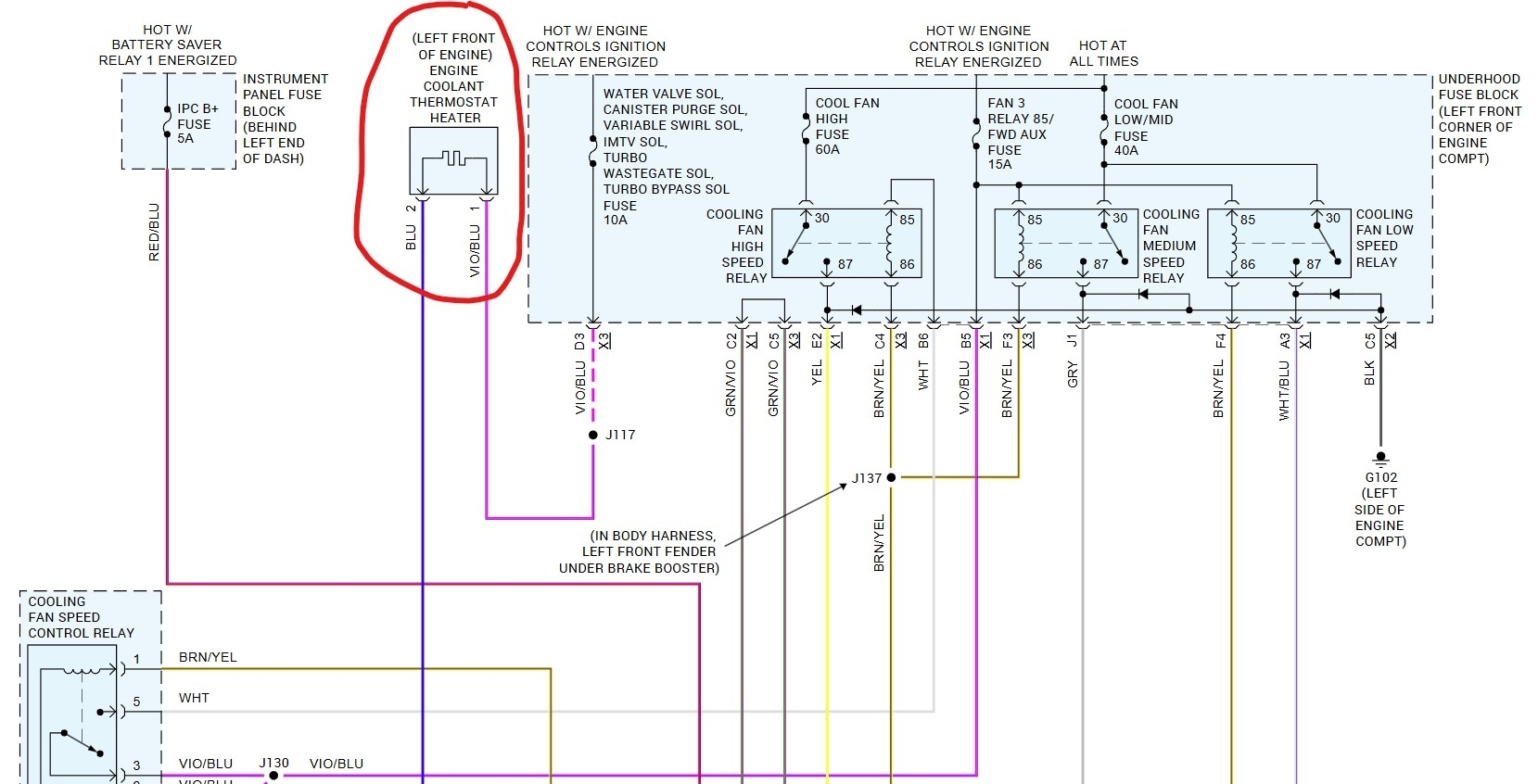

P0599 is for a thermostat heater control circuit high voltage. The circuit is fed voltage in on the Violet w blue wire, the PCM turns the heater on and off using PWM voltage on the blue wire. The heater controls the thermostat through the connector on it. You can test the circuit using a meter to measure the resistance between the two terminals on the thermostat. It should be between 13-15 ohms for a good heater. If that test is okay, then the next step is to use a test light and touch the connector for the Violet wire on pin one. If you have voltage there and the heater tests good then the next check is to see if there is an issue in the heater control side, that is the blue wire on pin two. The easy way to test that part of the circuit you need a scan tool.
