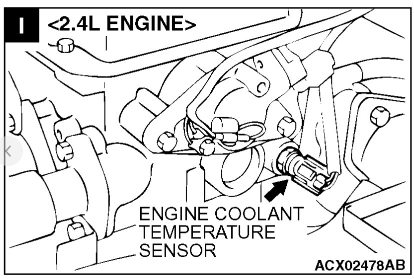

location of coolant sensor for the car listed above SXT model 16 valve engine.
Aug 2, 2019 at 11:11 AM
CERTIFIED EXPERT
18,907 POSTS
Hi Silverswan,
Are you talking about the engine coolant temp sensor? If so, it is on the rear of the cylinder head. Here is a drawing of it.
Let me know if you intended another sensor. Thanks
