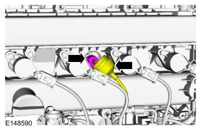

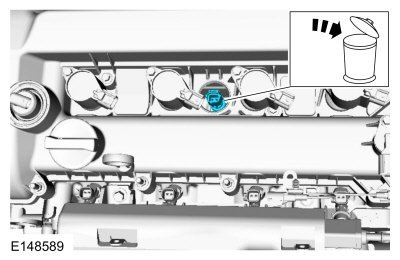

It just screws out. You shouldn't have any trouble. Here are the torque specs for when you are installing the new one:
Installation
1. Note: Make sure that a new component is installed.
Torque : 106 lb.in (12 Nm)
Please note that the torque specs are inch pounds and not foot pounds.
