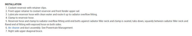

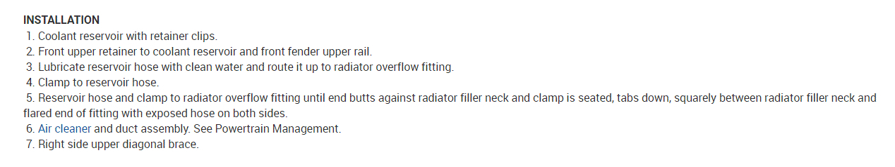

Additionally, if you look at the two pics below, they include a pic and the directions specific to your vehicle for replacement.
I hope this helps. Let me know if you have other questions.
See pics below.
