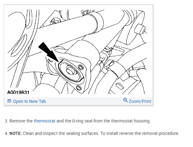

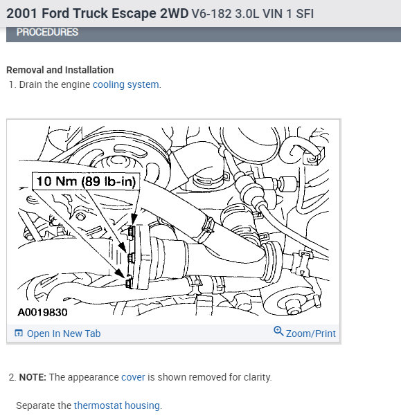

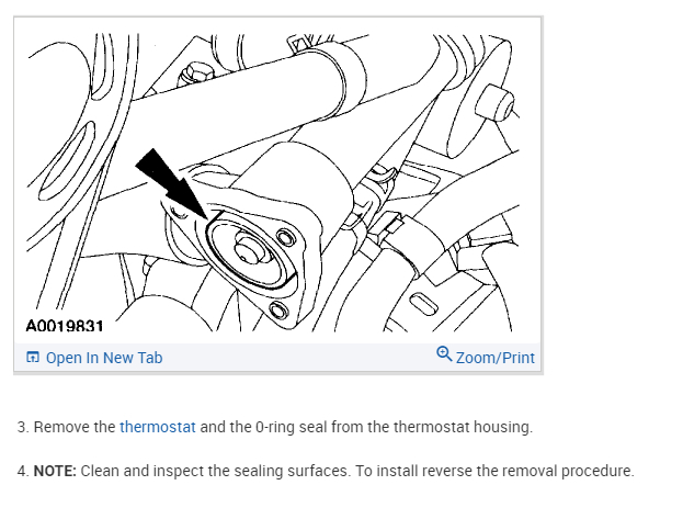

It sounds like you might have a stuck closed thermostat. The radiator hose will get stiff when the thermostat does not allow coolant flow and that is what leads to the overheating.
Take a look at these helpful guides:
https://www.2carpros.com/articles/engine-overheating-or-running-hot
I have attached the replacement procedure below for your reference.
Let me know of any questions.
