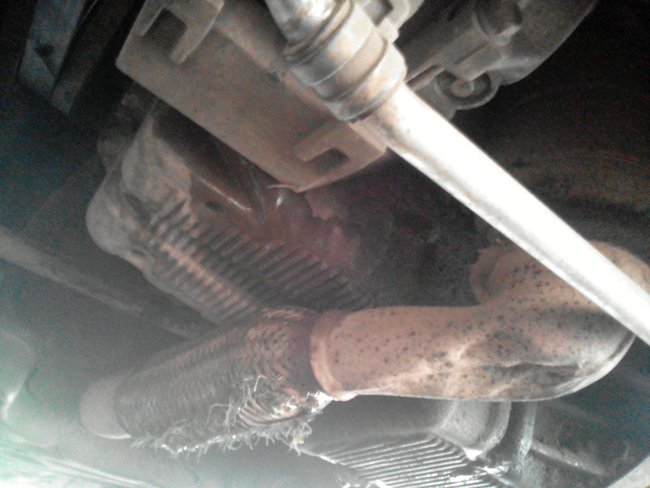

I added to coolant tank and I found water was falling downward somewhere from engine
Sep 1, 2017 at 8:58 PM
It looks like you have a water pump or freeze plug problem, Here need to see up where the leak is coming from a little better, jack the car up and use a flashlight.

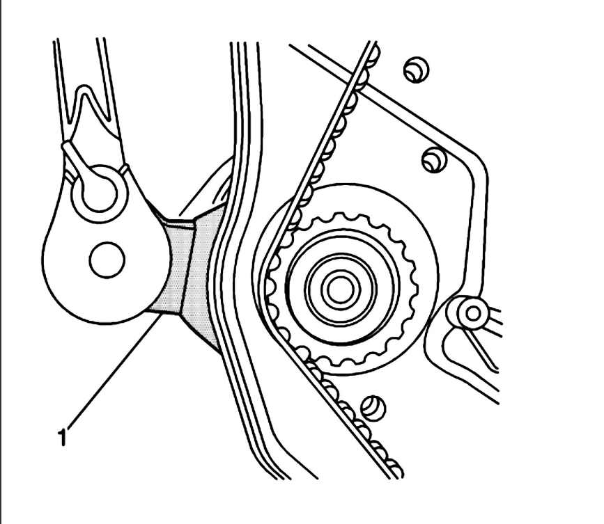

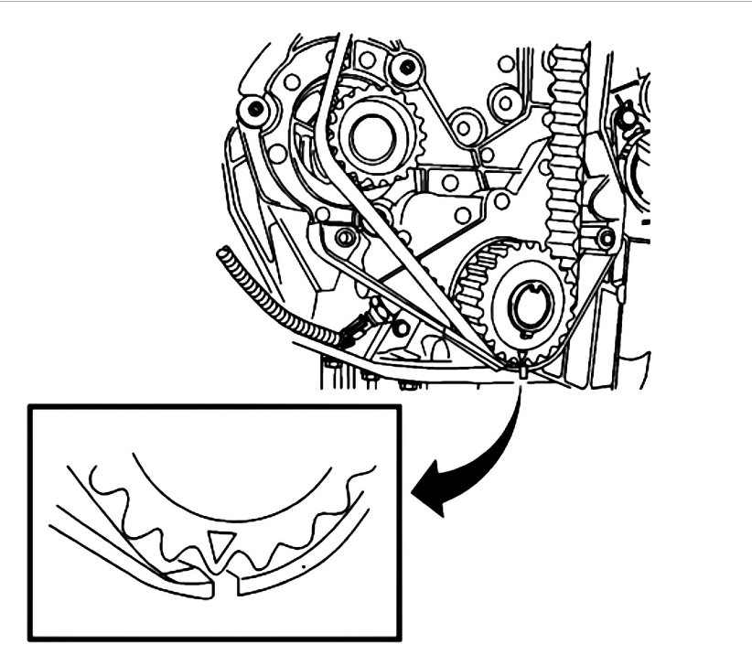

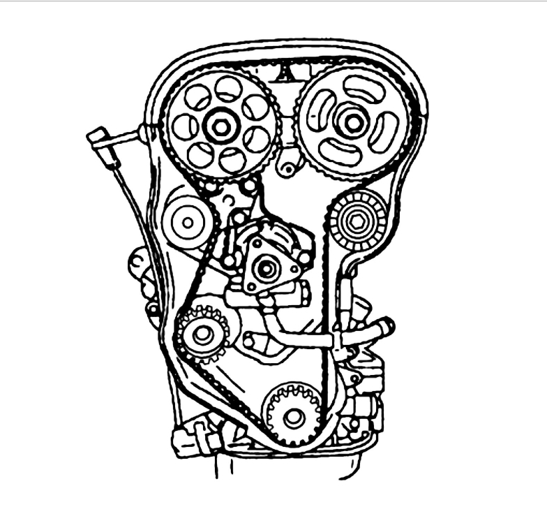

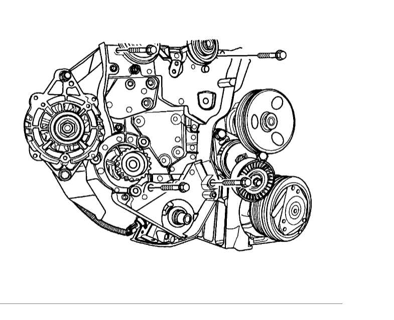

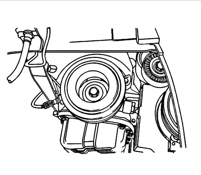

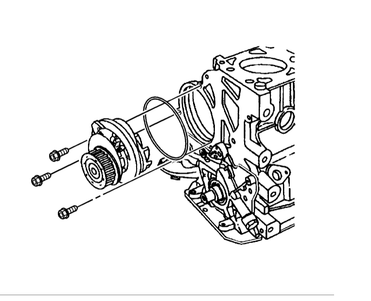

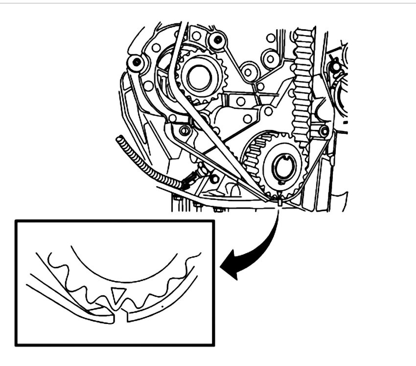

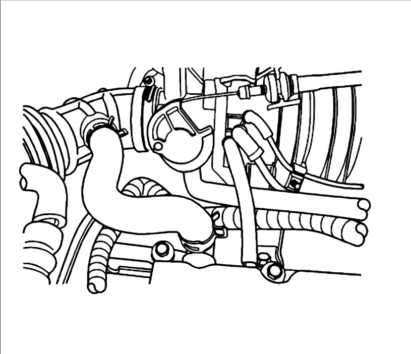

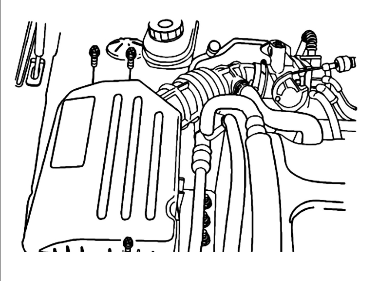

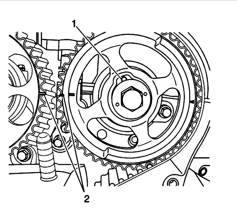

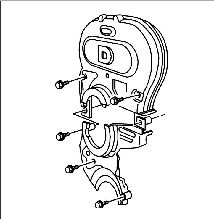

You must replace it with a new one along with the timing belt. Here are some guides and diagrams (Below) of how the job is done on your car. The guide is a general one but still give you an idea on what to do.
https://www.2carpros.com/articles/water-pump-replacement
Here are the parts on Amazon water pump and timing belt with tensioner for $107.00 and its AC Delco which is the best brand.
https://www.amazon.com/gp/product/B004JB5BIM/ref=as_li_qf_sp_asin_il_tl?ie=UTF8&tag=2carprcom-20&camp=1789&creative=9325&linkCode=as2&creativeASIN=B004JB5BIM&linkId=6a952a6d4571304bfe7c328402932d08
Book gives it 2.7 hours but it might take a little longer. Set some time aside and have fun.
