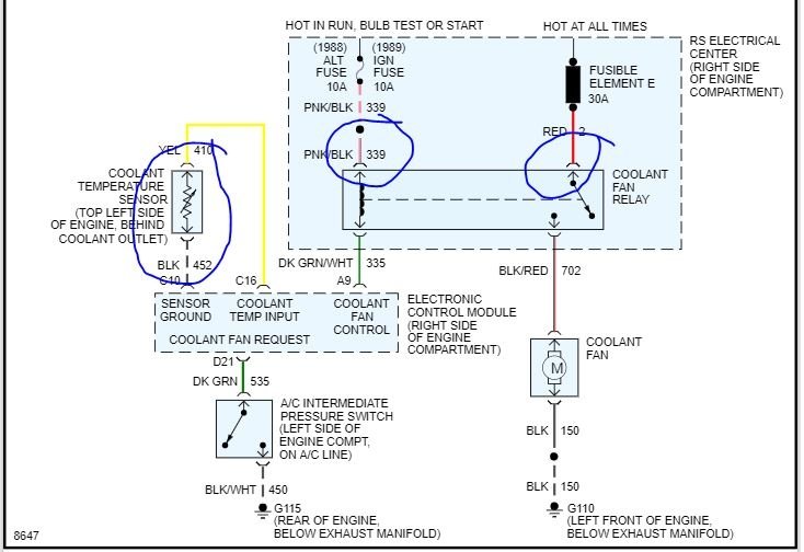

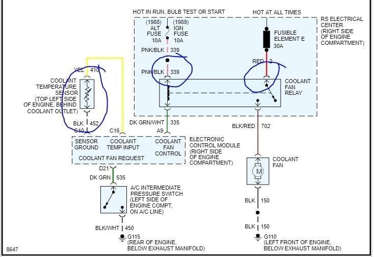

I had to replace 2 hoses because they were leaking. I replaced front lower and recovery tank hose. I refilled coolant half water and half coolant 50/50. I jacked car and put heat on, heat was getting hot and hoses were also getting near engine temperature.
Coolant light then comes on. I add more coolant light goes off. I test drive vehicle and connected a scan tool to check coolant temp. While driving and at idle i notice the temperature wasn't rising to engine temperature 195 of thermostat. It kept dropping.it would be at 97 than never climbed back.
I pulled back into the drive, add more coolant and light went off. temperature still didn't increase.shut car off.

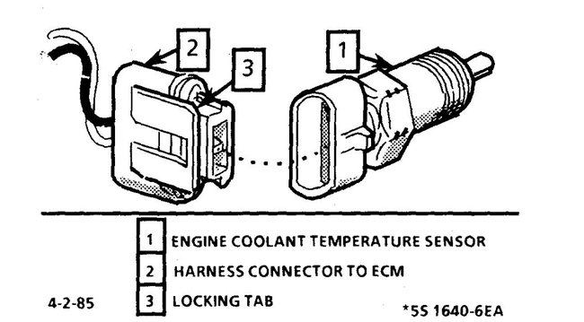

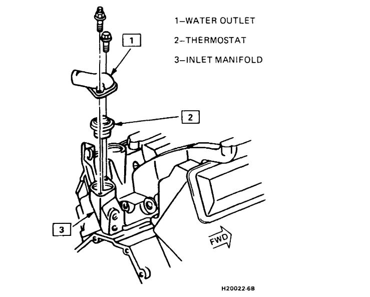

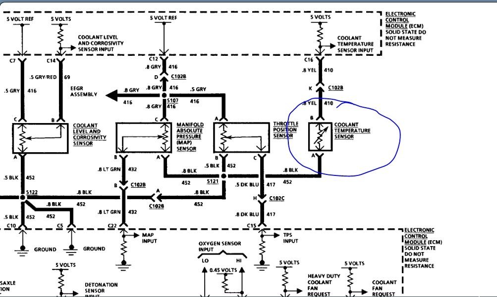

I replaced thermostat and coolant temperature sensor last year because i had to replace my intake manifold gaskets. Even though i have heat and engine is getting hot, could it be that the thermostat and coolant temperature sensor is defective?
