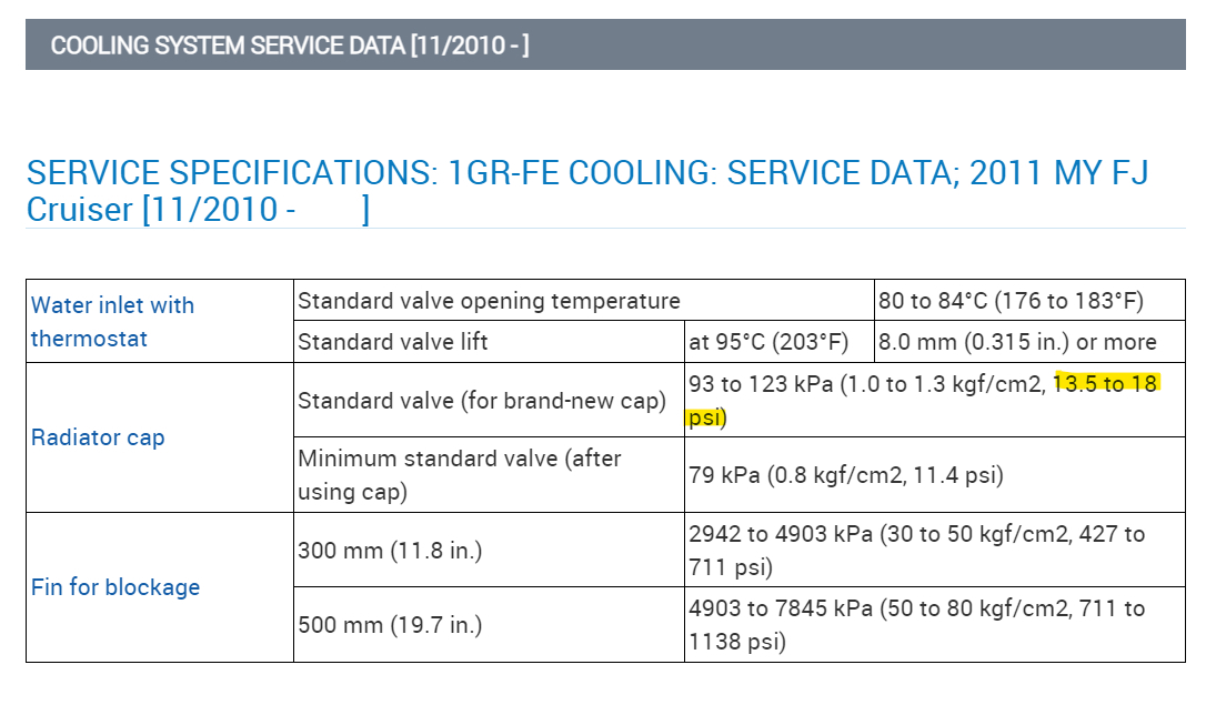

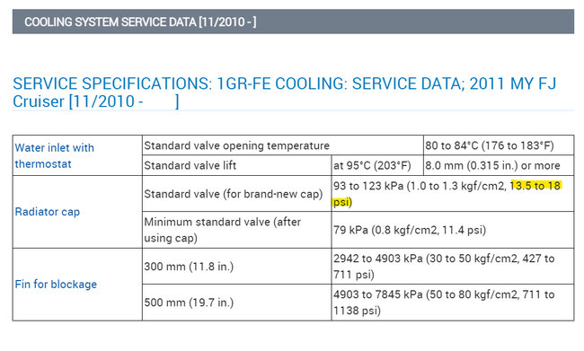

Hello, do you have an overflow tube hooked up to the top of the radiator that goes to a coolant reservoir? If you do and everything is where it should be, you can rent a coolant system pressure tester from AutoZone. Most systems will run about 15 PSI or so, the kit includes are pump that screws onto the radiator cap opening and you can pump the system up to the correct amount and check for leaks this way. It will bring the cooling system up to operating pressure without having to run the vehicle. They work very good. Do this while the system is cold, that's the time you're most likely going to find a leak. You should be able to spot it pretty easily, since I assume you're finding a puddle of coolant under the vehicle. Just don't pump up the system too high. I think the max would 18 PSI, but start lower and look for any leaks.
Here is the spec for the cooling system pressure.
