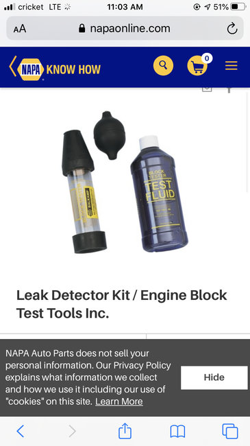

Will this work?
Mar 10, 2020 at 9:05 AM
That is the chemical kit.
I am not a fan f them as I stated. I believe in the leak down test for confirmation.

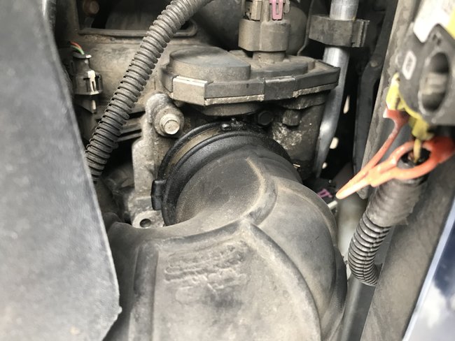

What is this part on my vehicle? Right in the middle of the engine, in the front.
Mar 10, 2020 at 3:59 PM
I see about 5 different parts in the picture.
Which part are you referring to?
Mar 10, 2020 at 4:03 PM
PLUXO
  • 71 POSTS
Roy,
Sorry about that. The big black thing shaped like an L that looks like it has a small leak.
Mar 10, 2020 at 4:04 PM
That is the air intake hose from the air filter to the throttle body.

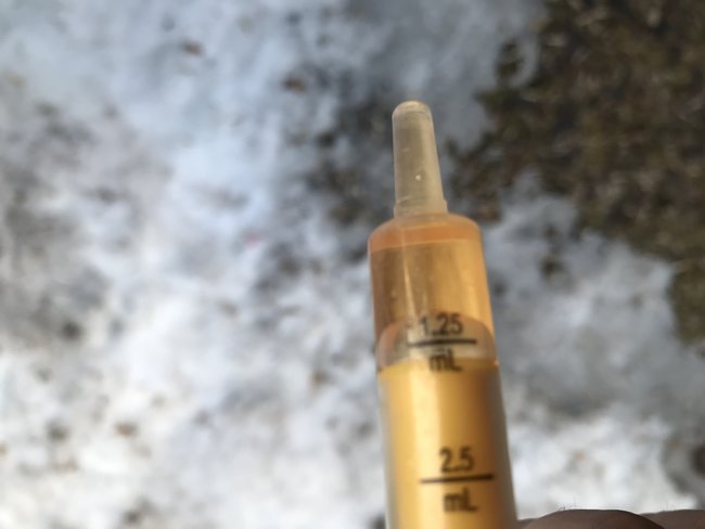

Checked my coolant because you said not to mix them. This is what I sucked out of my radiator cap. Does green coolant turn yellowish over time?
Mar 13, 2020 at 5:01 PM
No it does not. I don't like the looks of that.
