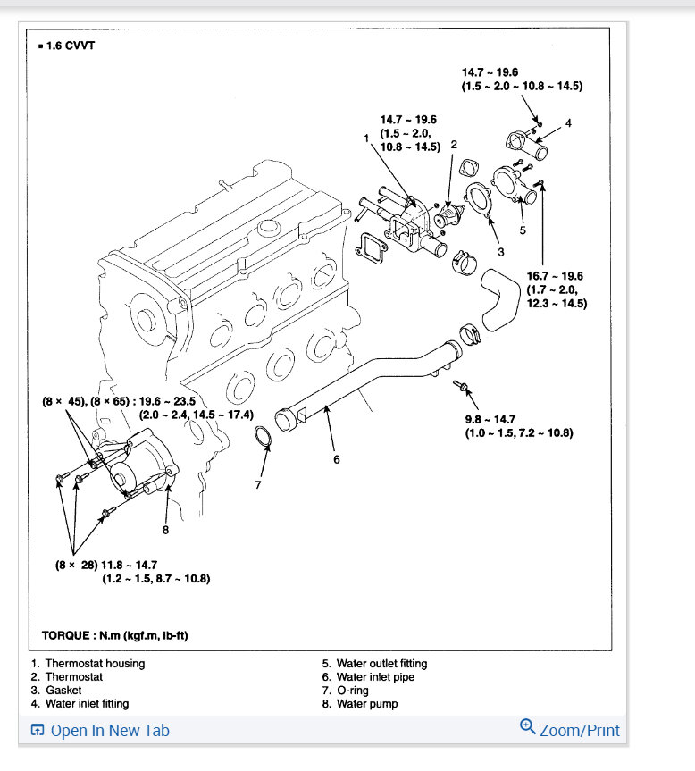

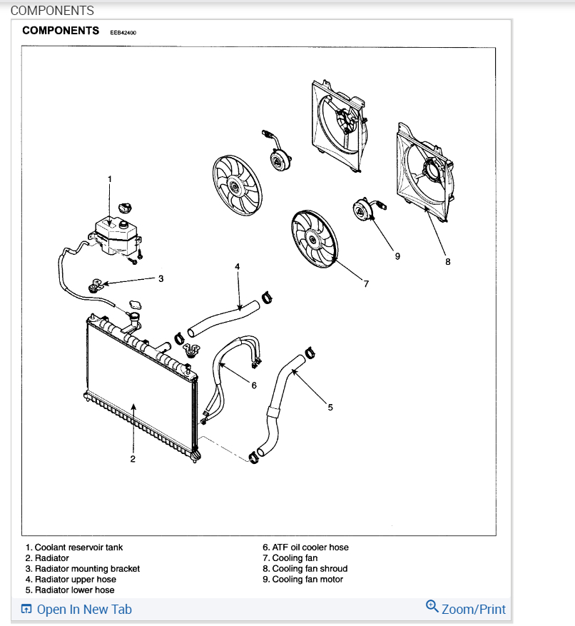

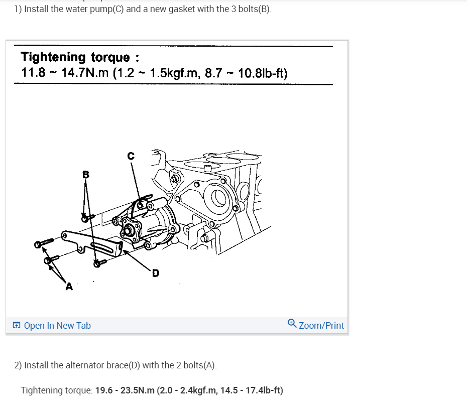

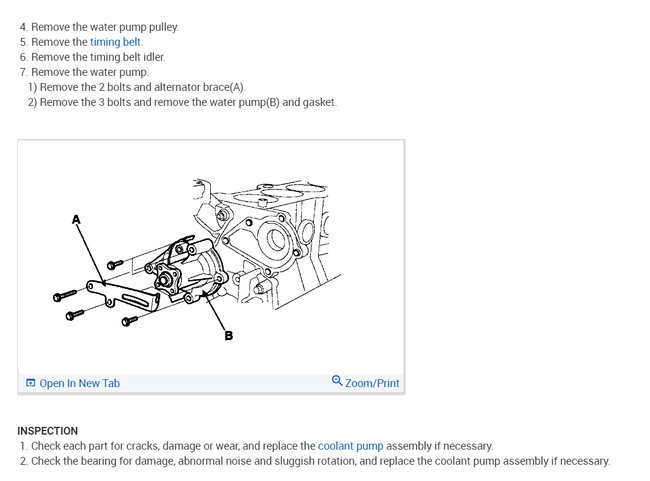

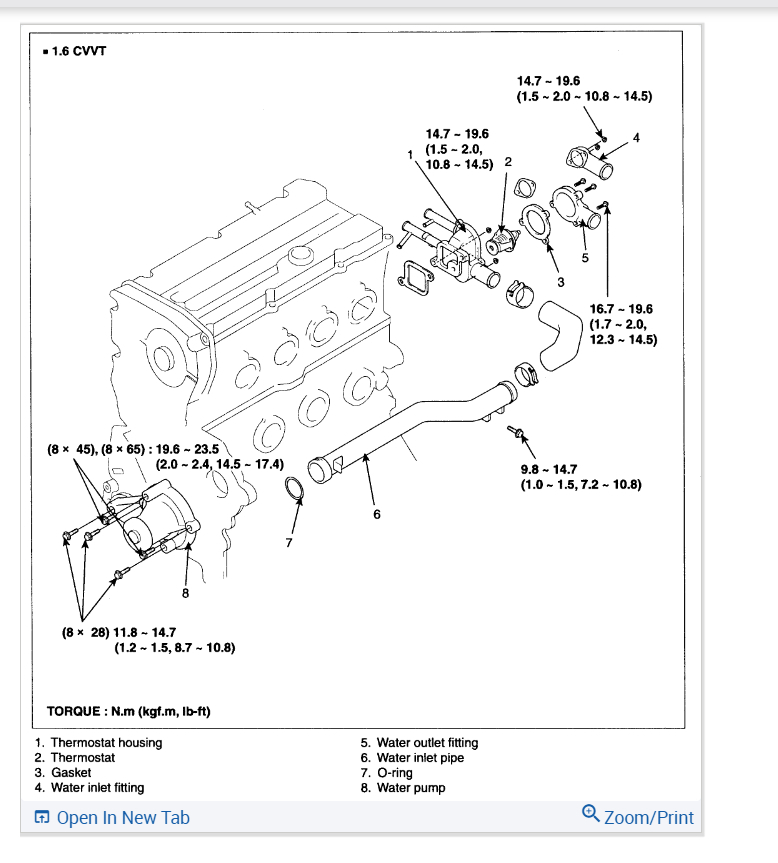

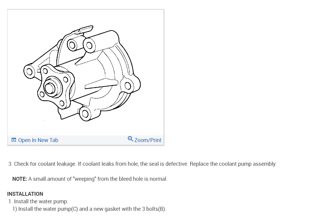

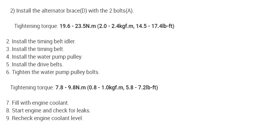

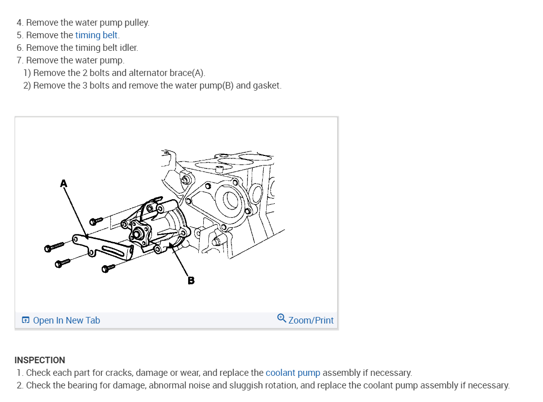

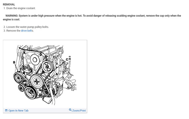

Most of the time it will be a hose, or the water pump needs to be replaced but to be sure the system will need to be pressure tested and the leak traced down. here are two guides to help and I have included how to change the water pump out in case you need it:
https://www.2carpros.com/articles/car-is-leaking-coolant
and
https://www.2carpros.com/articles/radiator-pressure-test
