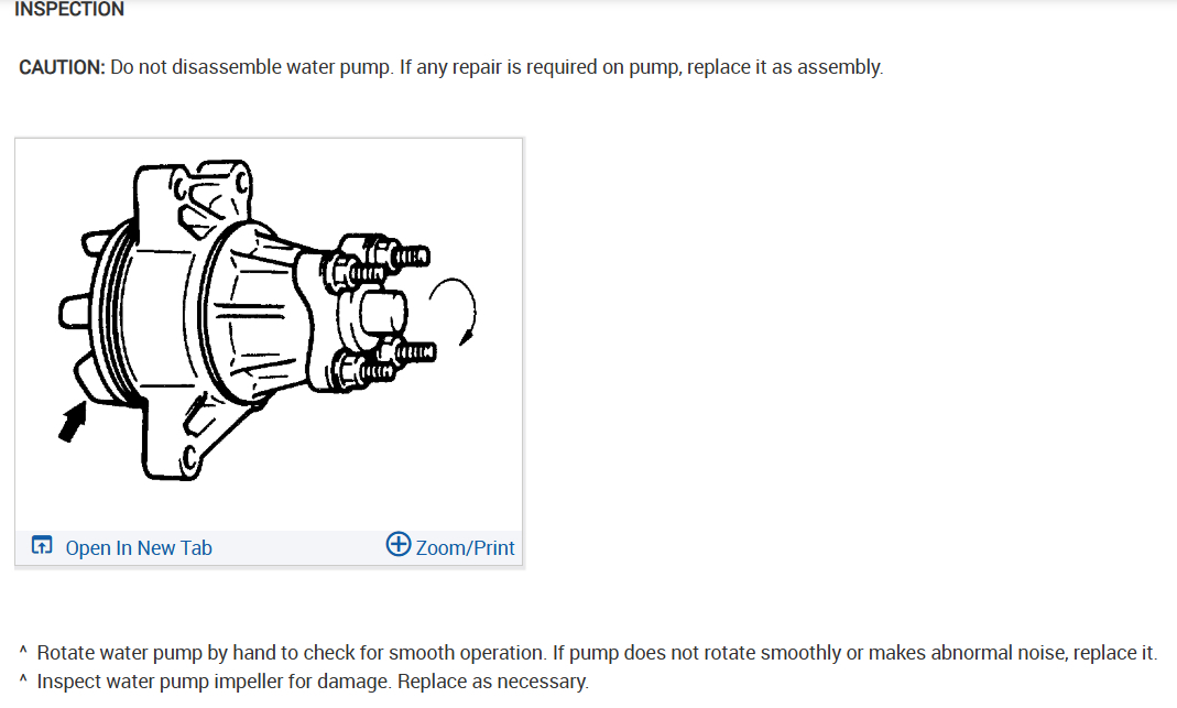

Sure, the weep hole is located in the lower side of the water pump right at the base of the shout where the pulley bolts on. Here is a guide to help show you:
https://www.2carpros.com/articles/car-is-leaking-coolant

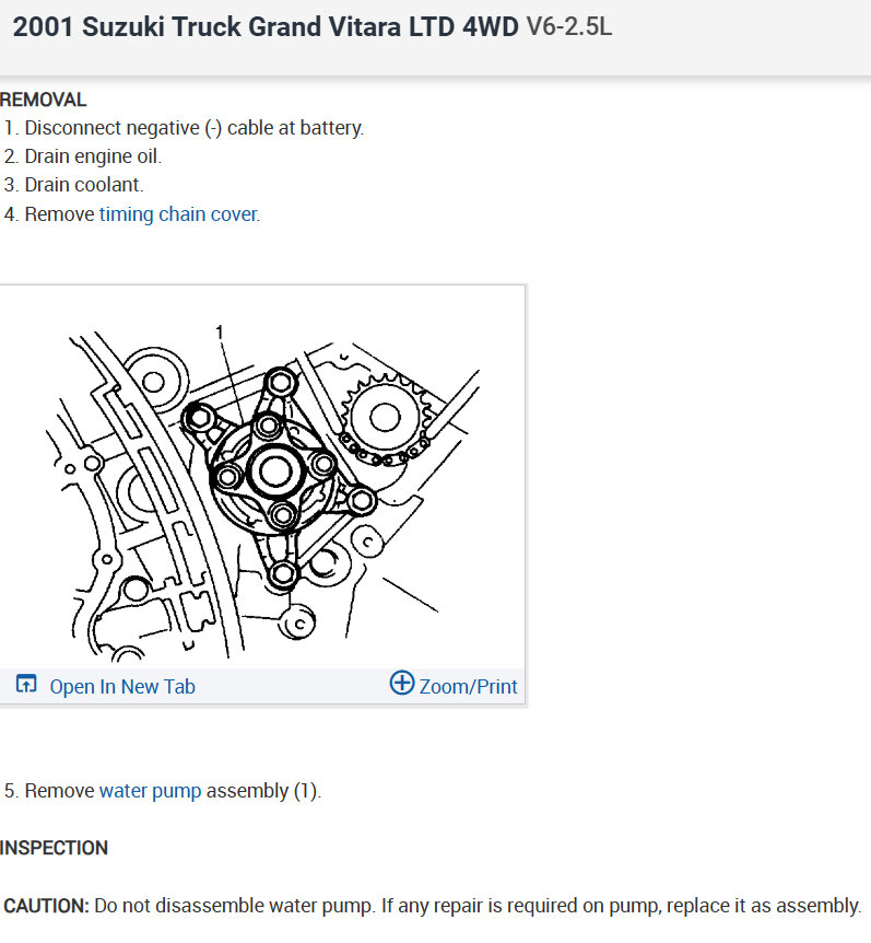

Here is the water pump location so you can check it out and I have included a video that should help as well.
https://www.youtube.com/watch?v=W8kra65m15c&t

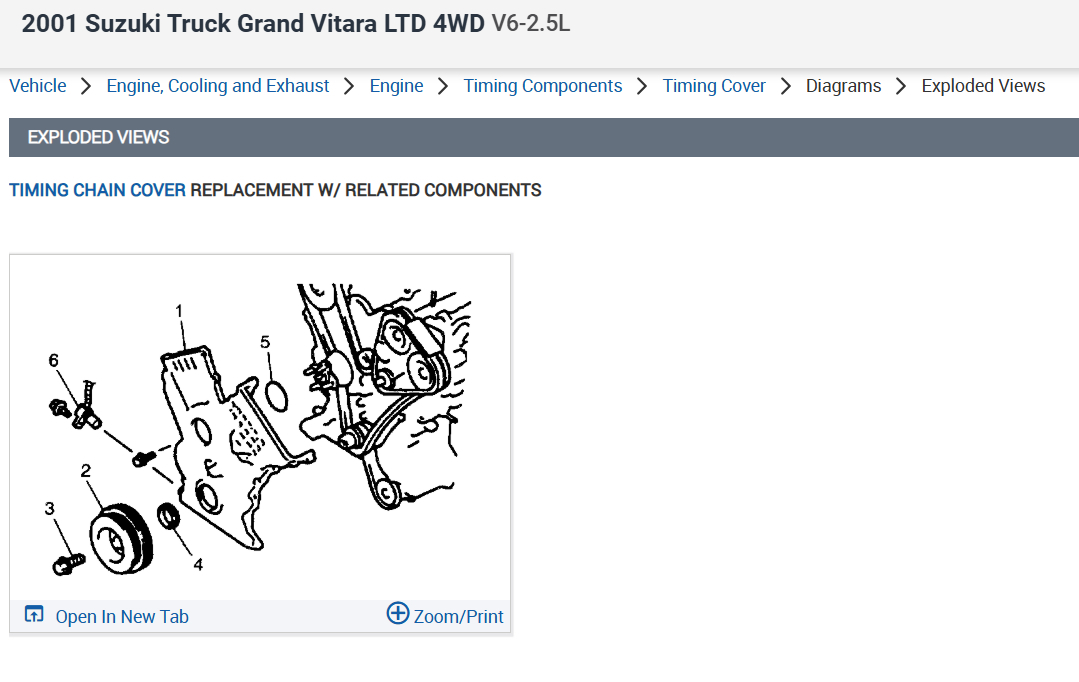

You will need to remove the timing chain cover to get a good look at it. Check out the images (below). Please upload pictures or videos in your response of any problems so we can see what to help you with.
