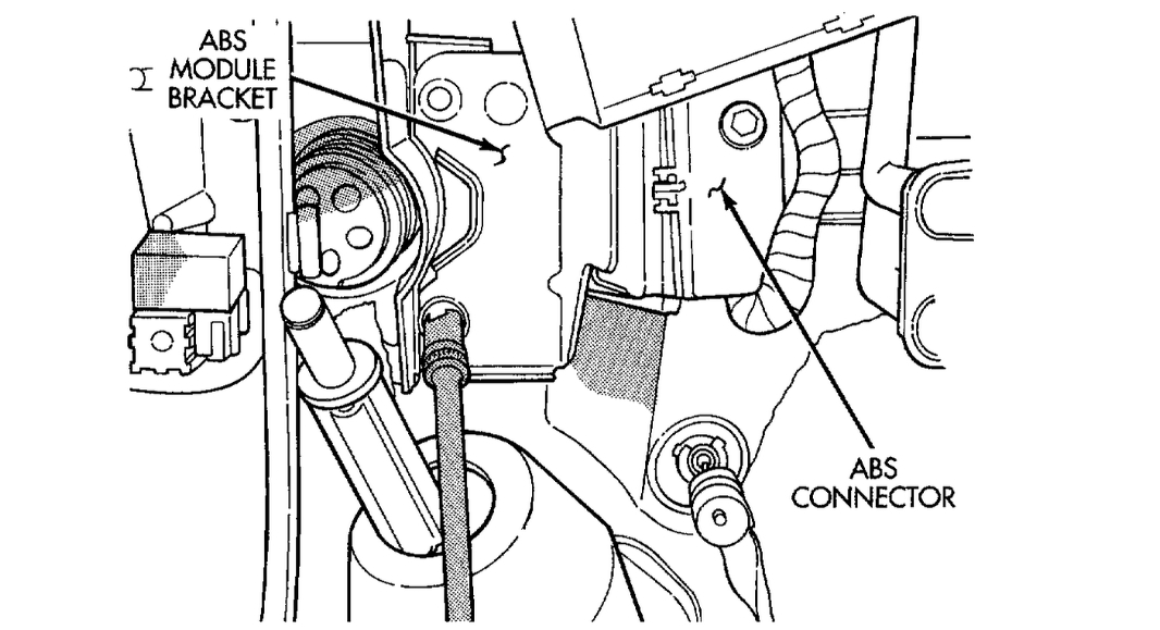

ABS Module
imageZoom/Print
4. Remove ABS module, bracket and wiring.

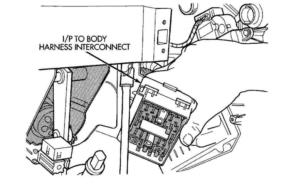

5. Remove I/P to body harness interconnect and bracket.

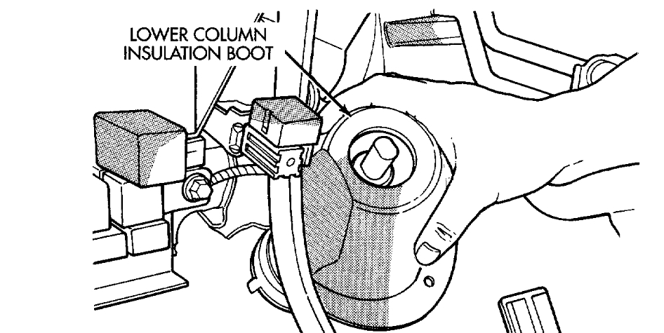

Lower Silencer Boot
imageZoom/Print

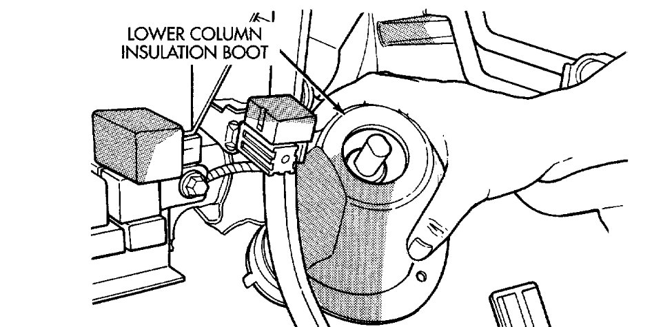

6. Remove lower silencer boot at base of steering shaft.

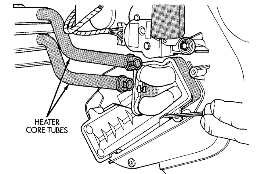

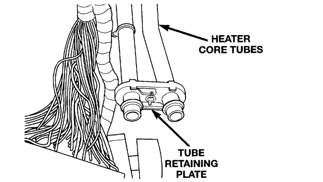

8. Remove heater core cover. Insert a small amount of towels under the heater core tubes. Remove heater core plate and tubes.

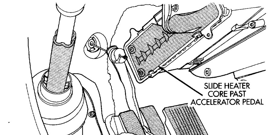

10. Pull up on accelerator pedal and slide heater core past.

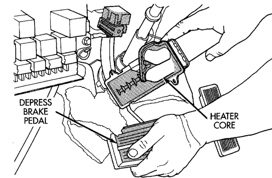

11. Depress brake pedal and remove heater core from HVAC housing.
