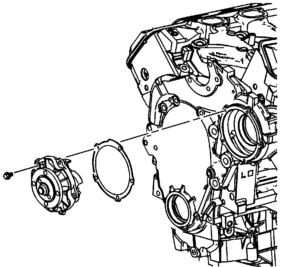

Okay, if you find it is a hose, that is an easy repair. However, if you determine it is the water pump, here are general directions for replacing one:
https://www.2carpros.com/articles/water-pump-replacement
Here are directions specific to your vehicle. The attached pictures correlate with these directions.
__________________

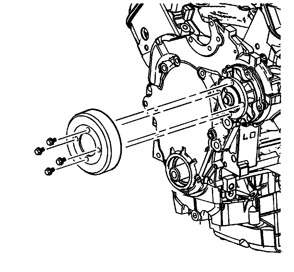

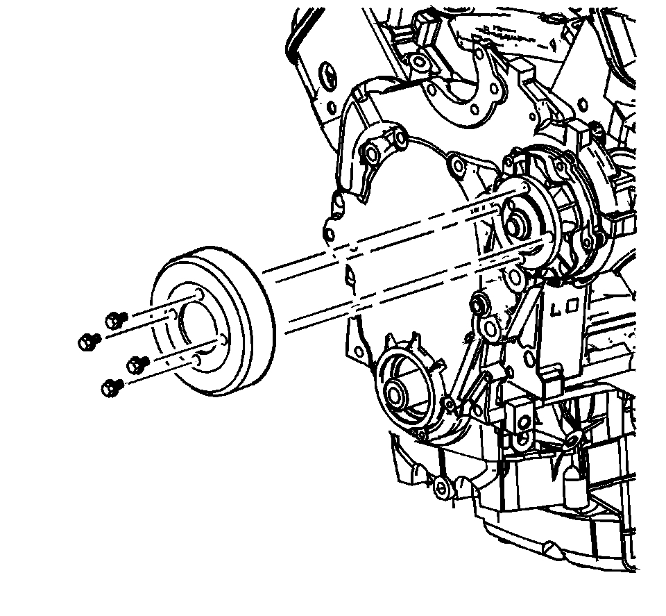

Water Pump Removal
1. Remove the water pump pulley bolts.
2. Remove the water pump pulley.
3. Remove the water pump bolts.
4. Remove the water pump.
5. Remove the water pump gasket.

Water Pump Installation
1. Install the water pump gasket.
2. Install the water pump.
3. Notice: Refer to Fastener Notice in Service Precautions.
Install the water pump bolts.
^ Tighten the water pump bolts to 10 Nm (89 inch lbs.).
4. Install the water pump pulley.
5. Install the water pump pulley bolts.
^ Tighten the water pump pulley bolts to 25 Nm (18 ft. lbs.).
