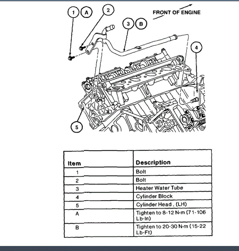

Take a look at the attached picture and let me know where you see it leaking from. Have you determined it is a hose?

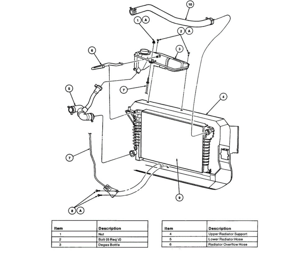

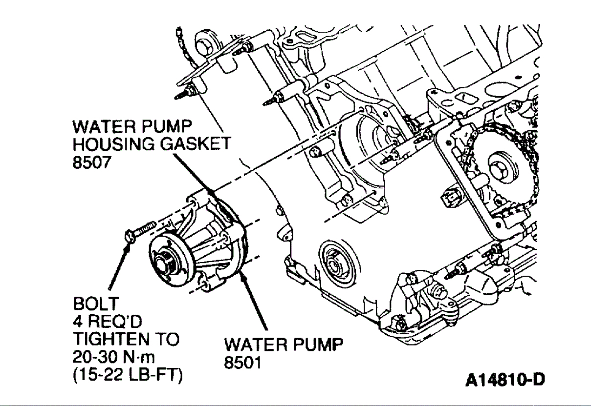

I have hatched pictures below. Take a look through them and see if you recognize where you see the leak. I know there is a steel heater hose that runs under the intake that can rust and leak. It is in picture 3.
