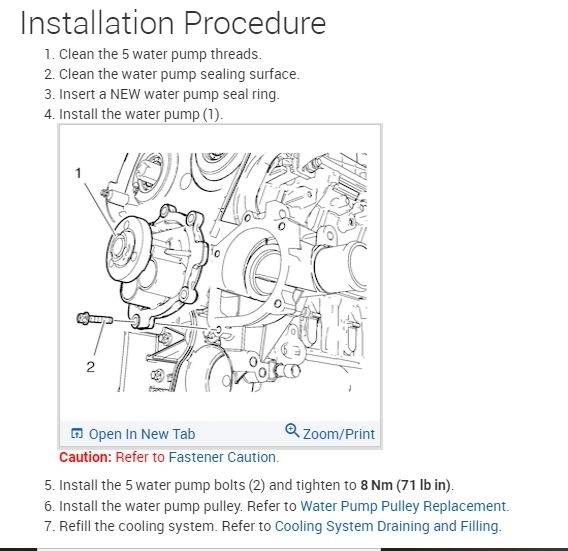

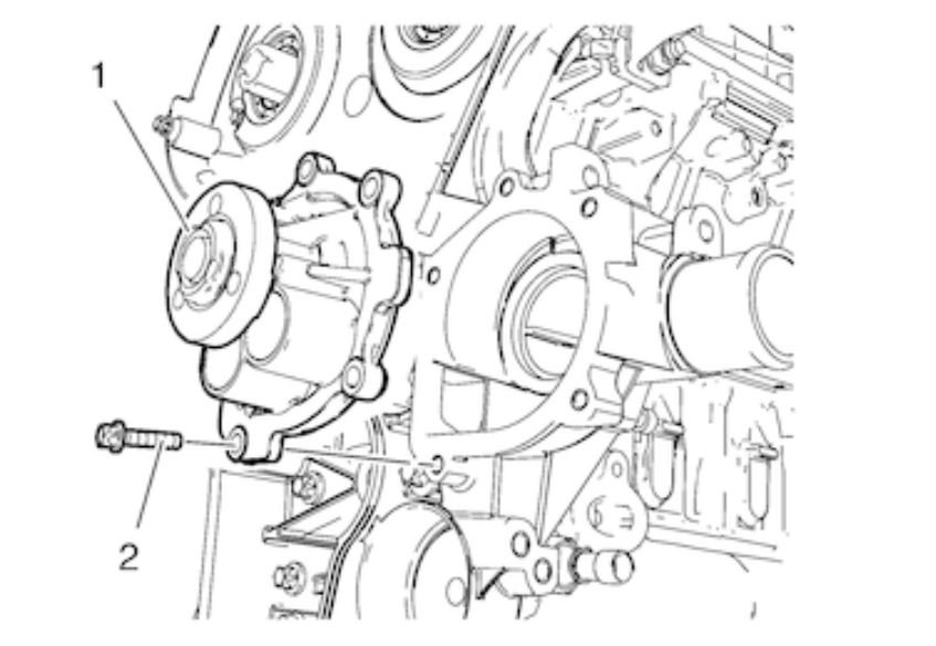

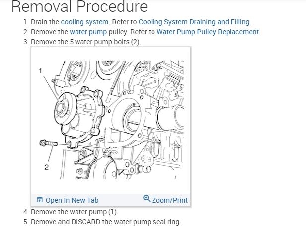

Okay, I attached the procedure for you to replace the water pump below.
https://www.2carpros.com/articles/water-pump-replacement
Let me know if you have any other questions.
