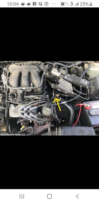

Can you attach a picture of the connector you referred to in the post?

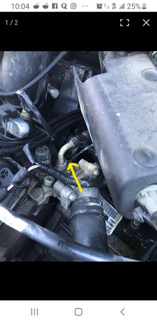

Here they are.
Jul 25, 2019 at 6:30 AM
CERTIFIED EXPERT
52,796 POSTS
That is an elbow for the heater hose off the intake. Is that correct? It looks like it presses into the manifold and has a hose on the other side.
Hard to see from a distance with the picture.
Jul 25, 2019 at 6:53 AM

You are correct it is an elbow, but it is the return/overflow line from the coolant reservoir.
