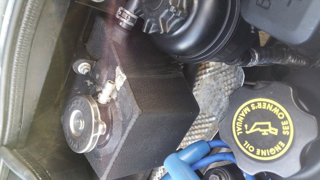

Looking for ideas on what might cause a coolant leak yielding accumulation on top of supercharger and around upper air duct that might not be related to the head gasket. Coolant tank has obvious signs of loss from venting through valve (not the OEM tank.) Upper rad hoses quickly warm to touch, no leaks. Radiator fan shroud is dry. Leak is limited to passenger side, not water pump. Fluid runs straight down onto alternator, steady drip at floor, tank loss approximately half, fluid viscosity good, minimal discoloration likely from residual rust.

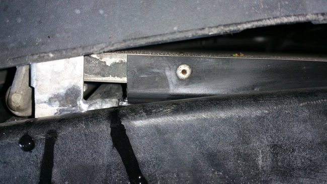

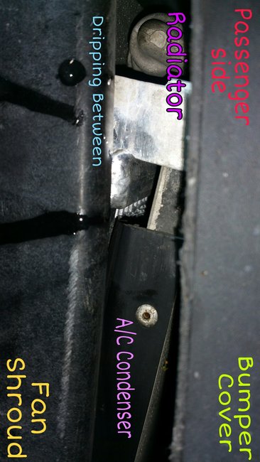

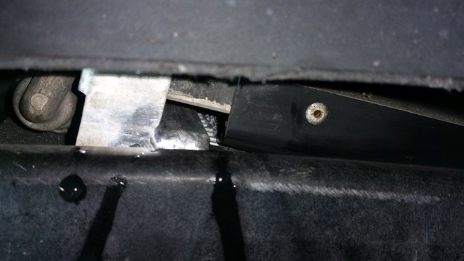

Can you please take pictures or video of the leak? We are going to need to see the leak to help find out where it is coming from.

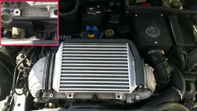

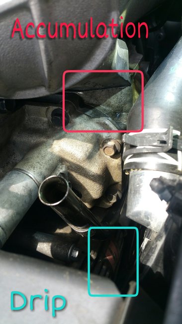

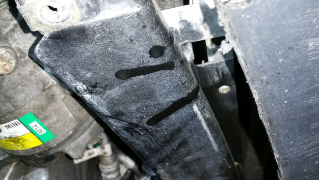

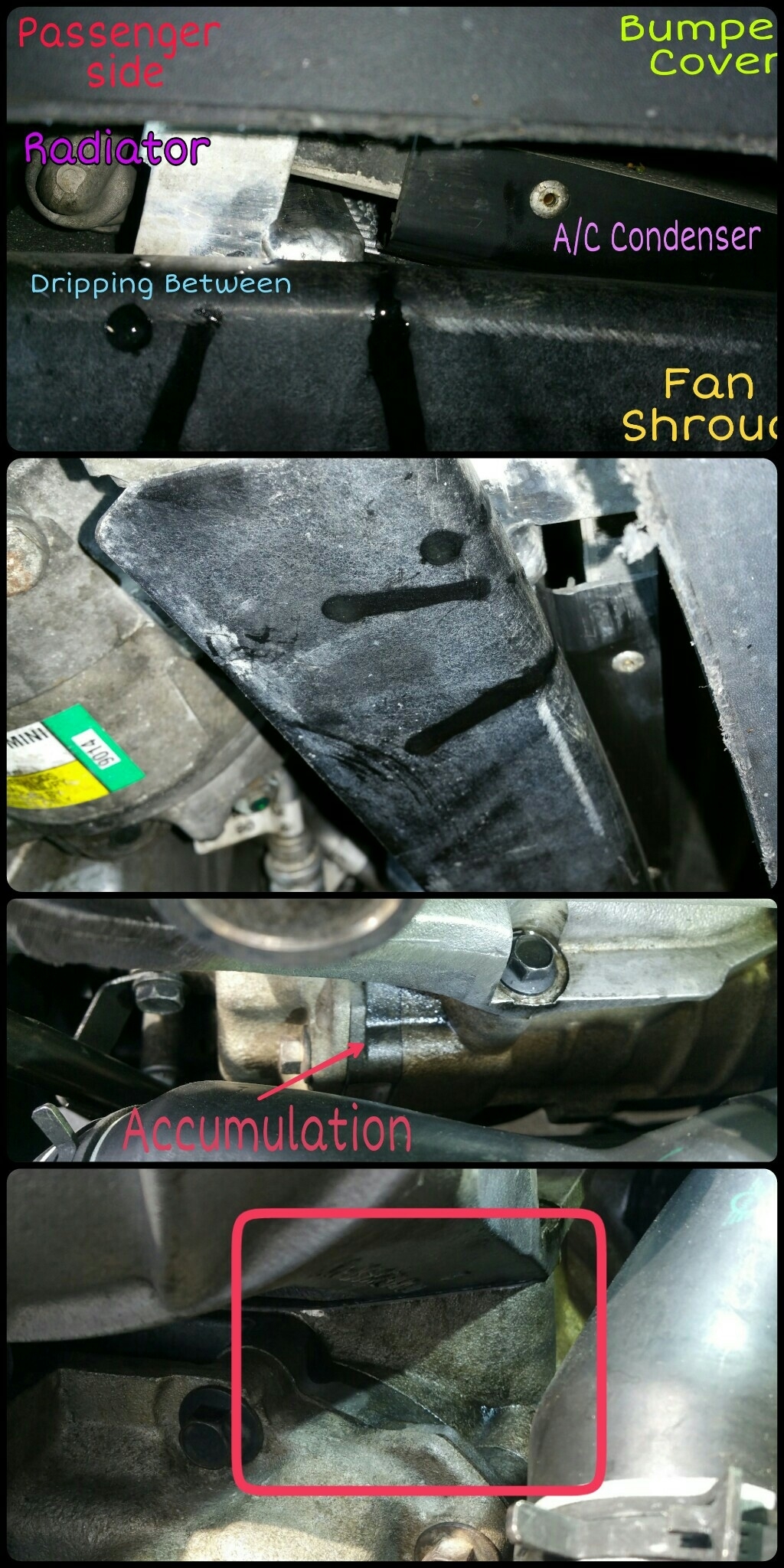

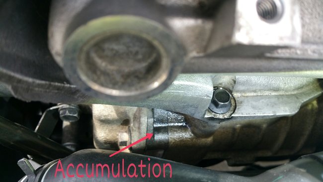

Thanks so much for responding. I appreciate your input. Coolant in the pictures on top of the supercharger is just the residue from after I started cleaning up. Initially it was a puddle spreading around to the side, pooling in front bolts and then dripping down the alternator. That was after driving. Everything else I could see from the top was dry. I have not pressure tested it because the leak is pretty obvious on the ground if I start the car. I was just hoping to diagnose without taking the front end off.

Thanks for the pictures they really help. It looks like you may have two leaks; one from the head gasket and the other from the radiator core.
You are going to need to pressure test is to confirm the issue. You can get a tester from Amazon or the parts store will lend you one.

Yup, radiator core leaking. Crazy because it only has 4,000 miles on it. Thanks for your help guys!
