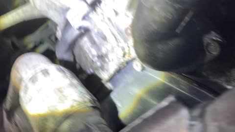

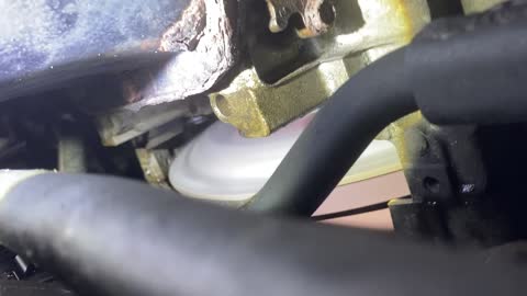

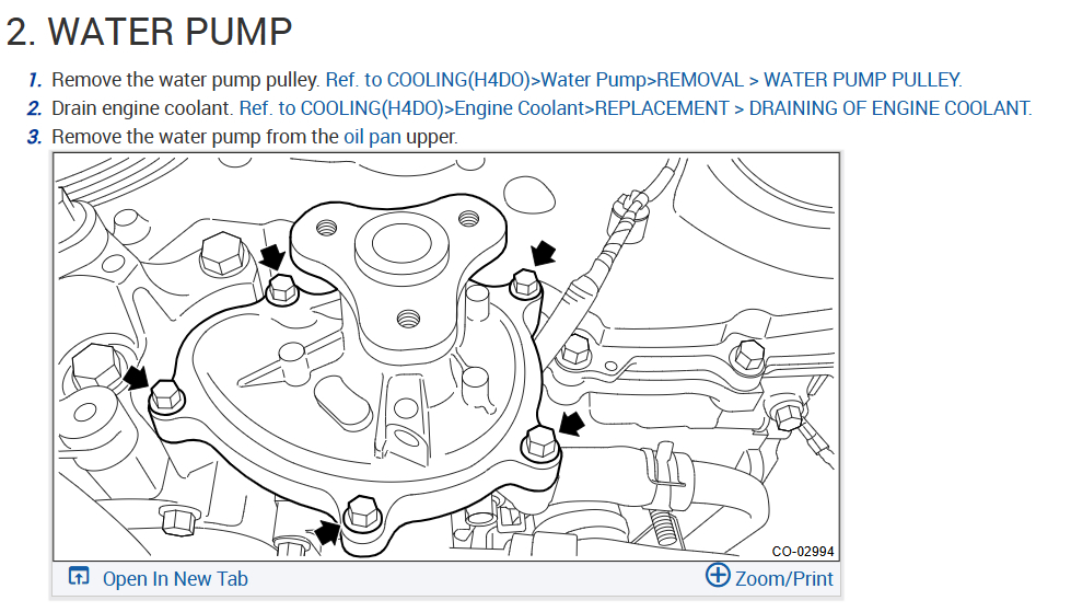

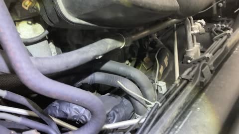

Hmm, yep that is at the rear of the engine. Can you look above the bell housing or on top of the engine with the air cleaner intake boot covers to see if something is leaking down on top of it? With the engine off, use a small mirror on a stick and see if you can tell where it is coming from, I have seen coolant passages that will transfer the coolant to the rear of the engine if the water pump leaks. So, if you see an open port that coolant is coming from, I would say the water pump is leaking. If not, the transaxle will need to come out to tell where the leak is coming from. I will put this out to other experts to see if they have seen this problem before. Thanks for the videos, they help.
