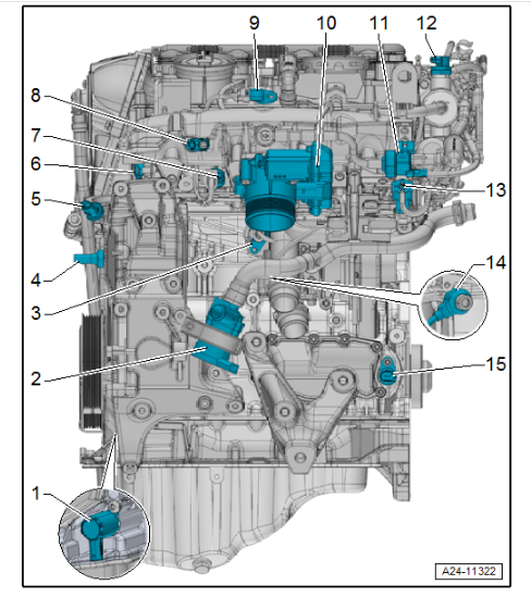

I attached a pic of the coolant sensor below. Take a look and let me know if that is what you are seeing.
Also, if possible, take a couple of pictures of what you are seeing and upload them so I have a better idea of what it could be.
See pics below.

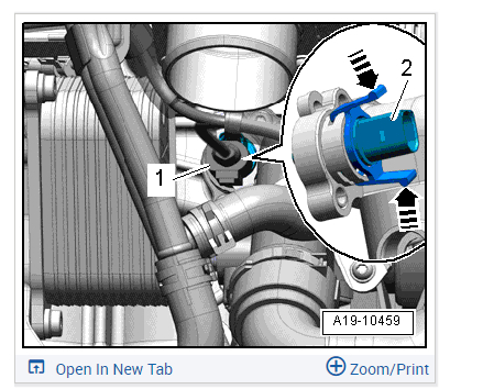

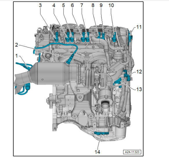

I attached a couple of pictures below. Do you see it in either of the pictures?
If you do, let me know which picture and which number identifies the part.
See pics below.

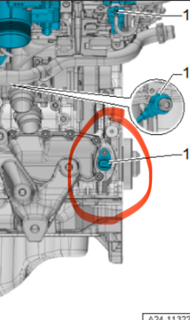

I think it's this one marked.

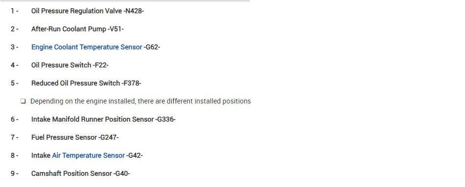

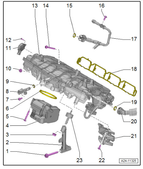

If that is number 15 in pic 2 above, that is the crankshaft position sensor. No coolant is present at that point. Pic 2 is the intake side of the engine. Is the part that far forward? I ask because number 3 in the same picture is the coolant temperature sensor. That would make more sense to me.

No, not the crank sensor for sure. It's located far behind the engine mount and the shape of it is exactly like one in the picture, one of your pictures shows the crank sensor as number one then the sensor am talking about also as #1 when they are different. I know it's not #3 because i know how that sensor looks, and it's located to the left of all the hoses underneath, it has the sensor with a clip. I have seen them before. Second picture shows the crank sensor with a bolt not the same as number 1 underneath it which is a connector and has a bolt.
Aug 16, 2024 at 5:17 AM

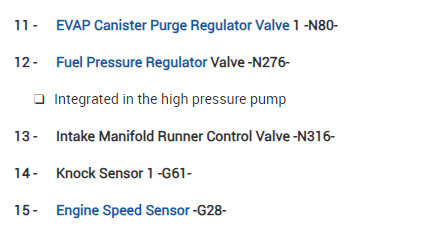

I'm not sure what you are seeing. If you see the correct part in the second pic I attached above, here is a legend of all the parts identified on that pic.
Let me know if this helps.
joe
See pics below.
