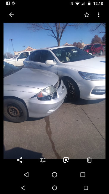

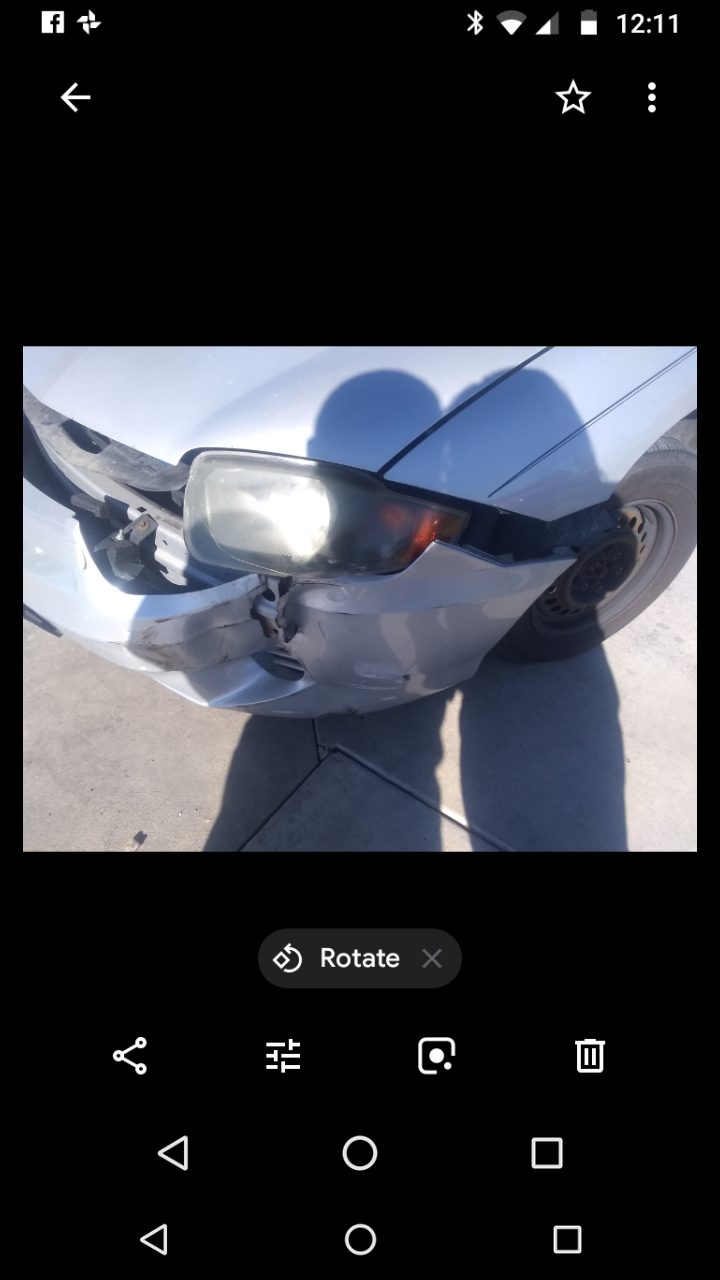

Hi, so a car had hit my driver side bumper and it started leaking antifreeze. I drove it home and it drove fine until I notice it was smoking a little bit. Any idea what it could be? The car accident wasn't bad at all but my bumper did take a hit.

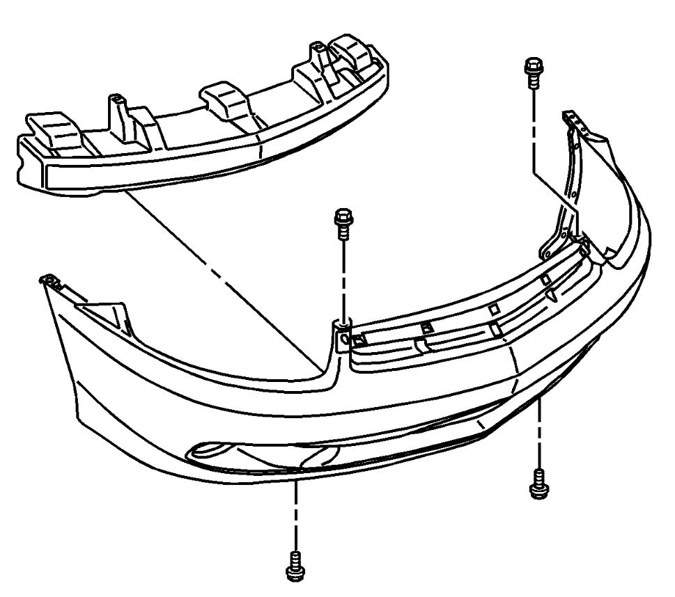

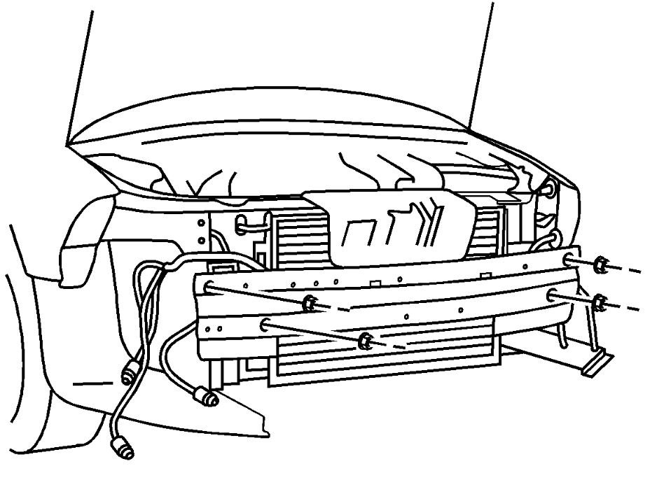

Many vehicles have the front end packed with parts that were not there in prior years. In this case there are a lot of parts behind the bumper area that can get damaged. In your case the AC condenser and radiator are very close to the front and it is very likely that although the outside of the car may look fine, the fascia cover with energy absorber (Styrofoam block) and the impact bar (actual metal bumper) were moved back enough to damage the AC core and radiator. It takes very little impact to do damage on these cars with all the lightweight plastics used. With the leak and steam I would start by looking at the radiator and the hoses, I think you will find one of the plastic tanks on the radiator has cracked and you need a replacement radiator. I would also check the coolant level ASAP because it is very easy to overheat and damage an engine if the coolant runs low, plus the coolant used in your car really hates getting air into it from running low, it will turn into a thick goo like slime. Then you end up replacing many more parts to remove that from the cooling system.

It doesn't look that bad, a replacement bumper cover, energy absorber, headlight (likely broken mounts) straighten some tin and replace the leaking parts. If you hunt around you might even find a fascia in the correct color. If you want to hunt go to www.car-part.com and put in your information and it will show you salvage yards that have the parts. That should give you an idea of the cost. Then you can decide if you want to fix it.
The reason the insurance wants to write it of is because they were not an expensive car to begin with and the wholesale value isn't that high so anything more than a few hundred dollars likely exceeds the threshold of totaled.
