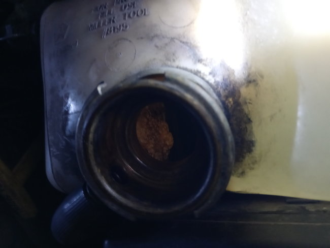

Vehicle at traffic light protruding from under/coolant on the ground extending from front driver side to the next lane. I noticed smoke from hood of car. No overheating report. Some fluid remains in overflow. Car will start. Overflow is melted inside and where the cap goes on is crooked.
Jun 15, 2021 at 11:14 AM
This could be a couple things but I suspect what happened was the engine started to overheat and the coolant started spraying out of the cap as it is not able to stay on tightly.
Here is a guide that will help with causes of overheating:
https://www.2carpros.com/articles/symptoms-of-an-overheating-engine
https://www.2carpros.com/articles/engine-overheating-or-running-hot
This means we need to find why it is overo. It could be just a faulty cap so if the bottle no longer seals the cap then we need to replace it.
If that is replaced and this still overheats then we need to check for a blown head gasket.
Please run through this material and let us know if you have questions. Let us know what you find with this and we can go from there. Thanks

Well, the reservoir was replaced and it was started up no leaks anywhere it ran until almost 1/2 way hot. No fan. Until A/C was turned on. both fans run then but A/C turned off due to high screeching noise. It went for a run and came back with a high temperature no fluid in oil or on ground. ECT on order. I'm hoping the ECM isn't the problem.
Jun 21, 2021 at 2:52 PM
This does sound like a temperature sensor issue but you can test it by putting it in a pot of water and monitor the resistance across the terminals.

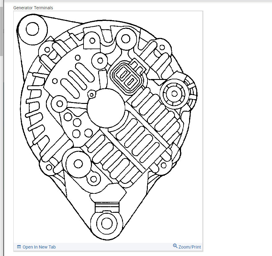

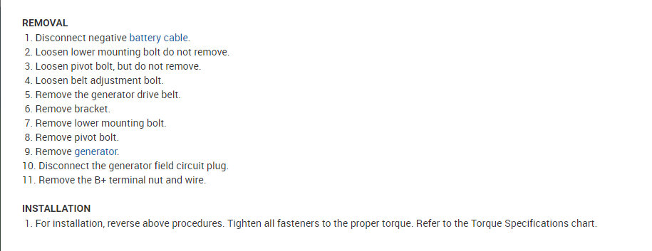

I am not able to assist. Nephew thought I was doing it my way, lol. so he got mad and is doing it his way. He can't get the alternator back on and it's been 3 days he's been trying. It's his car he can slam all the doors he wants. Won't get the alternator back on.
Jun 24, 2021 at 12:01 PM
Totally understand. Unfortunately the manual is not as detailed as desired.
The best thing to do is get get one of the bolts started and then pry it up and into place and get the other started.
If he still can't get it we are going to need to get a new post started as we need to keep each to one topic so that other s that are struggling with this can find it.
Thanks
