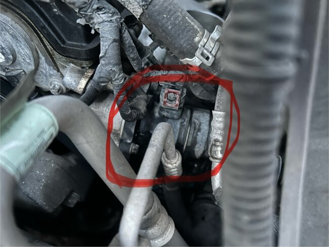

Hey Ken, I pulled off the front clip and I was able to get in there better and find out where the coolant leak is. I have attached a photo. It is this black piece that cracked. What is this piece that I need to replace?
Thank you very much for your help.

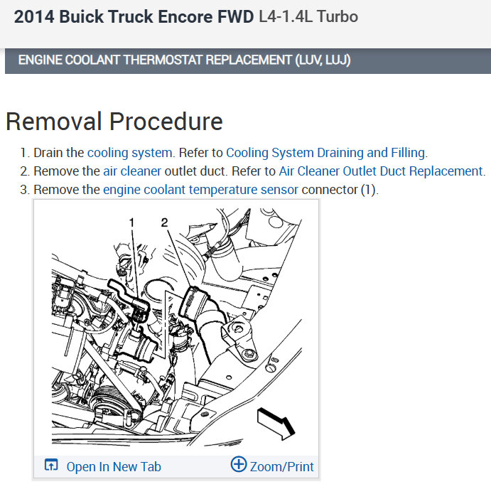

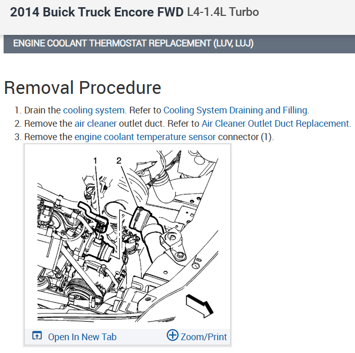

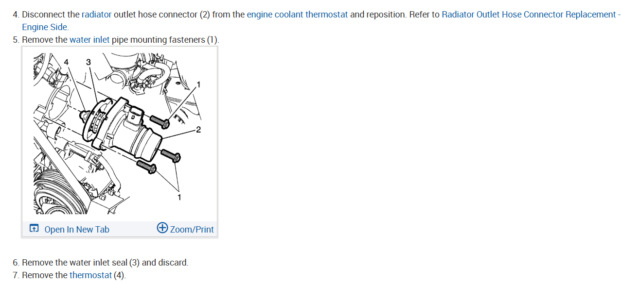

This looks like the thermostat housing, here is how to change the part out which will fix the problem. Don't over tighten the mounting bolts.
80-inch pounds to tighten the bolts.
