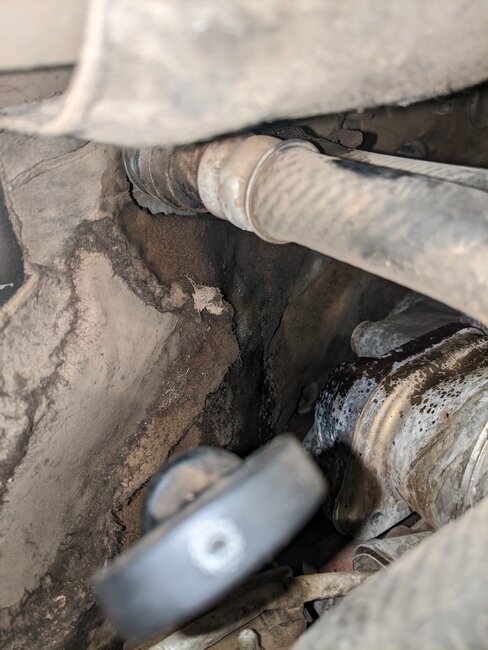

I've had a small coolant leak going on, now it seems to be getting worse. I've noticed that when I use the heater it seems to leak faster, and I wouldn't have heat. I'm thinking it's the line in or out of the heater core, but I'm not sure because I can't see anything. I am seeing coolant pool and drip from the oil filter housing which I have a picture of. Any ideas or diagrams that would help?

I didn't see the picture did you upload it? We should pressure test the system and then get under the tuck with a flashlight, and then look around on top of the engine and hoses.

I found the leak! I ordered the pressure tester and sure enough, one of the heater core hoses. The one behind in the picture. Thanks guys!

Thanks for the image. Glad you could get it fixed, thanks for letting us know. Please use 2CarPros anytime we are here to help.

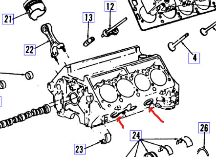

Hi, so I came back to this thread because I have a coolant leak again. I've pressure tested the coolant system and the leak is coming from the back of engine on the driver's side. I've been told it's a cracked freeze plug, would you have a diagram that shows where the freeze plug is for my engine?

I would use a small mirror on a stick and check the back of the intake manifold as well. It does not show us that information, but I do believe you have freeze plugs at the rear of the engine.
