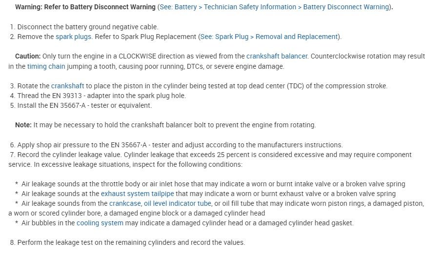

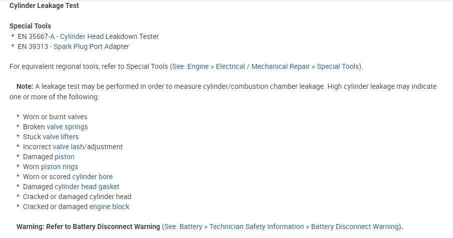

The coolant in the oil could be from a failed head gasket from overheating. I would have a leak down test performed to verify.
https://www.2carpros.com/articles/coolantantifreeze-in-the-engine-oil

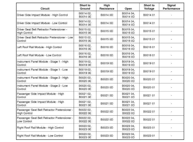

As far as the airbag light, there is a fault code stored and I need that code to narrow the area of failure. The ESC also has a fault code stored as well.
The coolant in the oil and the rough running are the ones you need to address right away to prevent further damage to the motor.
