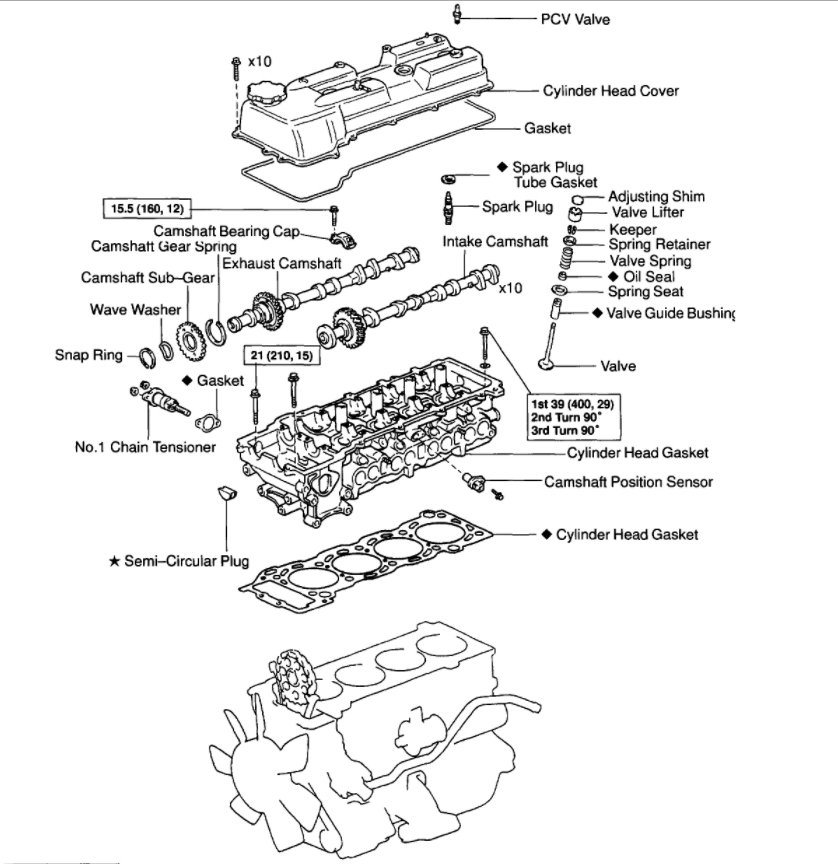

I first noticed white exhaust two weeks after I had all my seals replaced on my oil pan water pump and head gaskets. At that point I checked my oil cap and noticed a white film on my cap. I know I have coolant in my oil. Could it be the seals or is it a head gasket?
