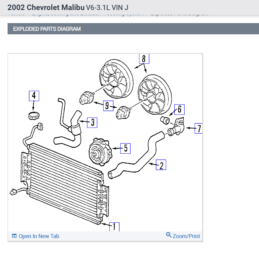

This is going to sound dumb but how many coolant hoses exactly are there on my car? I'm counting the two from the heater, upper and lower, two smaller hoses from the reservoir and 1 bigger from the reservoir. There have to be a few more so where are they?
Feb 1, 2023 at 2:14 PM

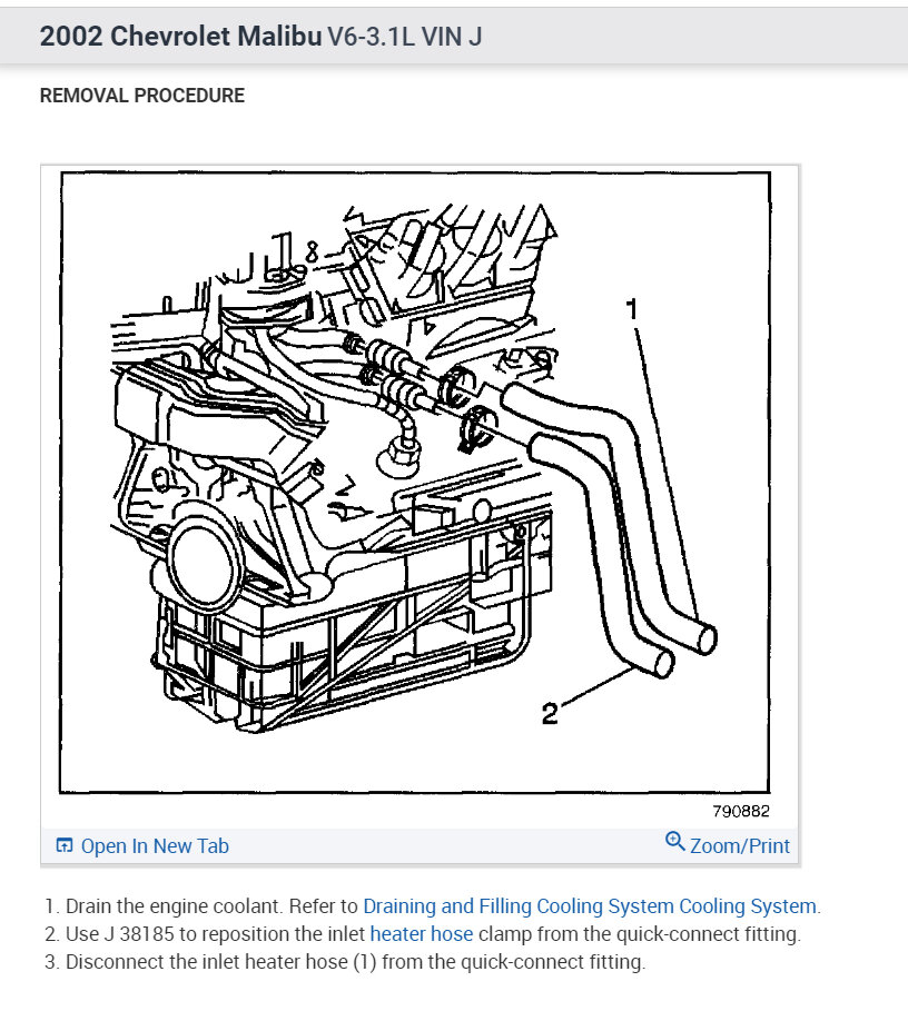

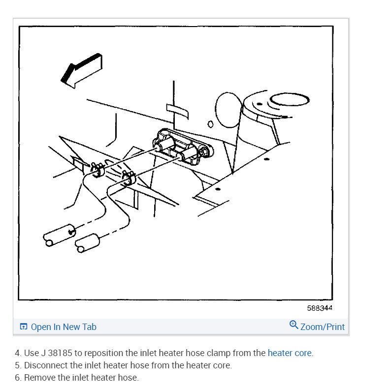

Okay, so there are 2 radiator hoses and 2 heater hoses here are diagrams of the hose and their location in the images below. Please let us know if you need anything else.
