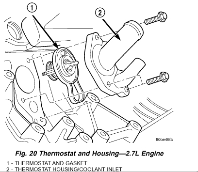

Additionally, as preventative maintenance, I would suggest replacing the thermostat. Here are the directions for that and should be done at the same time you flush the system since the coolant will already be drained. Picture 1 is the thermostat and housing.

Disconnect hoses at thermostat housing.
Remove thermostat housing bolts.
Remove thermostat and housing.

NOTE: Install thermostat with the bleed valve located at the 12 o'clock position.
Install thermostat and gasket into the thermostat housing.
Fig. 20 Thermostat and Housing - 2.7L
Install thermostat and housing to cylinder block. Tighten attaching bolts to 12 Nm (105 in. lbs.) .

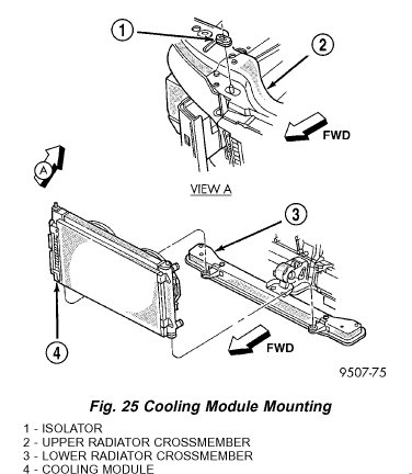

Fig. 25 Cooling Module Mounting
Remove upper radiator crossmember.
CAUTION: Plastic tanks, while stronger than brass are subject to damage by impact, such as wrenches.
Disconnect the radiator fan electrical connector.
Remove radiator fan.

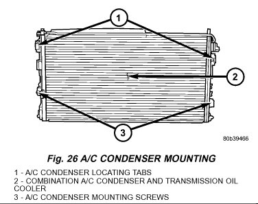

CAUTION: Avoid bending the condenser inlet tube. Care should be taken not to damage radiator or condenser cooling fins.
Fig. 26 A/C Condenser Mounting
Remove the air conditioning condenser attaching screws located at the front of the radiator. Disengage AC condenser from radiator. It is not necessary to discharge the air conditioning system to remove radiator.
