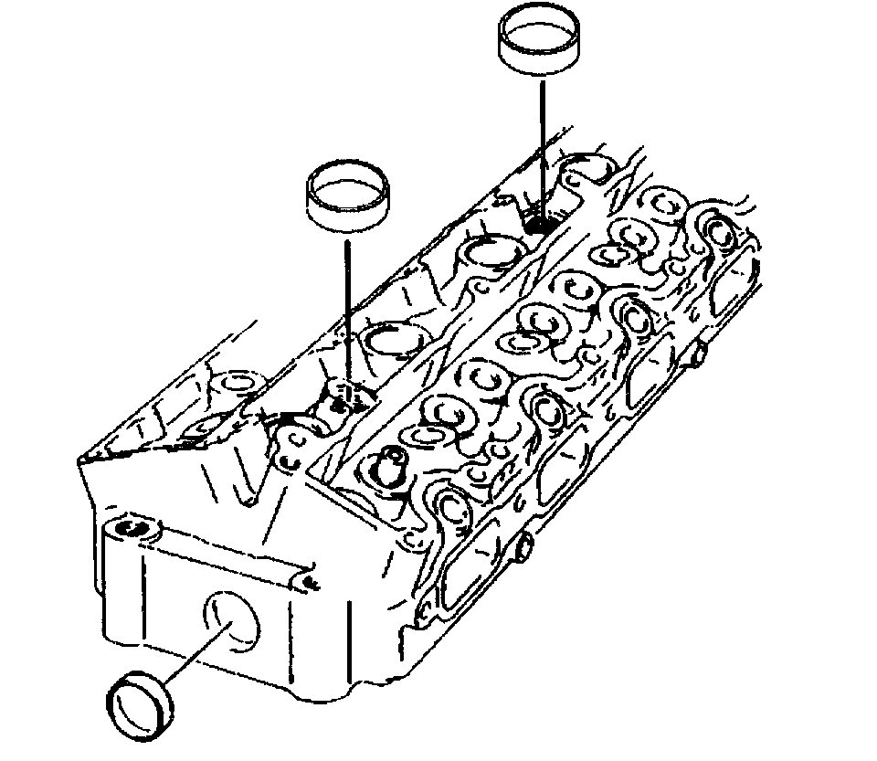

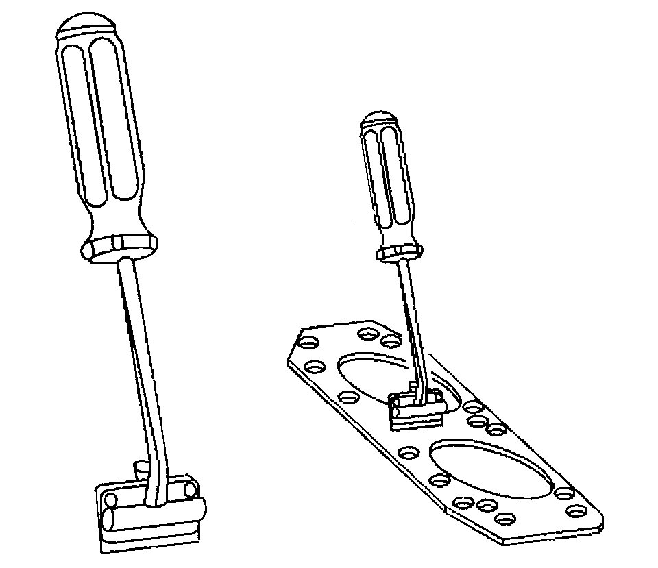

Pic 1
1. Remove the cylinder head to the block bolts. Follow the reverse of the tightening sequence.
2. Remove the cylinder head.
3. Remove the cylinder head gasket.
Notice: Engine damage may result if an abrasive paper, pad, or motorized wire brush is used to clean any engine gasket surfaces.

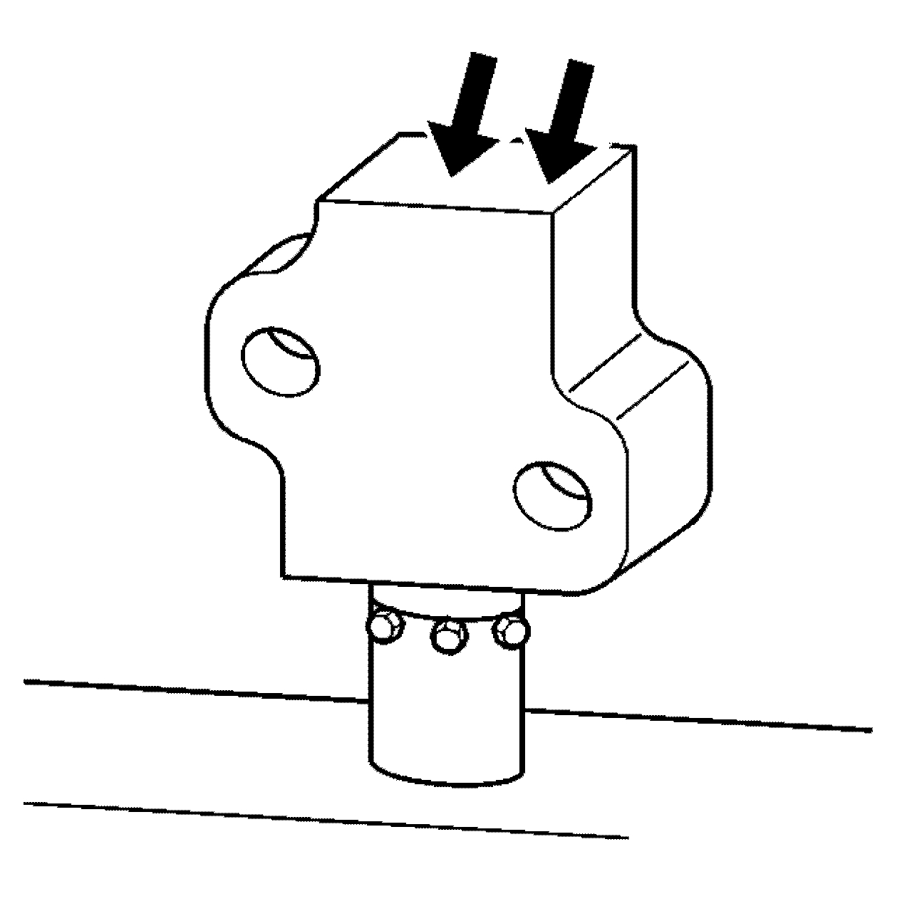

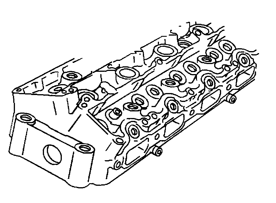

pic 2
4. Clean all of the gasket surfaces.
5. Use the following procedures when cleaning the cylinder head and cylinder block surfaces:
Important: Be careful not to gouge or scratch the gasket surfaces. Do not gouge or scrape the combustion chamber surfaces. The feel of the gasket surface is important, not the appearance. There will be indentations from the gasket left in the cylinder head after all to the gasket material is removed. These small indentations will be filled in by the new gasket.
^ Use a razor blade gasket scraper to clean the cylinder head and cylinder block gasket surfaces.
^ Use a razor blade gasket scraper to clean the cylinder head and cylinder block gasket surfaces. Do not scratch or gouge any surface.
Important: Do not use any other method or technique to clean these gasket surfaces.

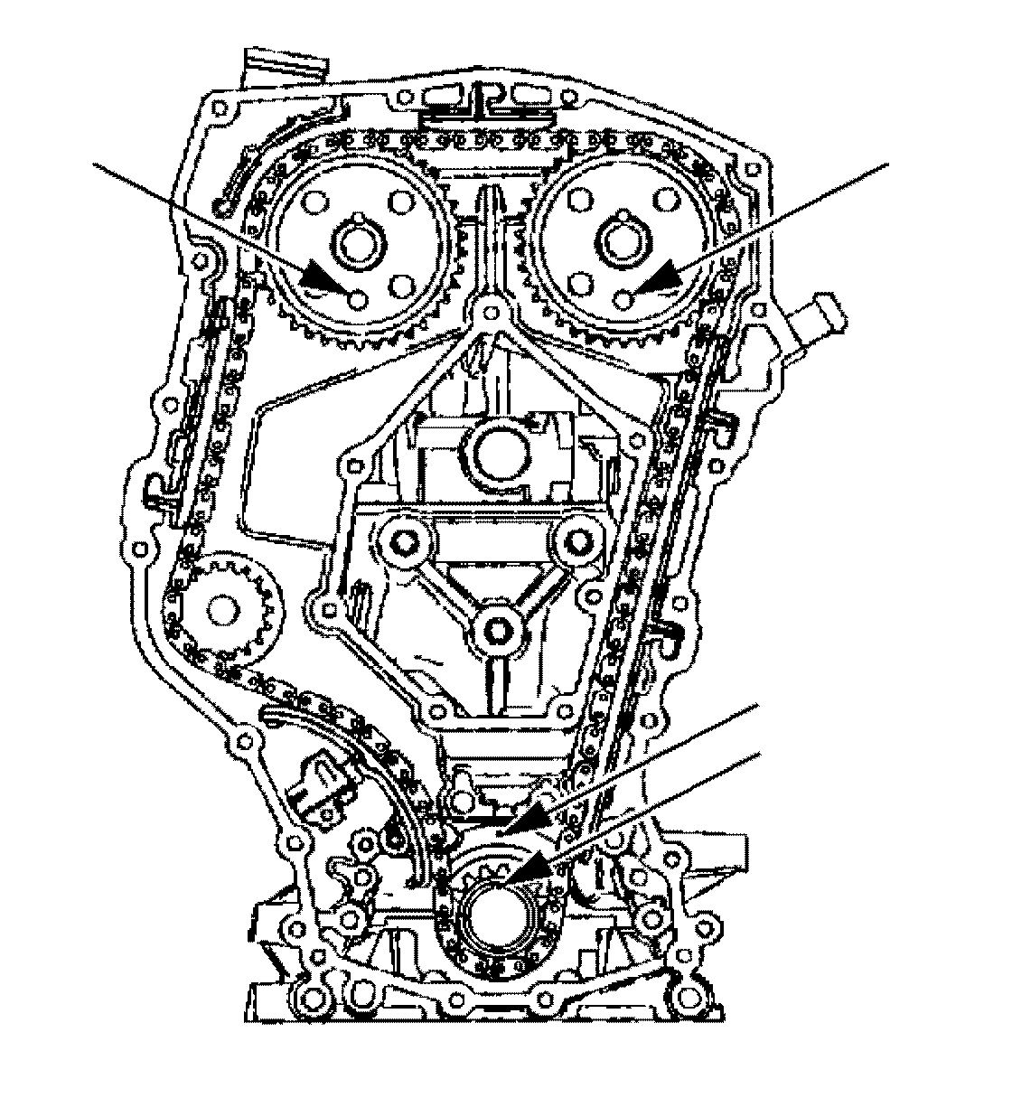

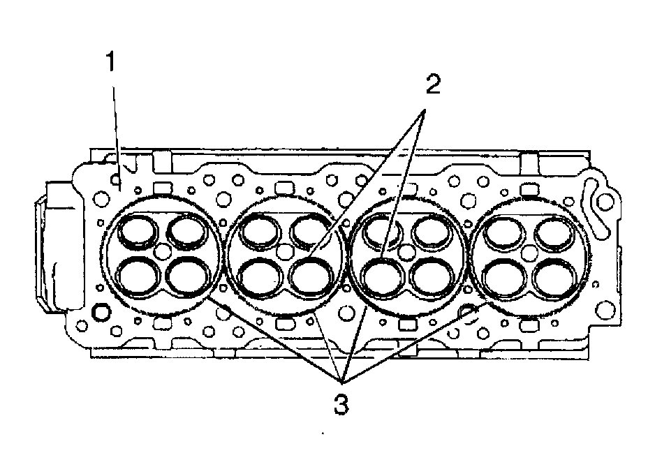

pic 3
1. Clean the valves of carbon, oil, and varnish. Carbon can be removed with a wire brush. Varnish can be removed by soaking the valves in Parts Immersion Solvent GM P/N 12345368 or an equivalent.

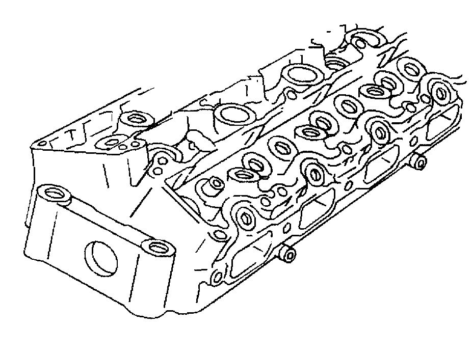

2. Inspect the cylinder head gasket and mating surfaces for leaks, corrosion and blow-by. If the gasket has failed, use the following faults to determine the cause:
^ Improper installation
^ Loose or warped cylinder head
^ Missing, off location or not fully seated dowel pins
^ Corrosion in the seal area around the coolant passages
^ Chips or debris in the cylinder head bolt holes
^ Bolt holes in the cylinder block not drilled or tapped deep enough
^ Other

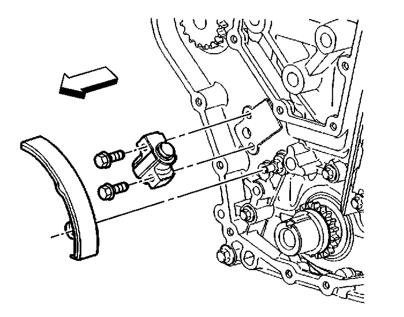

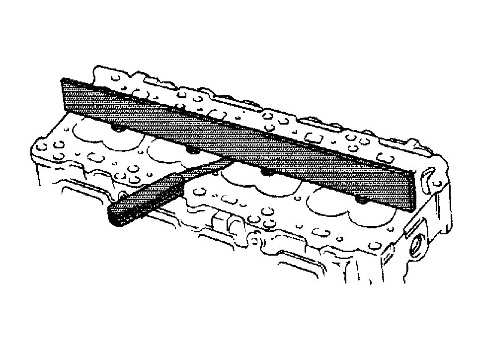

pic 4
3. Inspect the cylinder head gasket surface.
^ The cylinder head may be reused if corrosion is found only outside a 4 mm (0.375 inch) band around each combustion chamber (1).
^ Replace the cylinder head if the area between the valve seats is cracked (2).
^ Replace the cylinder head if corrosion has been found inside a 4 mm (0.375 inch) band around each combustion chamber (3).

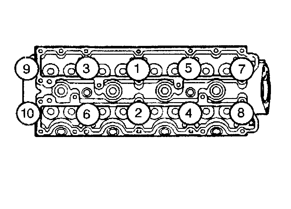

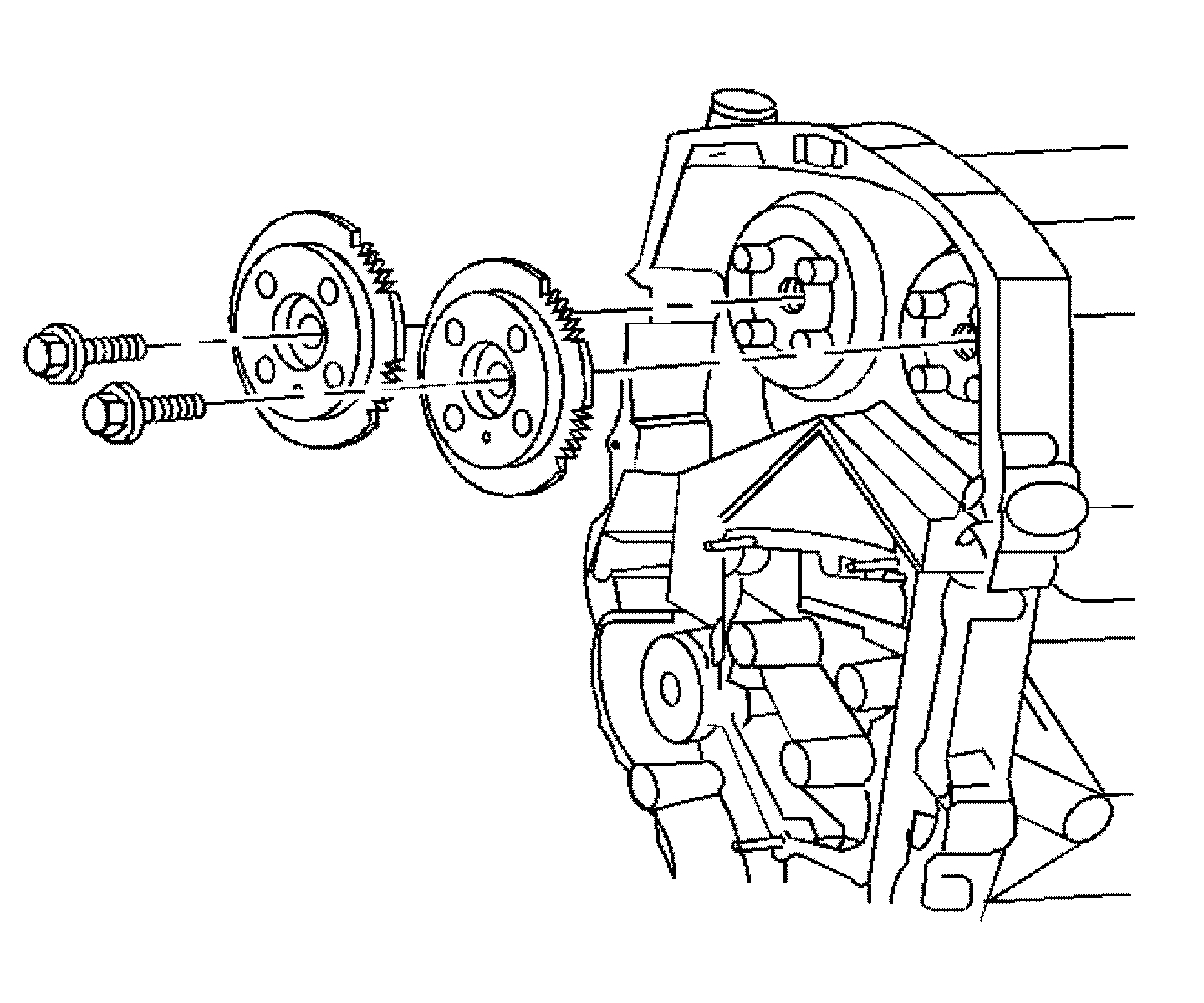

pic 5
12. Inspect the cylinder head deck, the intake, and exhaust manifold mating surfaces for flatness. These surfaces may be reconditioned by parallel grinding.
13. Use the following steps to determine the amount of reconditioning needed:
^ If the warpage is less than 0.076 mm (0.003 inch), reuse the cylinder head, but do not resurface.
^ If the warpage is between 0.076 mm (0.003 inch) and 0.25 mm (0.010 inch), resurface the cylinder head before reusing.
^ If the warpage is over 0.25 mm (0.010 inch), discard the cylinder head.

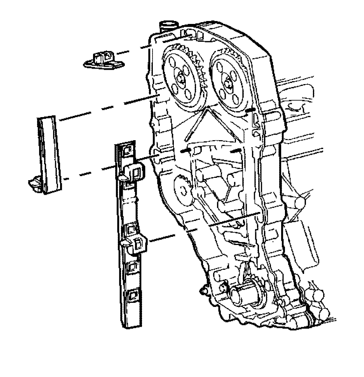

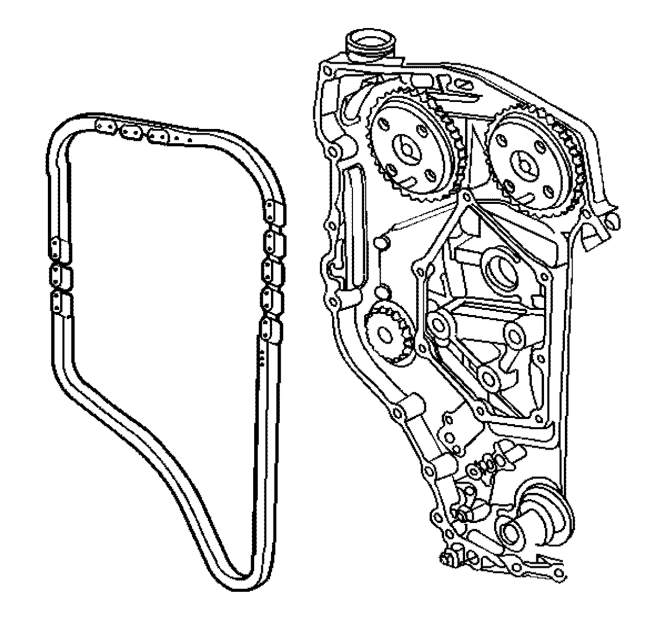

pic 6
1. Install the cylinder head gasket to the block.
Important: Do not use any sealing material.
2. Install the cylinder head.
3. Lightly apply clean engine oil to the threads and the bottom side of the flange of the head bolt and allow the oil to drain before installing.
Notice: Refer to Fastener Notice in Service Precautions.

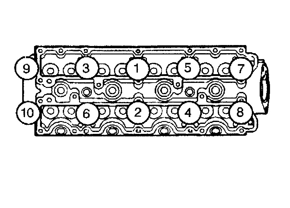

4. Install and tighten the cylinder head bolts in sequence.
^ Tighten bolts 1-8 to 65 Nm (40 ft. lbs.).
^ Tighten bolts 9-10 to 40 Nm (30 ft. lbs.).
^ Then turn all the bolts an additional 90 degrees in sequence, using the J 36660-A.

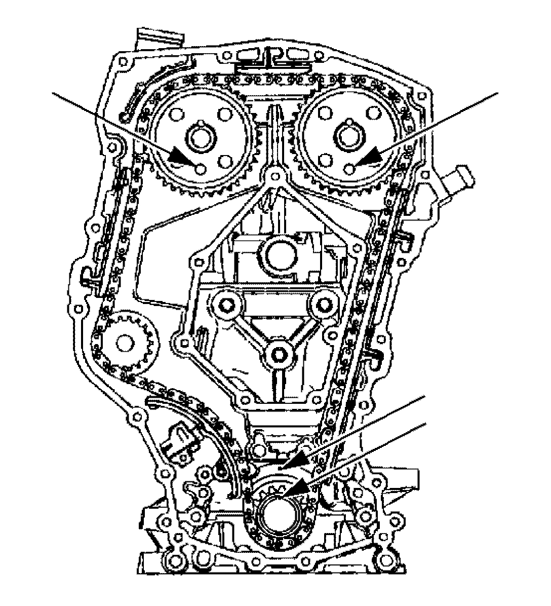

Here are the directions (which will be needed if the head needs removed) for timing chain removal and replacement. With the mileage on the vehicle, I would recommend replacing the chain, sprockets and tensioner.
_____________________________
2000 Oldsmobile Alero L4-144 2.4L DOHC VIN T SFI
Timing Chain, Sprocket, and Tensioner Replacement
TIMING CHAIN, SPROCKET, AND TENSIONER REPLACEMENT
CAMSHAFT TIMING CHAIN, SPROCKET, AND TENSIONER REPLACEMENT
Tools Required
- J36008-A Camshaft Sprocket Alignment Pins
- J39579 Camshaft Sprocket Wrench
Removal Procedure
Caution: Unless directed otherwise, the ignition and start switch must be in the OFF or LOCK position, and all electrical loads must be OFF before servicing any electrical component. Disconnect the negative battery cable to prevent an electrical spark should a tool or equipment come in contact with an exposed electrical terminal. Failure to follow these precautions may result in personal injury and/or damage to the vehicle or its components.
Notice: The timing chain on the LD9 (VIN T) Twin Cam Engine is not to be replaced with the timing chain from any other model year. The timing sprockets are different on the Twin Cam engine and the shape of the links matches the sprockets. Engine damage may result if the wrong timing chain is used. The timing chain and the crankshaft sprocket must be marked so that they are reinstalled in the same side facing out at the time of reassembly.
1. Disconnect the negative battery cable.
2. Remove the engine front cover. See: Timing Cover > Procedures > Engine Front Cover Replacement
3. Rotate the crankshaft clockwise (as viewed from the front of the engine, normal rotation) until the camshaft sprocket timing dowel pin holes align with the holes in the timing chain housing.

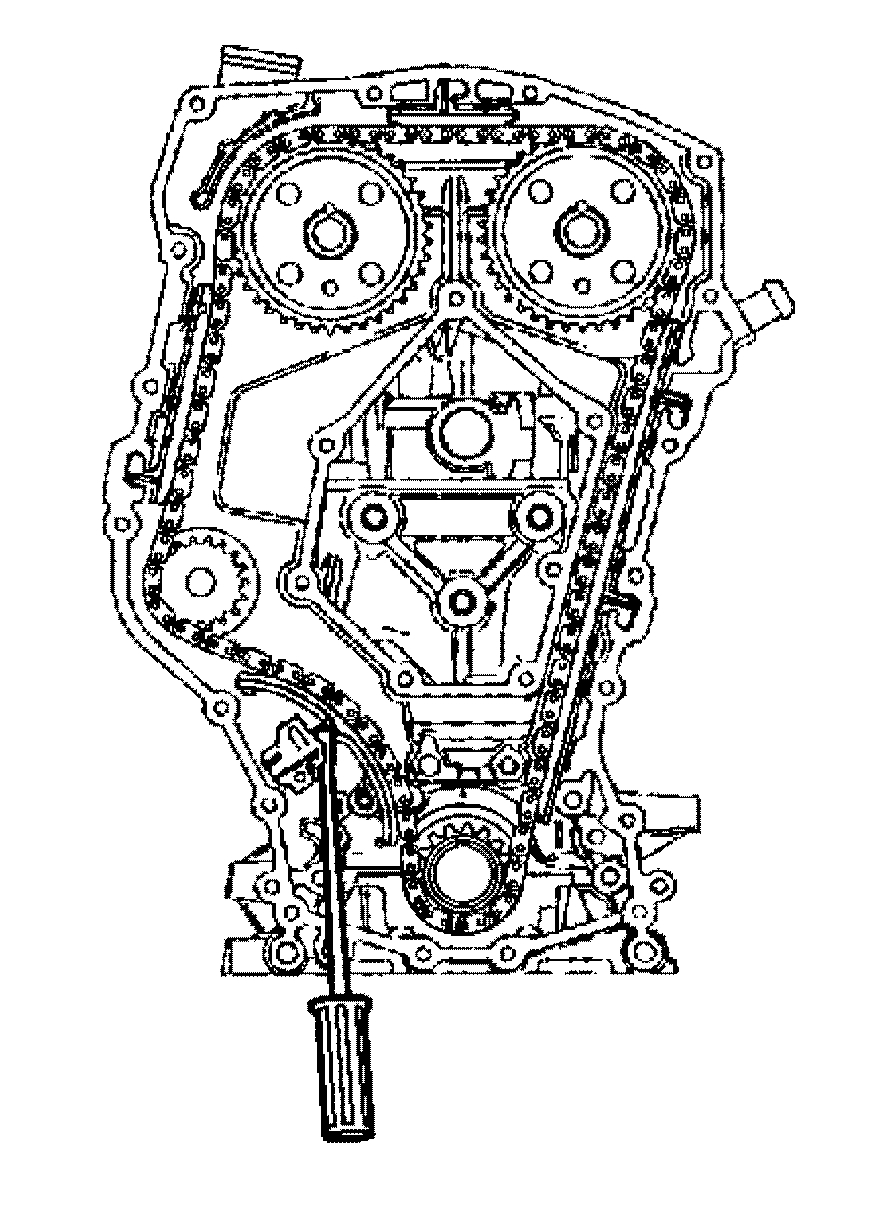

7. Ensure that all of the slack in the timing chain is above the tensioner assembly.

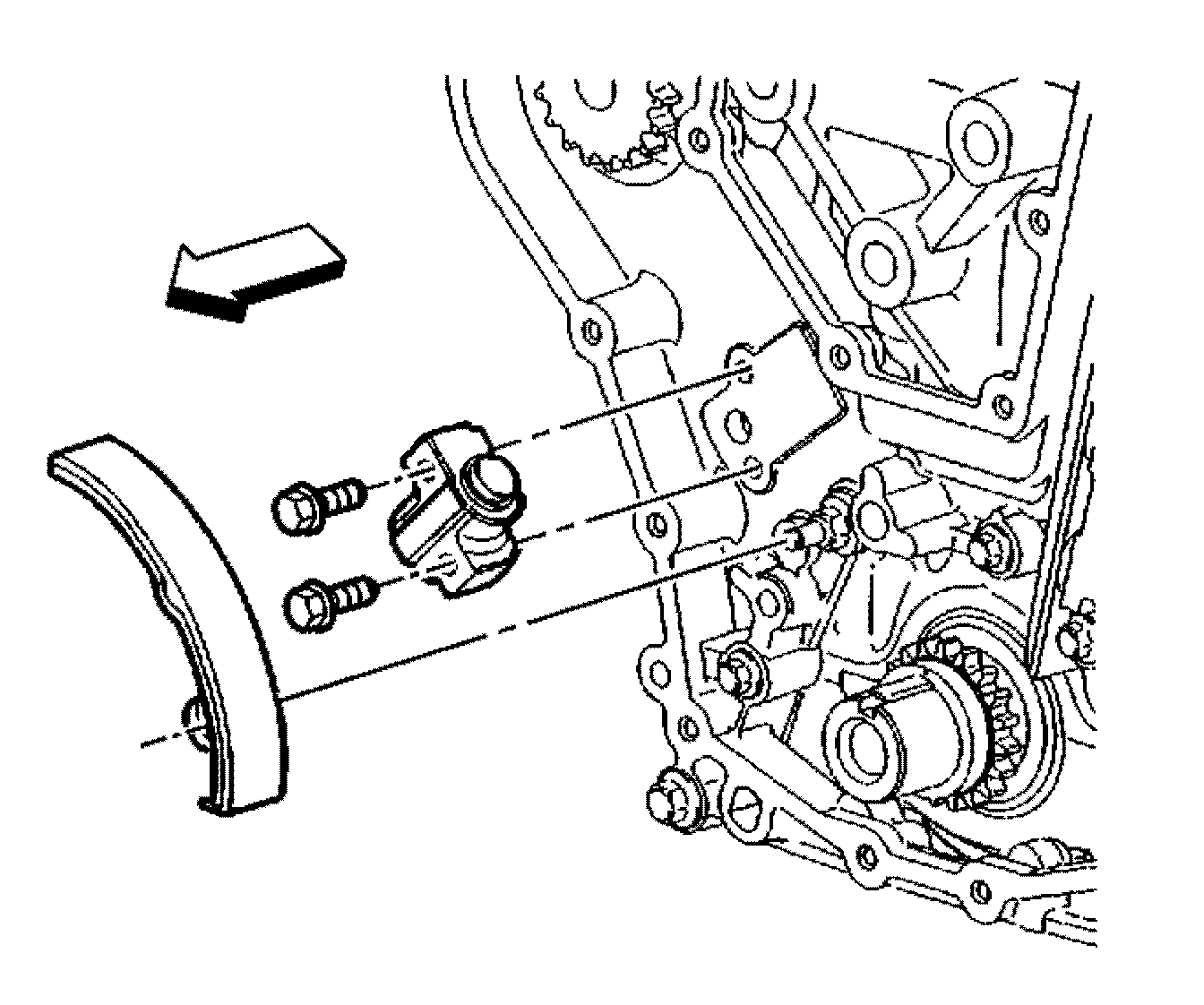

8. Remove the timing chain tensioner bolts and the tensioner.
pic 9
9. Remove the tensioner shoe. Use a small locking ring plier in order to engage the hole in the locking tab and remove the shoe from the stud.

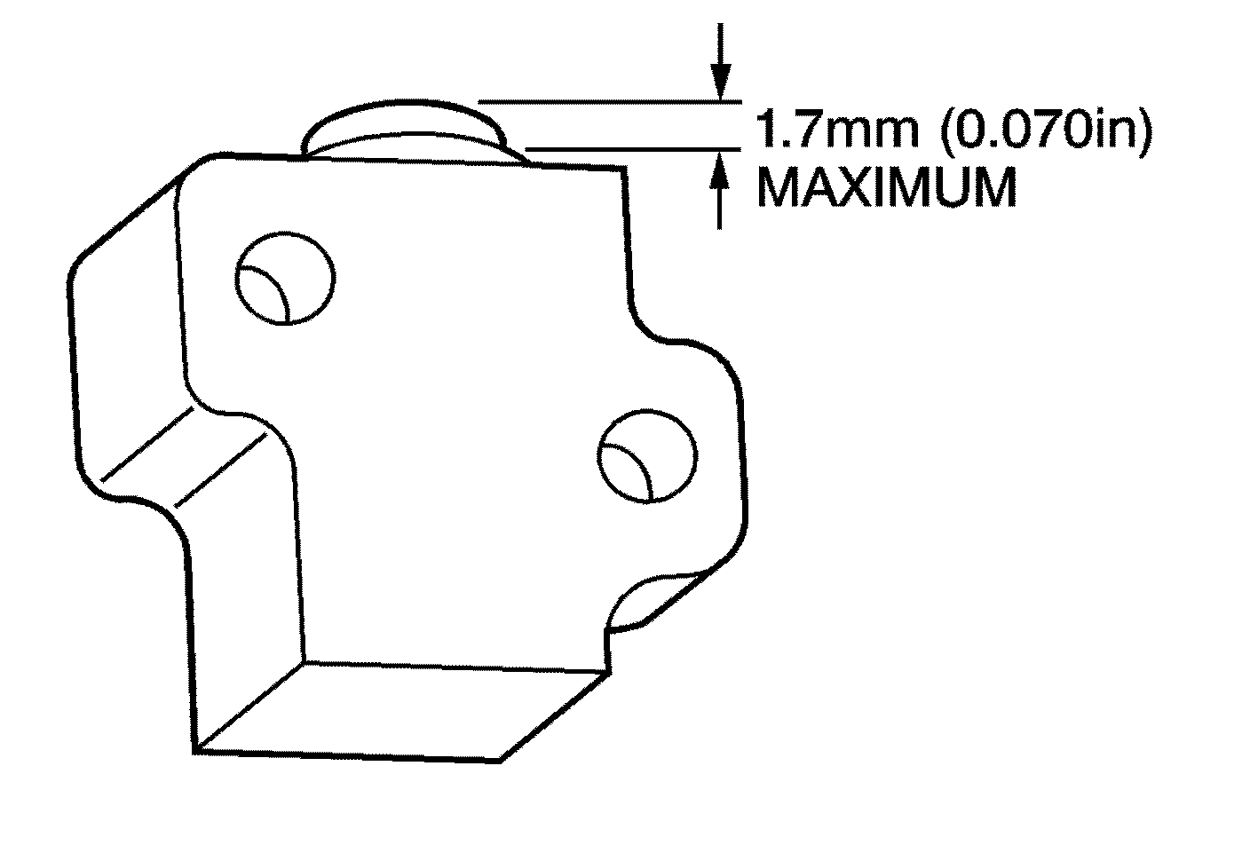

Important: Use the following steps in order to reset the timing chain tensioner assembly to the zero position.
9. Reset the timing chain tensioner assembly.
9.1 Insert the tensioner plunger assembly into the tensioner housing.
9.2 With the tensioner plunger fully extended, turn the complete assembly upside down on a bench or other flat surface.
9.3 With the plunger face against the workbench, press firmly on the bottom of the tensioner housing.
9.4 Compress the plunger until the plunger is seated flush in the tensioner.
pic 15
10. Check the plunger to make sure the plunger is out of the cylinder at the correct dimension. The correct dimension for the plunger to extend out of the cylinder is 1.7 mm (0.07 in.) maximum.

pic 17
Important: the timing chain tensioner is not released from the installation position, engine damage will occur when the engine is started.
15. Release the timing chain tensioner plunger.
15.1 Using a flat blade screwdriver, cotter pin remover, or similar tool, press firmly against the face of the timing chain tensioner plunger.
Important: If the timing chain tensioner cannot be depressed, the plunger is not properly reset and the procedure for resetting the timing chain tensioner should be repeated.
15.2 Depress the timing chain tensioner plunger until the plunger is bottomed out in the bore of the timing chain tensioner.
15.3 Release the tensioner plunger. the plunger should press firmly against the back of the timing chain tensioner shoe.
16. Remove J 36800 from the camshaft sprockets.
17. Rotate the crankshaft clockwise 2 full rotations. Align the crankshaft keyway with the mark on the cylinder block, and reinstall the alignment dowel pins. The pins should slide in easily if the engine is timed correctly.
pic 18
18. Install the timing chain guides.
19. Install the engine front cover. See: Timing Cover > Procedures > Engine Front Cover Replacement
20. Connect the negative battery cable.
Tighten the bolt to 16 Nm (12 ft. lbs.).
