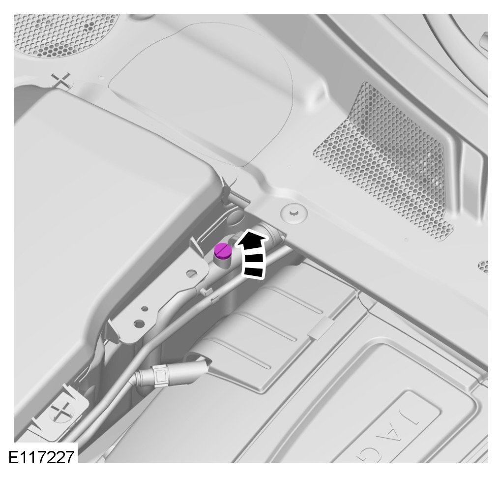

Here is the fill procedure and posting an image of what appears to be the bleeder screw:
