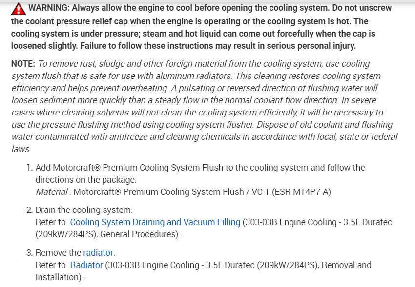

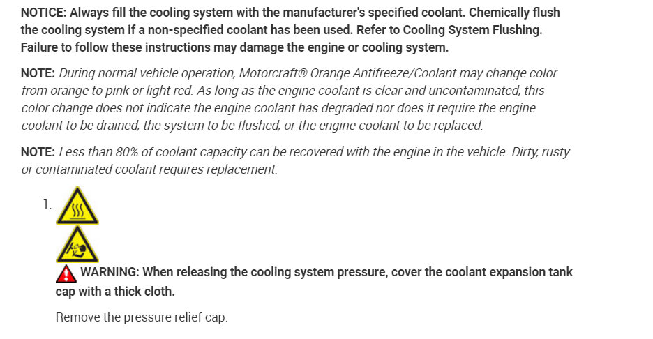

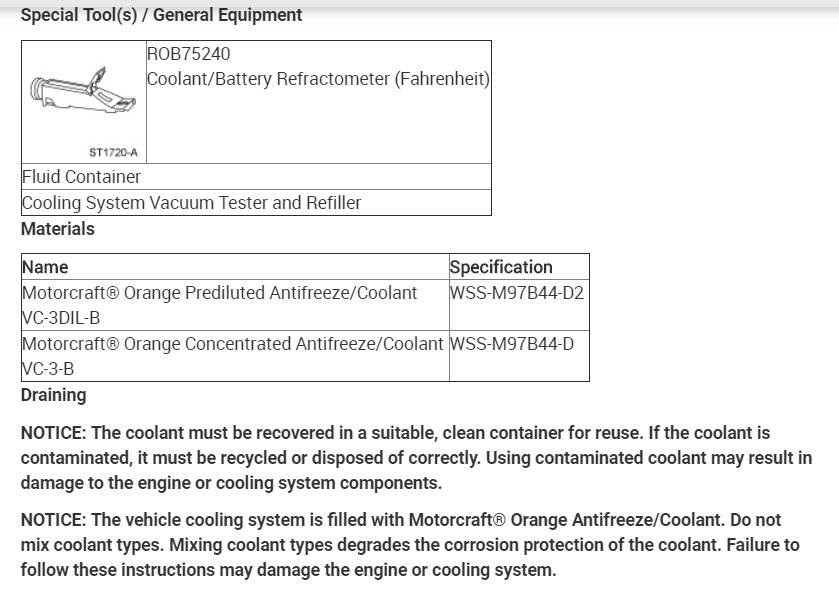

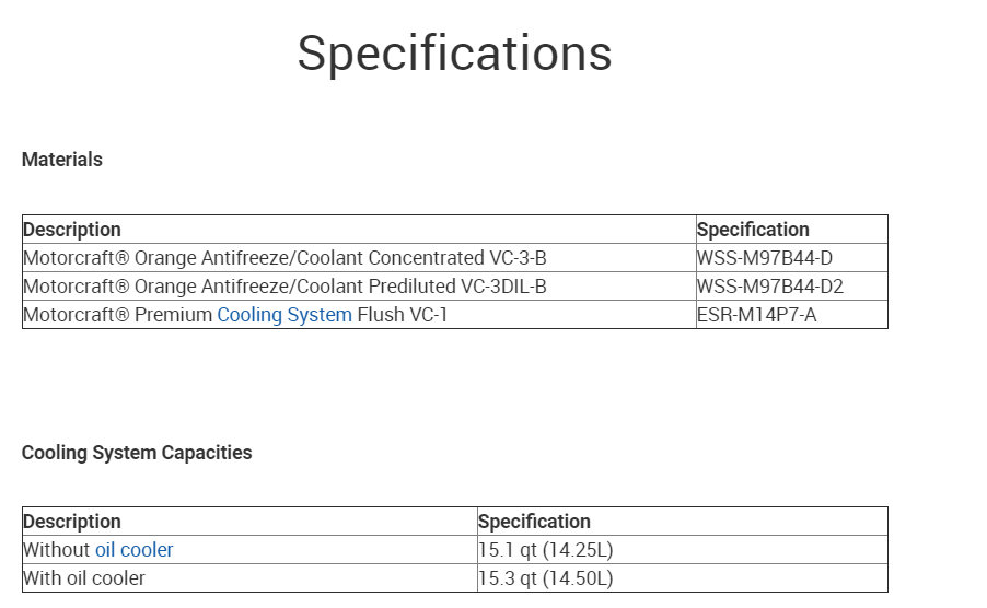

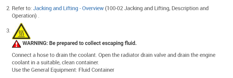

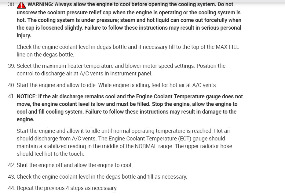

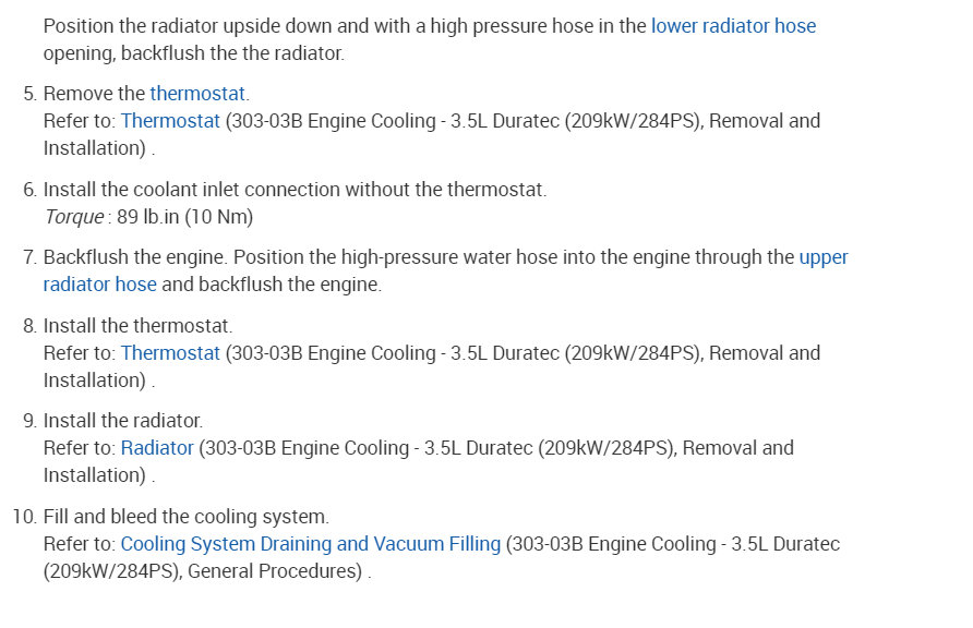

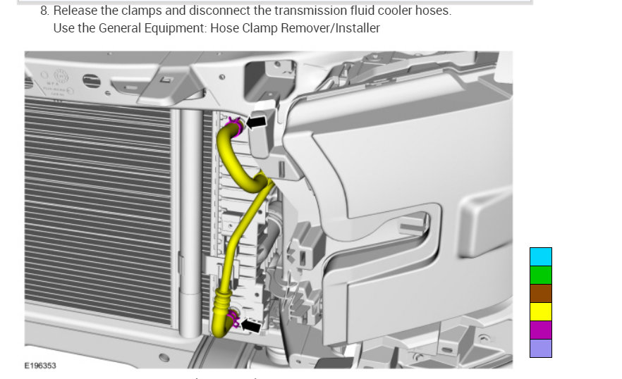

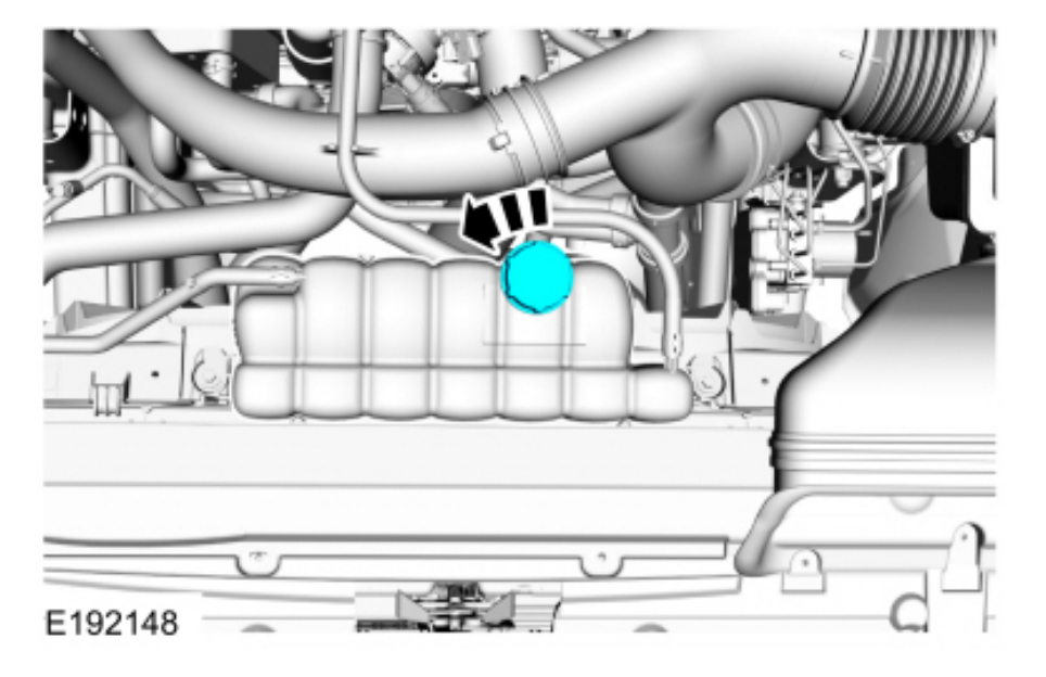

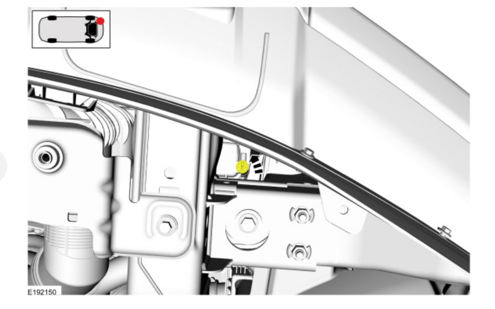

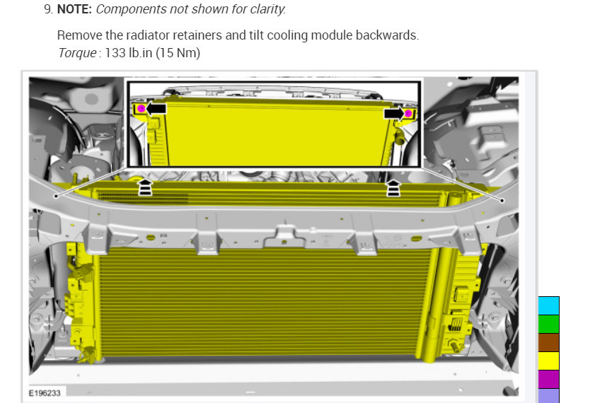

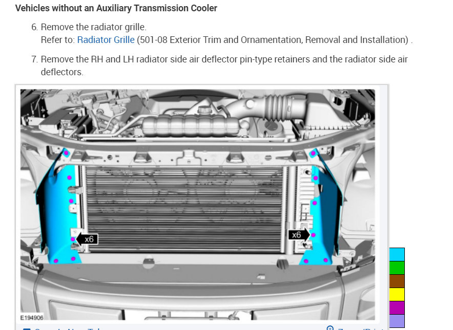

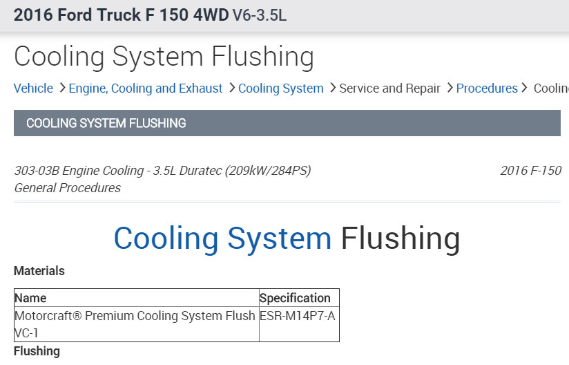

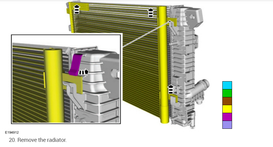

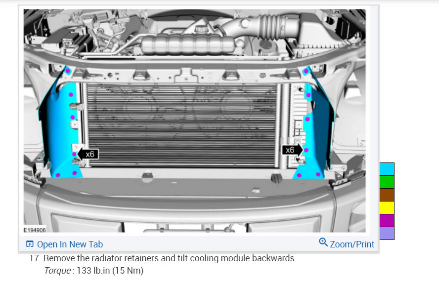

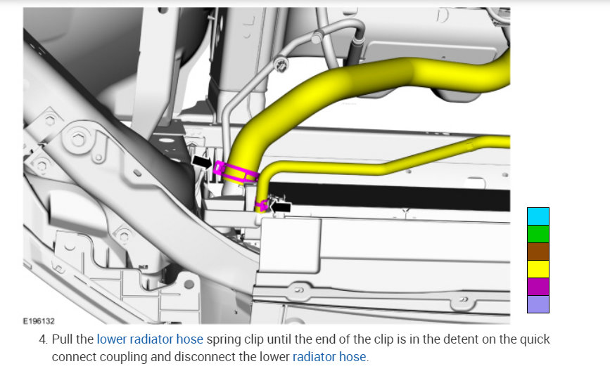

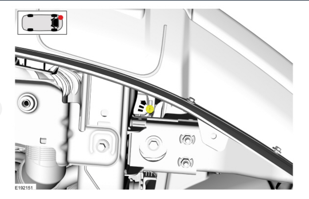

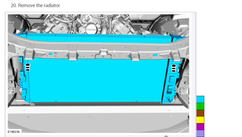

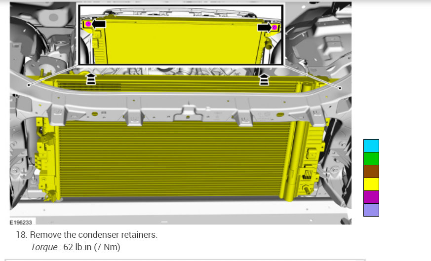

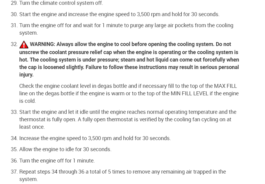

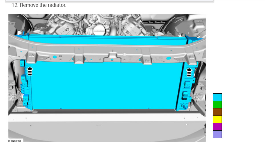

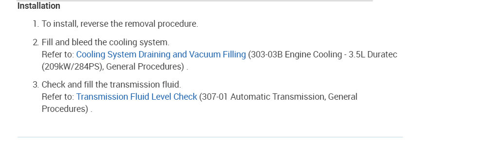

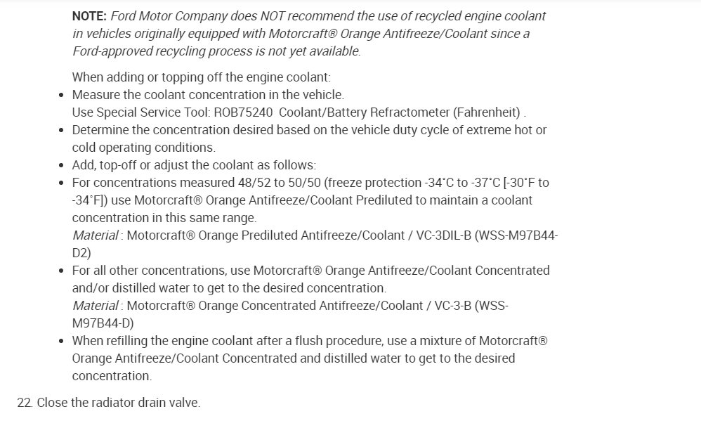

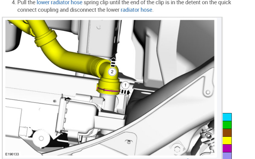

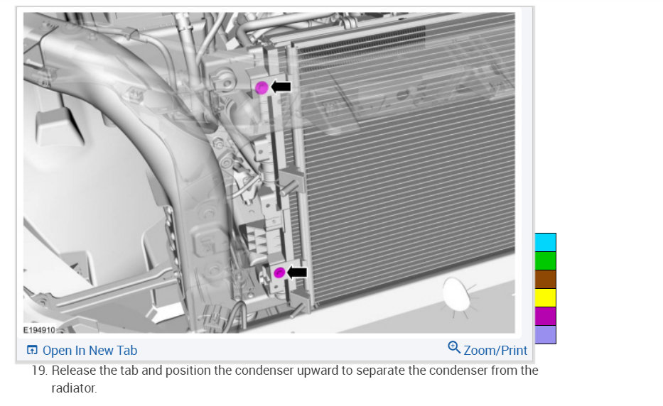

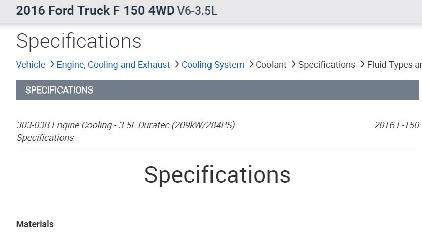

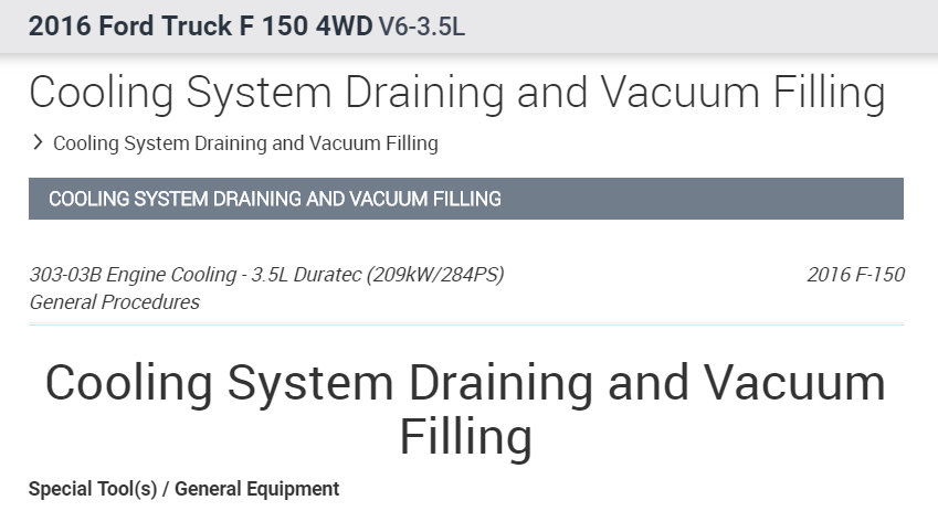

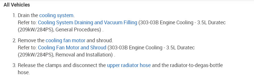

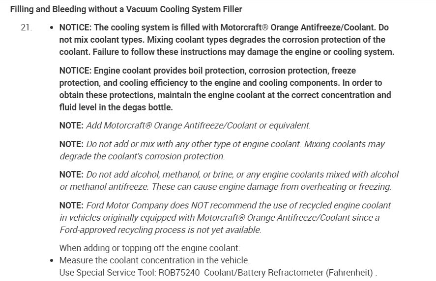

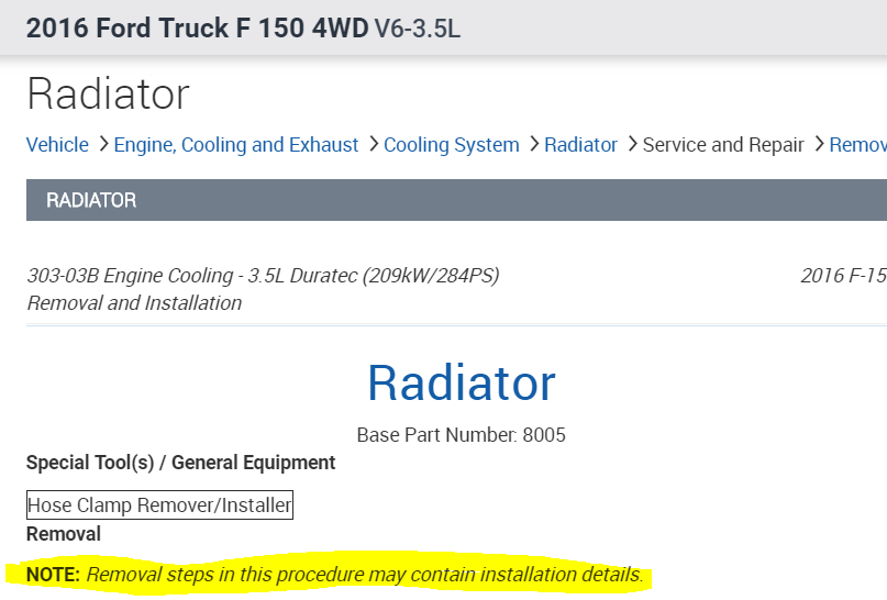

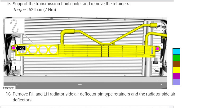

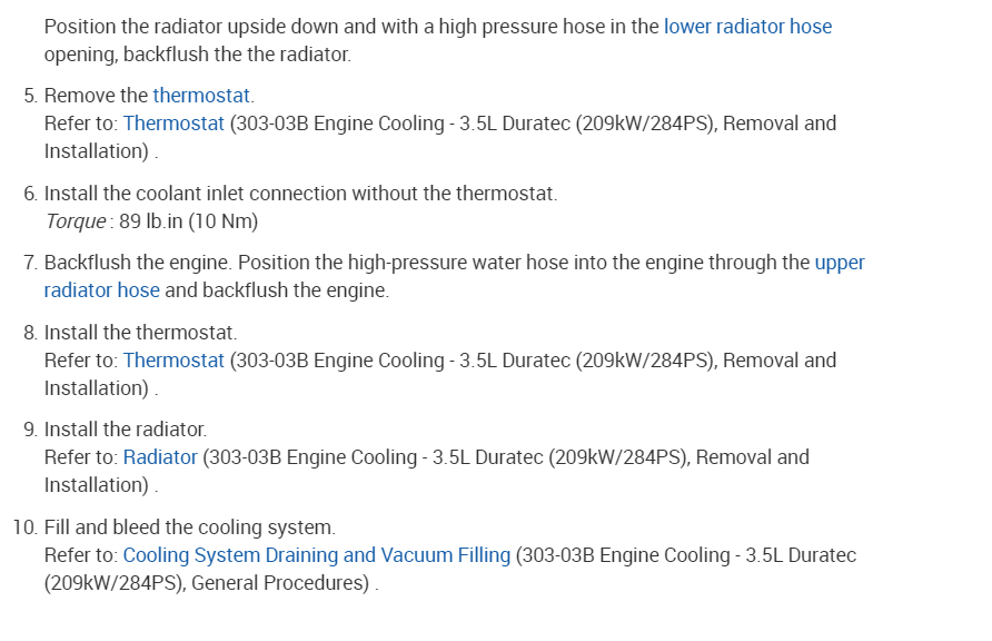

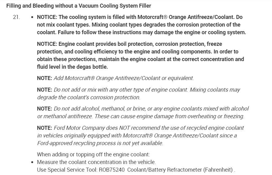

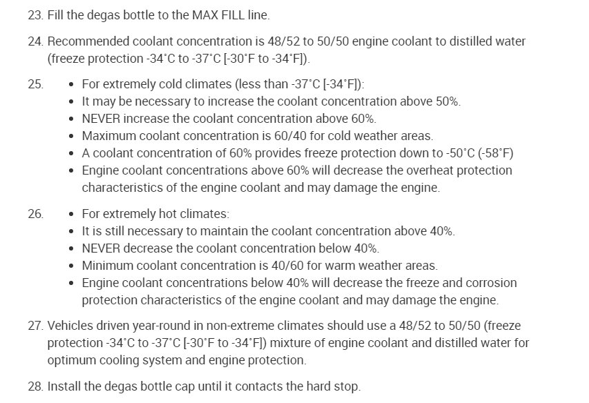

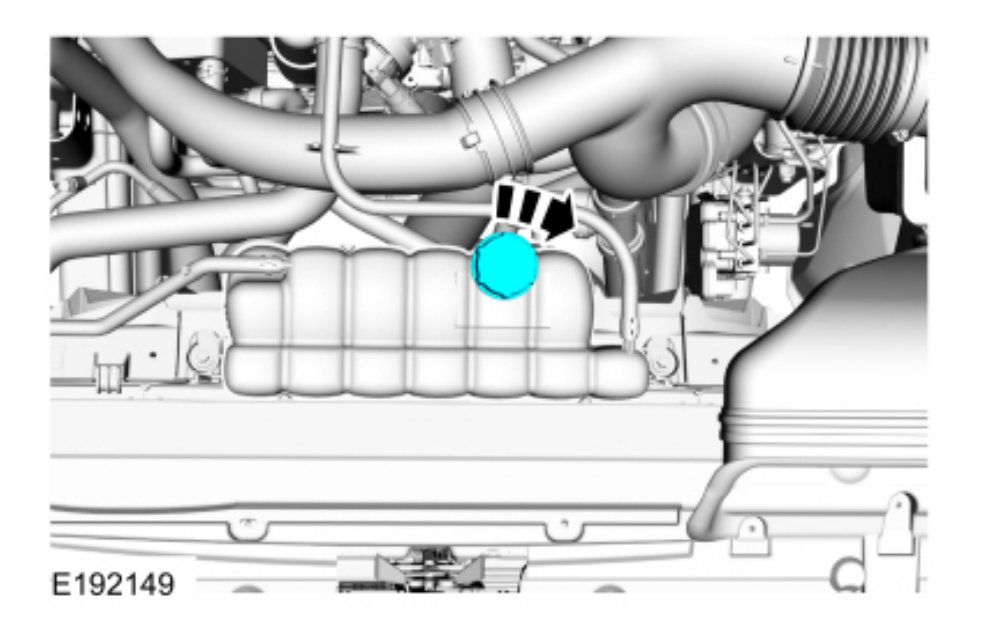

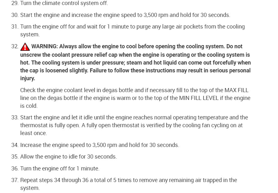

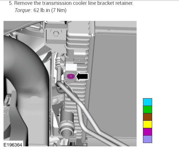

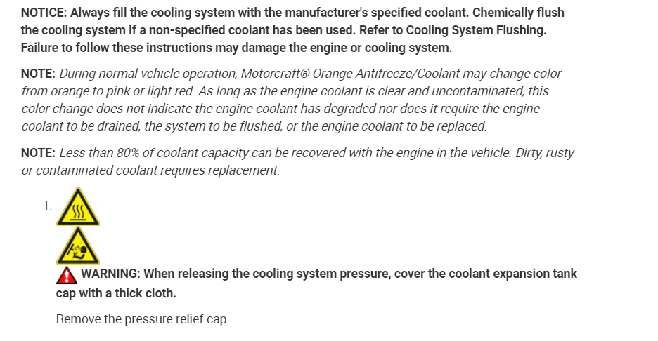

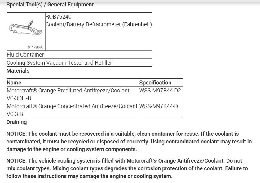

That is only 1/3 of the coolant capacity of your vehicle. In the diagrams down below I have included the coolant and capacities for your vehicle as well as the instructions for flushing your cooling system from the vehicle manufacturer. Here is a guide to help you step by step with instructions in the diagrams below to show you how on your car.
https://www.2carpros.com/articles/coolant-flush-and-refill-all-cars
Description Specification
Motorcraft® Orange Antifreeze/Coolant Concentrated VC-3-B WSS-M97B44-D
Motorcraft® Orange Antifreeze/Coolant Prediluted VC-3DIL-B WSS-M97B44-D2
Motorcraft® Premium Cooling System Flush VC-1 ESR-M14P7-A
