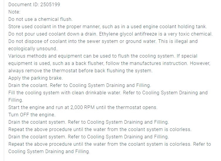

You've helped me with information on my family's Cruze, Sonic, ATS and now I need correct procedure regarding my daughter's vehicle listed above. Thank you.
Sep 27, 2020 at 12:48 PM
Good afternoon,

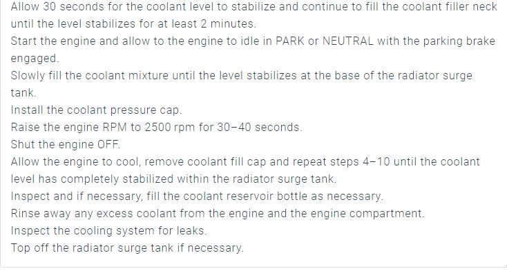

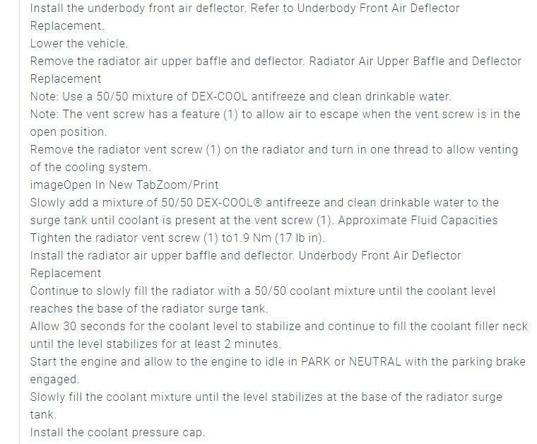

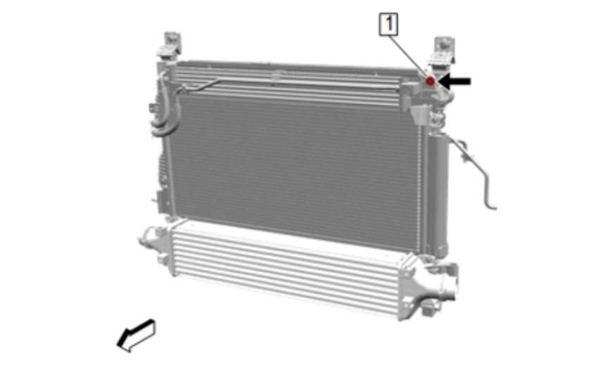

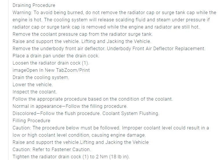

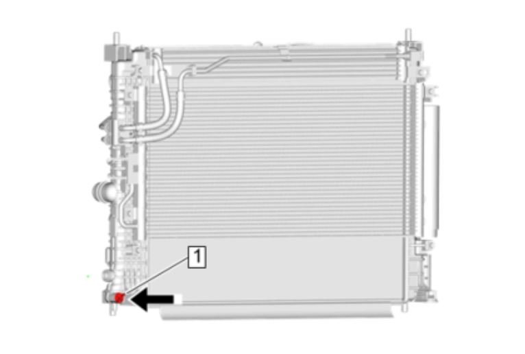

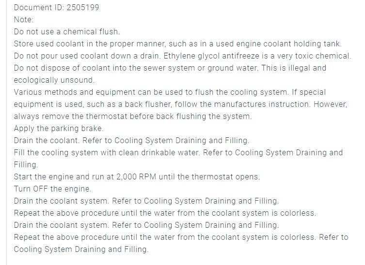

I attached the procedure for flushing for you below with some pictures.
https://www.2carpros.com/articles/coolant-flush-and-refill-all-cars
Let us know if you have any other questions
Sep 27, 2020 at 1:36 PM
SIRJR
  • 86 POSTS
Thank you for the information. Just making sure that this procedure will apply to the Trax. I only ask this because, thanks to your site, I found out that on our Equinox, I have to apply a vacuum system in order to replenish the coolant.
Sep 28, 2020 at 6:30 AM
Yes, this information is strictly for the Trax.
You are welcome.
Always glad to help.
