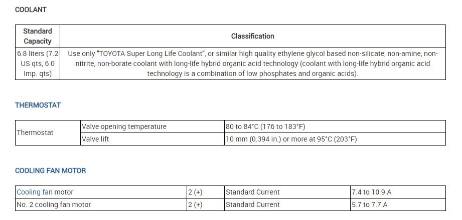

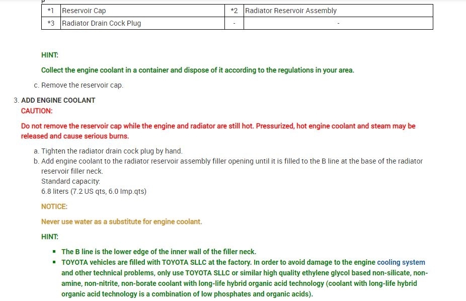

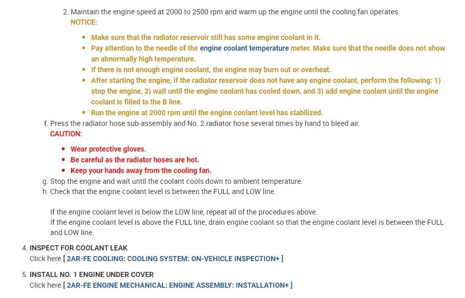

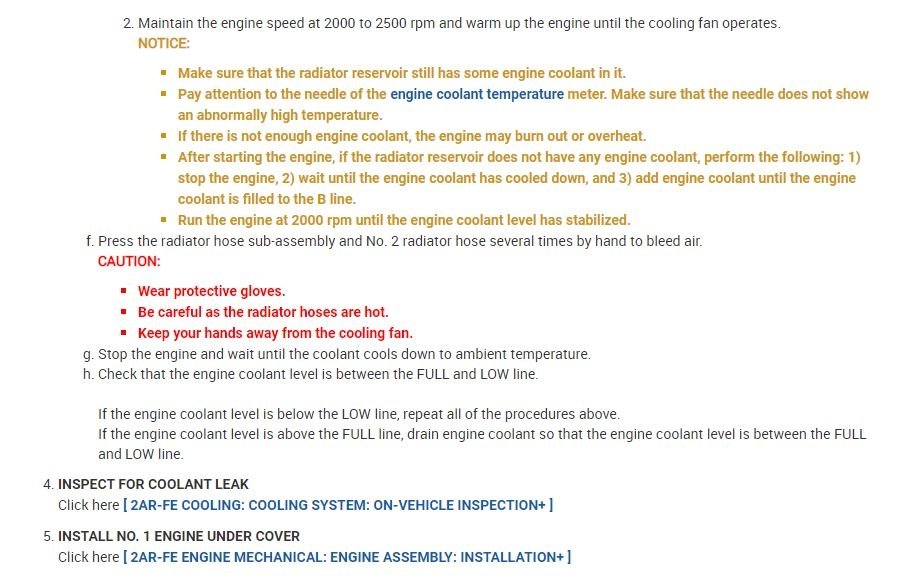

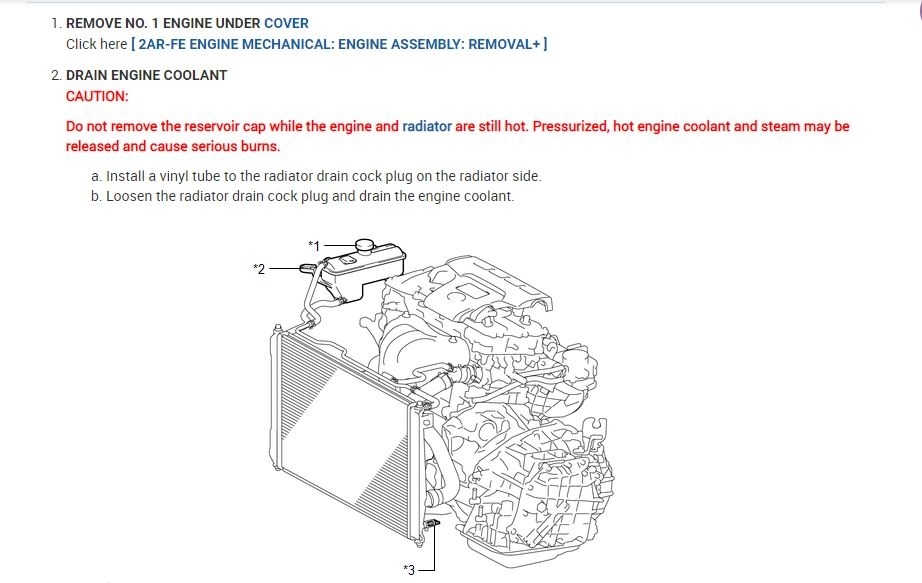

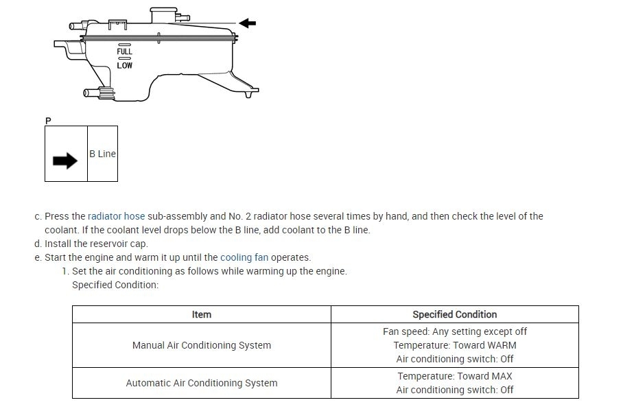

Use a 50-50 mix. All coolants today require this for their system for maximum protection.
I attached a guide for flushing the system as well as the actual procedure for you for your vehicle as well.
https://www.2carpros.com/articles/coolant-flush-and-refill-all-cars

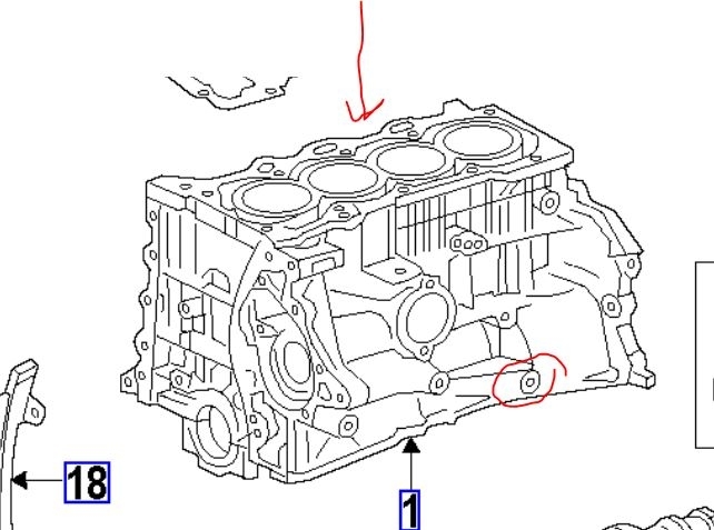

Oh okay, thank you very much. in other words don’t look or try to look for a engine drain plug I don’t even know if there is one is there? So 50/50 in reservoir until it’s full, correct? I appreciate you helping me out. Mike
Mar 31, 2021 at 7:16 AM
There is one but it takes a while to find it moving things out of the way to get access.
Yes, the system uses 50-50 for the entire cooling system.

I attached a picture of the block for you. The drain will be a plug located close to the bottom of the block. I circled where it could be on each side.
Mar 31, 2021 at 7:33 AM
JERSEYGUY19
  • 10 POSTS
So don’t try to loosen them leave them alone right? I’m not really great on cars I’m just a normal home owner with two ramps for front tires. So leave them alone correct? Thanks
Mar 31, 2021 at 8:24 AM
In my opinion, yes, leave them alone.
