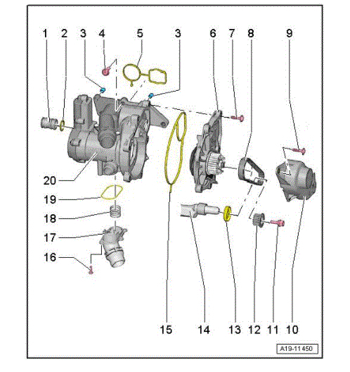

I would change the thermostat. It may not be opening fully or on time causing the fluid to boil. I know the thermostat is part of the coolant pump. Did they offer any option for temperature?
https://www.2carpros.com/articles/how-an-engine-thermostat-works
The other possibility is the head gasket may be leaking and causing the fluid to boil under load.
