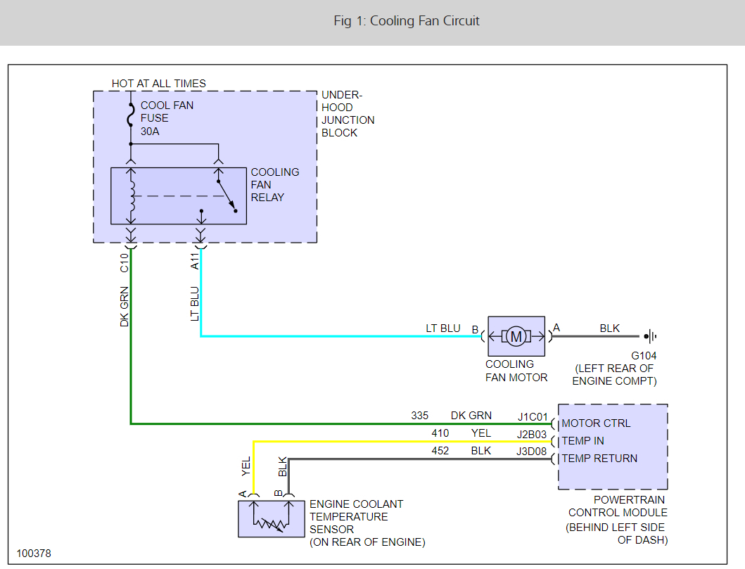

Gets up to the middle on gauge, coolant goes backwards out of pressurized reservoir. Changed thermostat, new reservoir and cap, new relay. The fans not coming on, but hot wired the fan and I know it works. Help!
