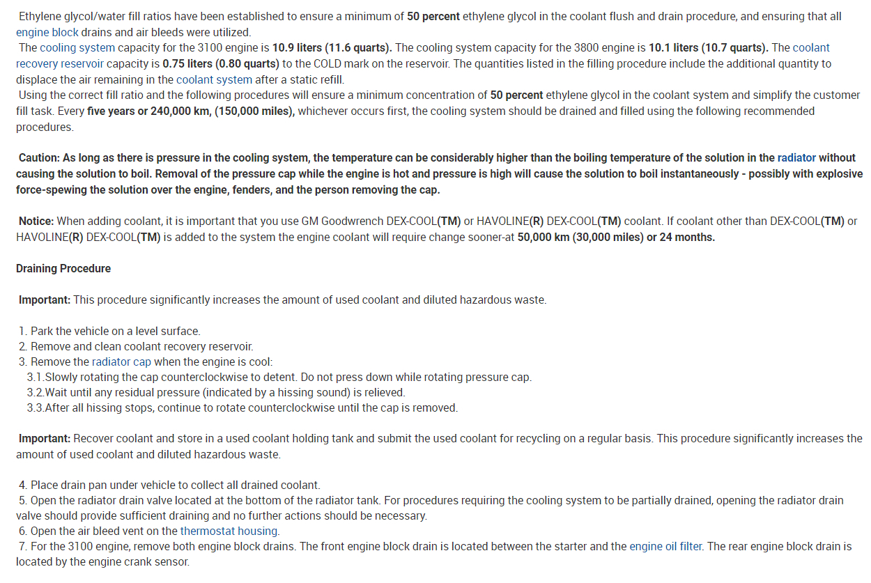

The coolant reservoir is empty. There is about 3oz. in it but it's black and there are some chunks inside. Should I replace the radiator, even though it's not leaking, hoses and thermostat?
Now, I can take out the coolant reservoir container to wash it out. Should I also flush it with some cleaner?
