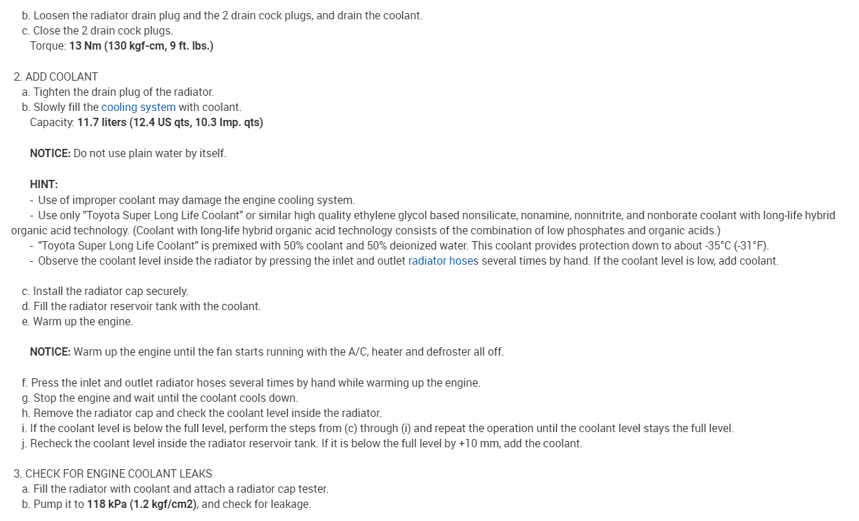

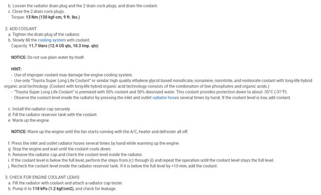

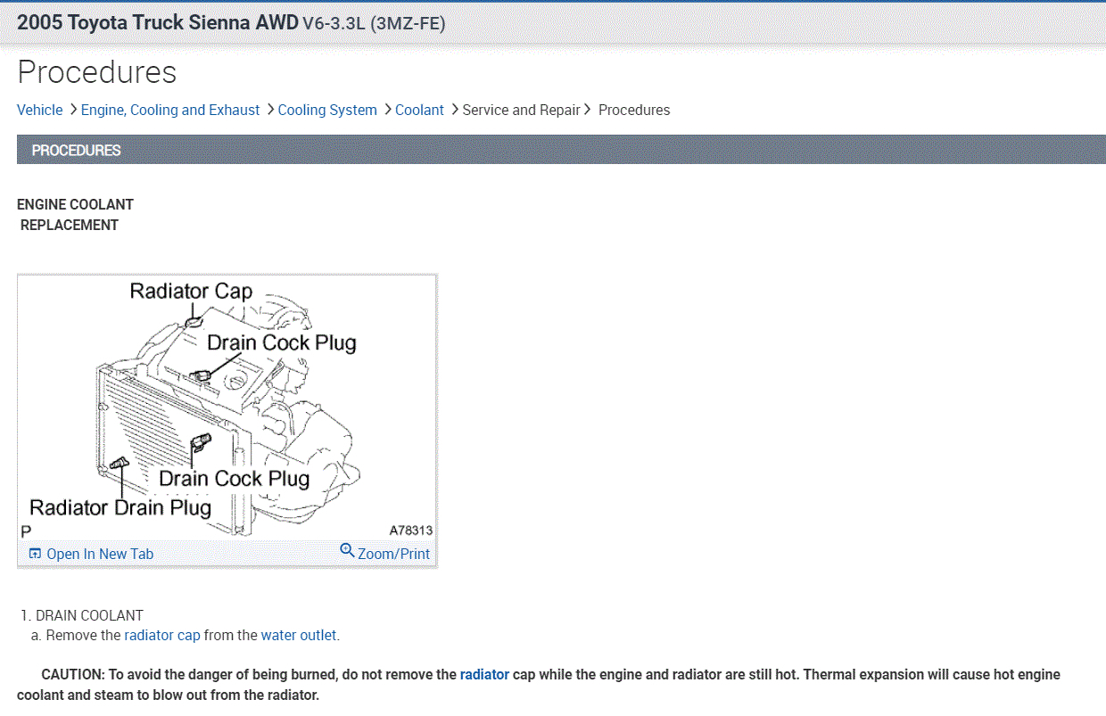

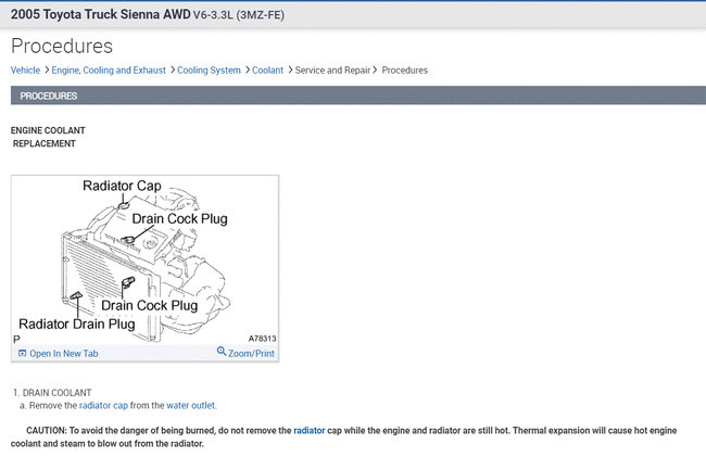

After replacing the hose, first fill the radiator with coolant slowly, replace the radiator cap, and then fill the reservoir to the full mark. Next, turn the heater on high and start the engine. Allow it to reach operating temperature and make sure the heater is producing heat.
If you look at the pics below, they are from my manual explaining how to drain and fill the engine coolant. These directions are specific to your vehicle.
See pics below.

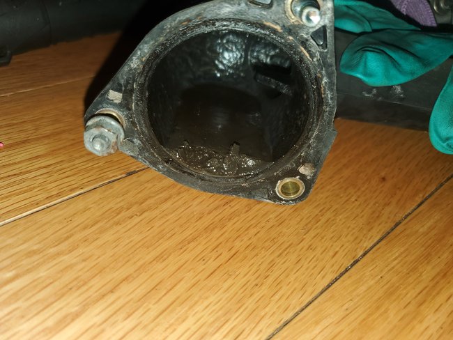

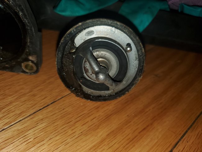

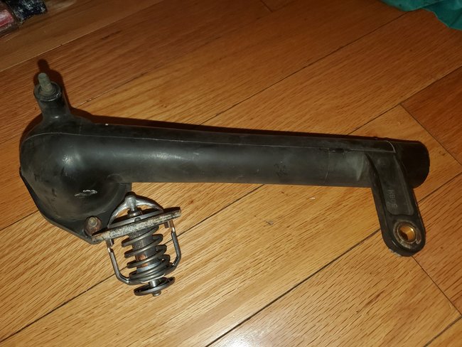

removed the thermostat housing and noticed a lot of crud inside the housing and around the thermostat. Has the consistency of mud. What could this be. Now, when removing the housing, the thermostat was stuck to it also.
Nov 14, 2021 at 10:27 AM

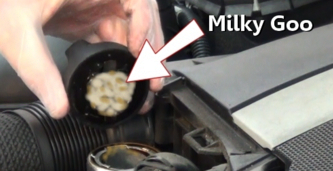

When coolant and motor oil mix, it creates something like you described. Take a look at pic 1 below. That is an oil cap showing what the oil looks like when contamination exists. Is that what you are seeing? Also, could you take a pic and upload it for me to see?
See pic below.

Here are the Pics. The first. Two pics are the "sludge" build-up.

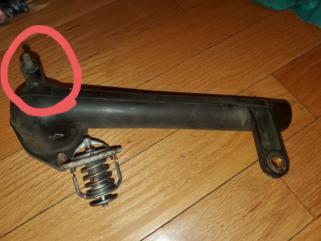

Now, the third pic, the highlighted object had no connections. Should there be something connected to it like a sensor?
The fourth. pic is the same as the third. without the highlighted marking.

The pic below shows the other end of the thermostat housing that connects to the lower radiator hose. It also has some sludge in it.

Sorry, forgot to upload pic in last reply.
Other end of thermostat housing with sludge build-up as well.
Nov 14, 2021 at 7:05 PM
You are fine. It may be a good idea to flush the cooling system while you have it apart. What you are seeing is simply due to age and use. I was a bit worried at first. LOL
As far as pic 3, no sensor goes there. That simply looks like a place something was supported to such as wiring. No worries.
