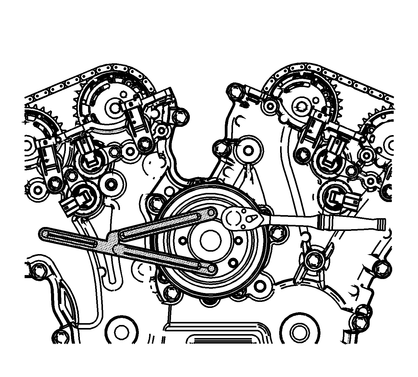

EN 46104 - Water Pump Pulley Holding Tool
Removal Procedure
1. Drain the cooling system. Refer to Cooling System Draining and Filling (Static Fill) See: Cooling System > Procedures > Cooling System Draining and Filling (Static Fill)Cooling System Draining and Filling (Vac N Fill) See: Cooling System > Procedures > Cooling System Draining and Filling (Vac N Fill).
2. Remove the drive belt. Refer to Drive Belt Replacement See: Drive Belt > Removal and Replacement > Drive Belt Replacement.
3. Remove the right engine strut mount. Refer to Engine Mount Strut Replacement - Right Side See: Engine Mount > Removal and Replacement > Engine Mount Strut Replacement - Right Side.
4. Remove the right engine mount strut bracket. Refer to Engine Mount Strut Bracket Replacement - Right Side See: Engine Mount > Removal and Replacement > Engine Mount Strut Bracket Replacement - Right Side.
5. Use the EN 46104 - tool in order to retain the water pump pulley.

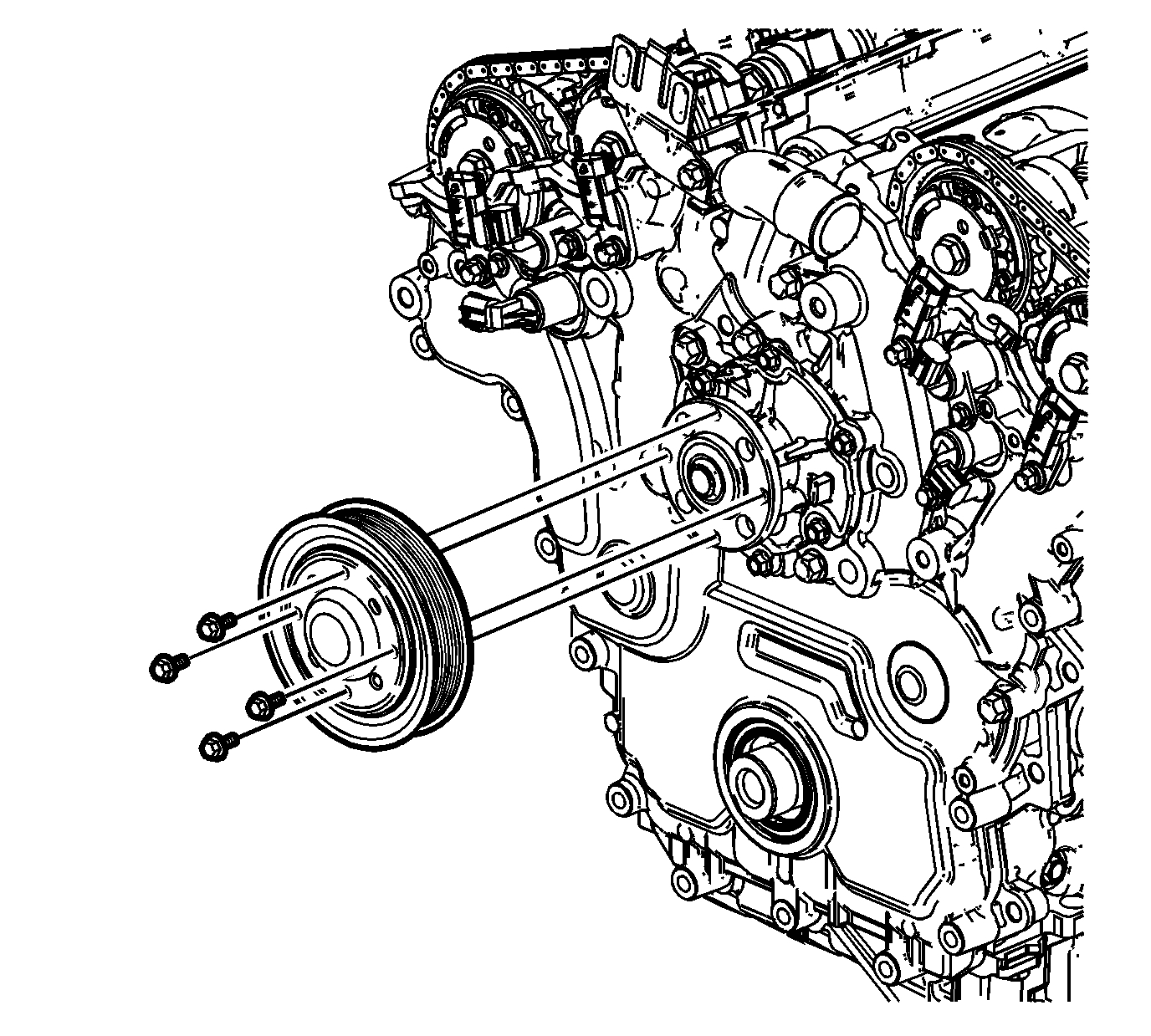

6. Remove the water pump pulley bolts and DISCARD the bolts.
Caution: This vehicle is equipped with torque-to-yield or single use fasteners. Install a NEW torque-to-yield or single use fastener when installing this component. Failure to replace the torque-to-yield or single use fastener could cause damage to the vehicle or component.
7. Remove the water pump pulley.

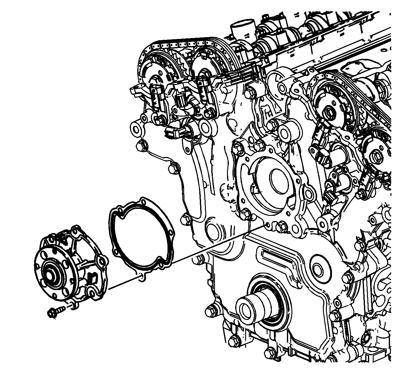

8. Remove the water pump bolts and DISCARD the bolts.
9. Remove the water pump.
10. Remove and DISCARD the water pump seal.
11. Carefully clean the water pump sealing surfaces.
Installation Procedure
1. Install a NEW water pump seal.
2. Install the water pump.

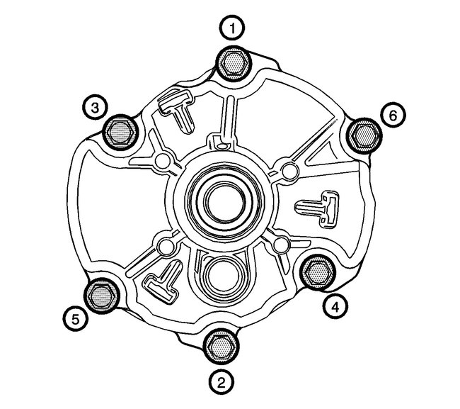

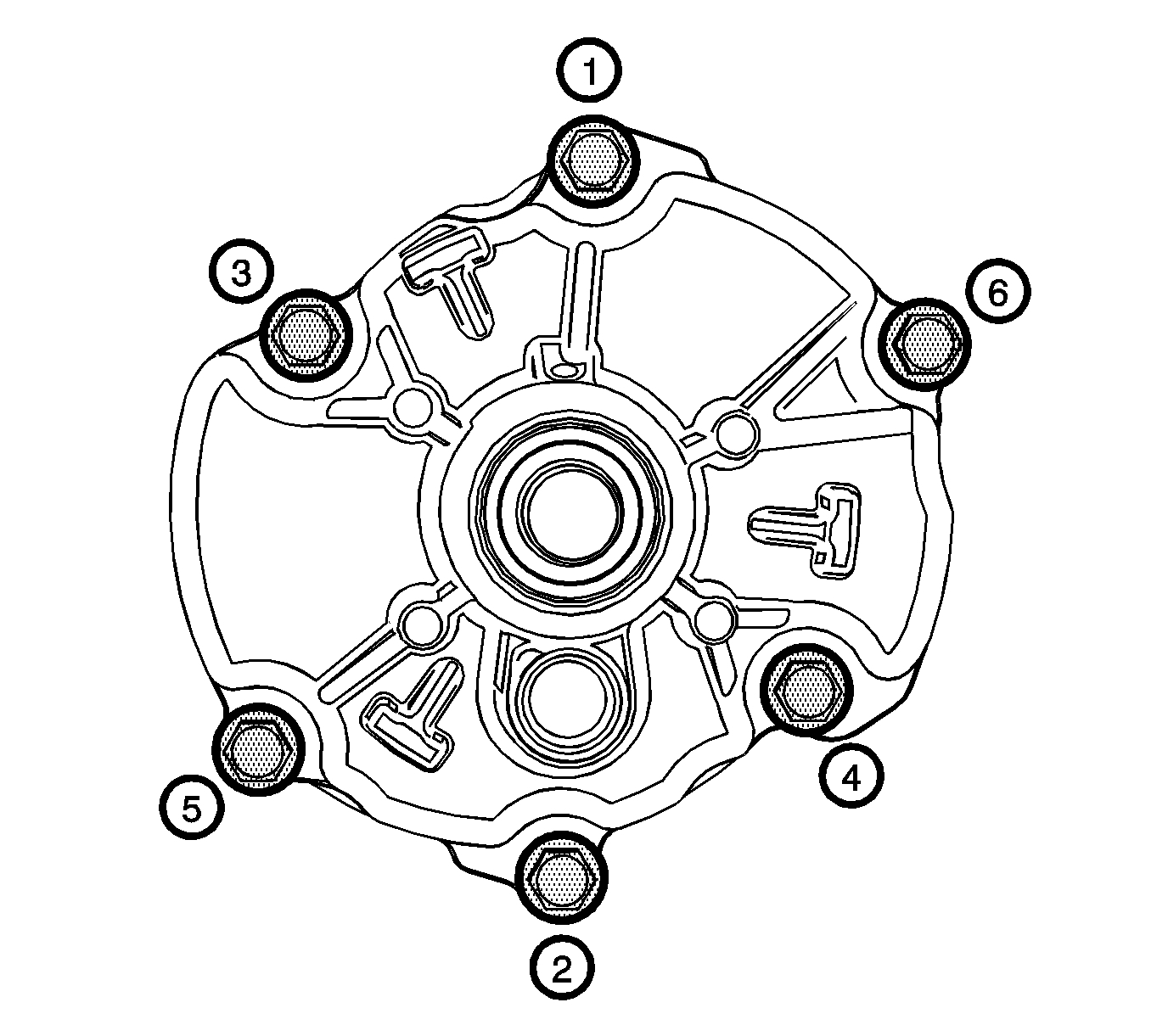

3. Install the NEW water pump bolts and hand tighten the water pump bolts.
4. Tighten the water pump bolts in sequence.
1. On the initial pass, tighten the bolts in sequence to 10 Nm (89 lb in).
2. On the second pass, tighten the bolts in sequence to 10 Nm (89 lb in).
3. On the final pass, tighten the bolts in sequence shown an additional 45 degrees.
5. Install the water pump pulley and the NEW water pump pulley bolts.
6. Use the EN 46104 - tool in order to retain the water pump pulley.
7. Install the water pump pulley bolts and tighten to 10 Nm (89 lb in).
