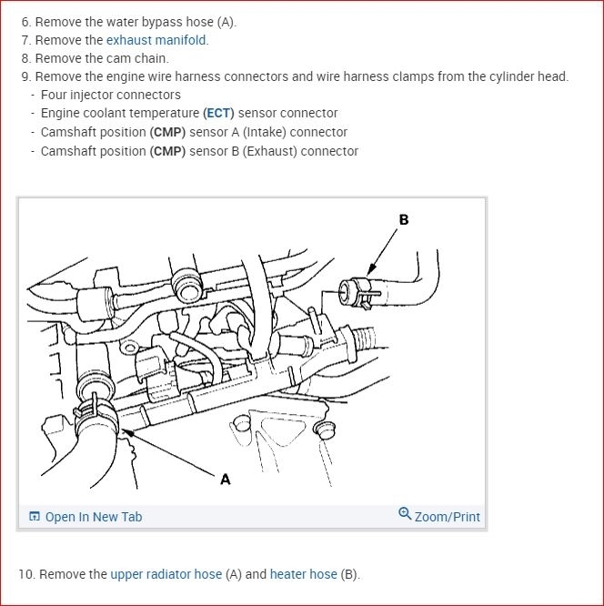

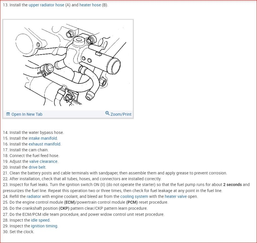

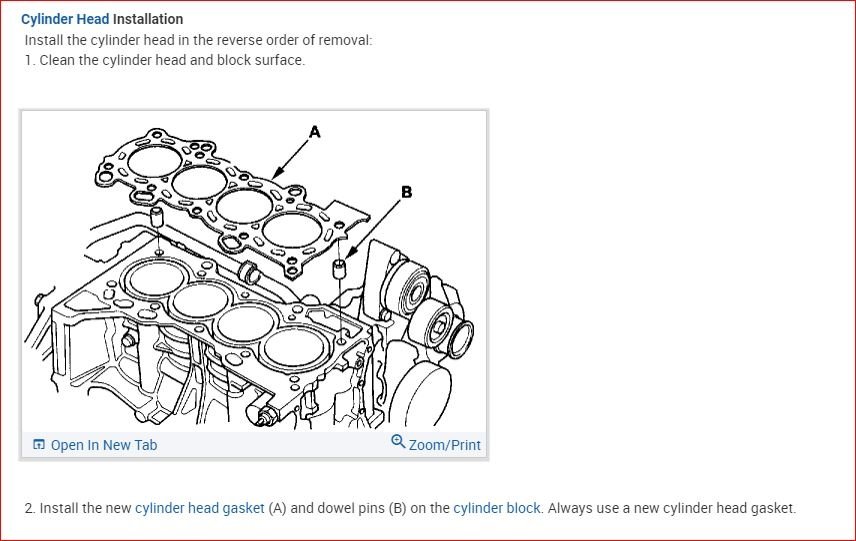

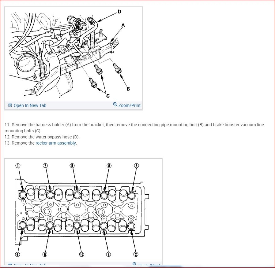

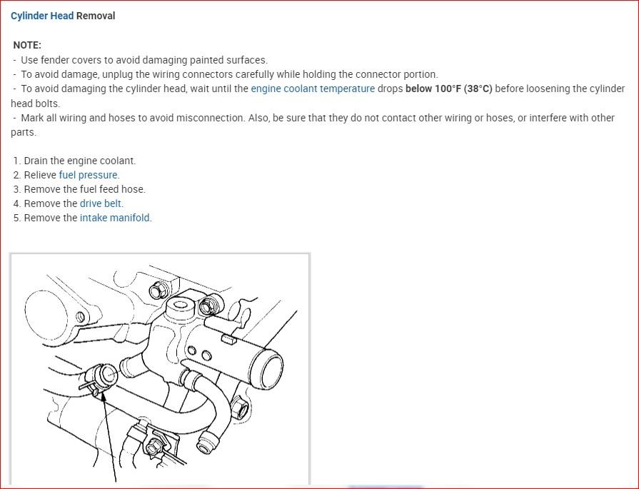

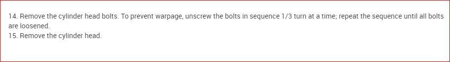

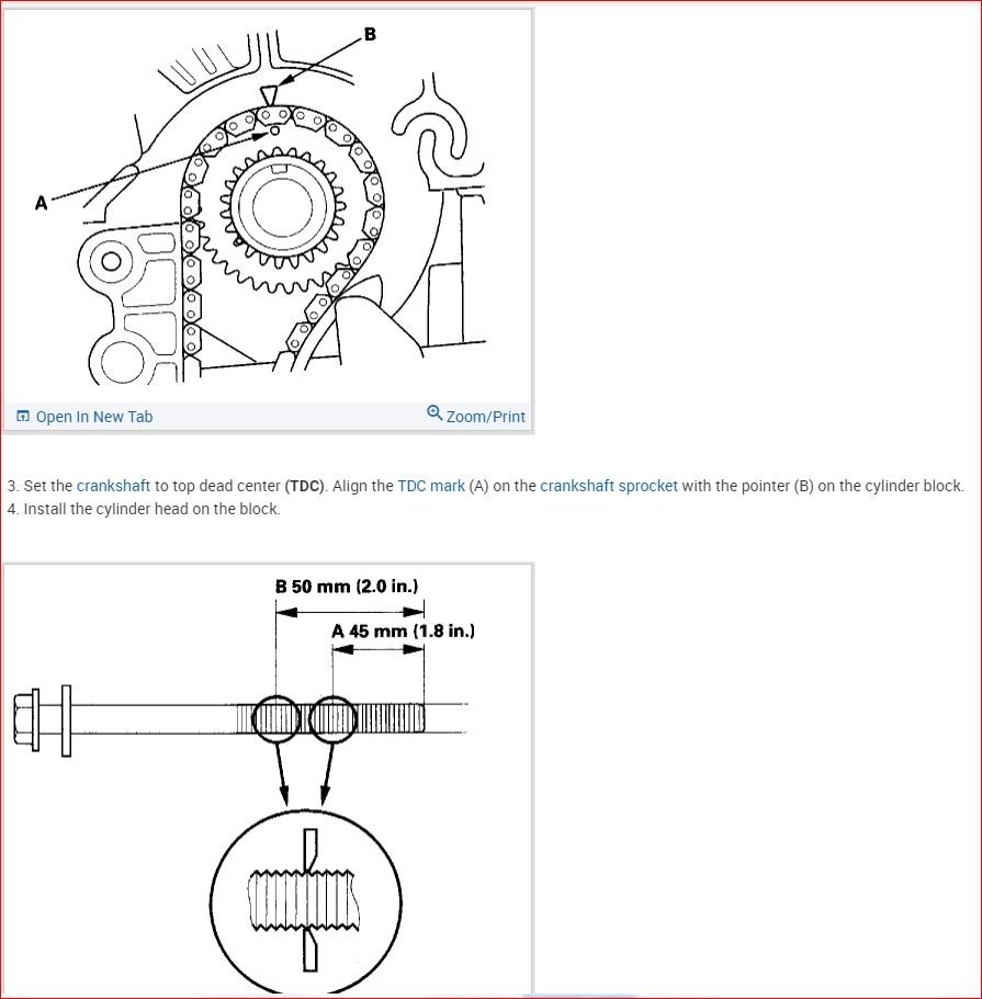

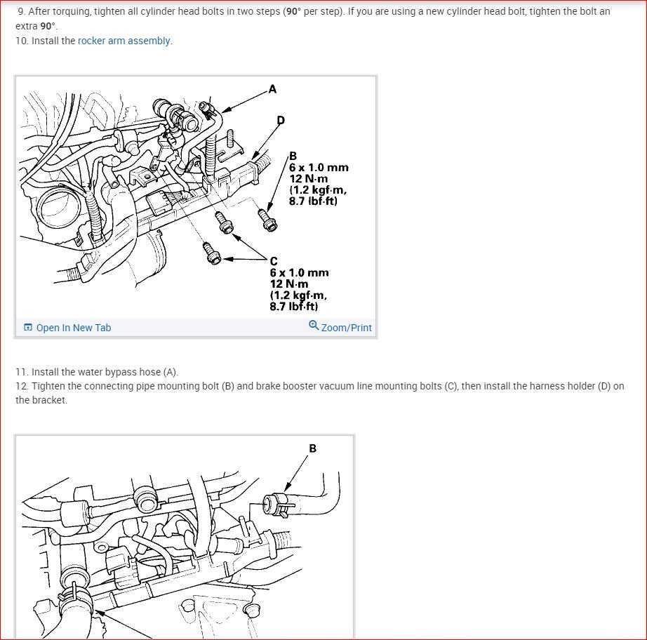

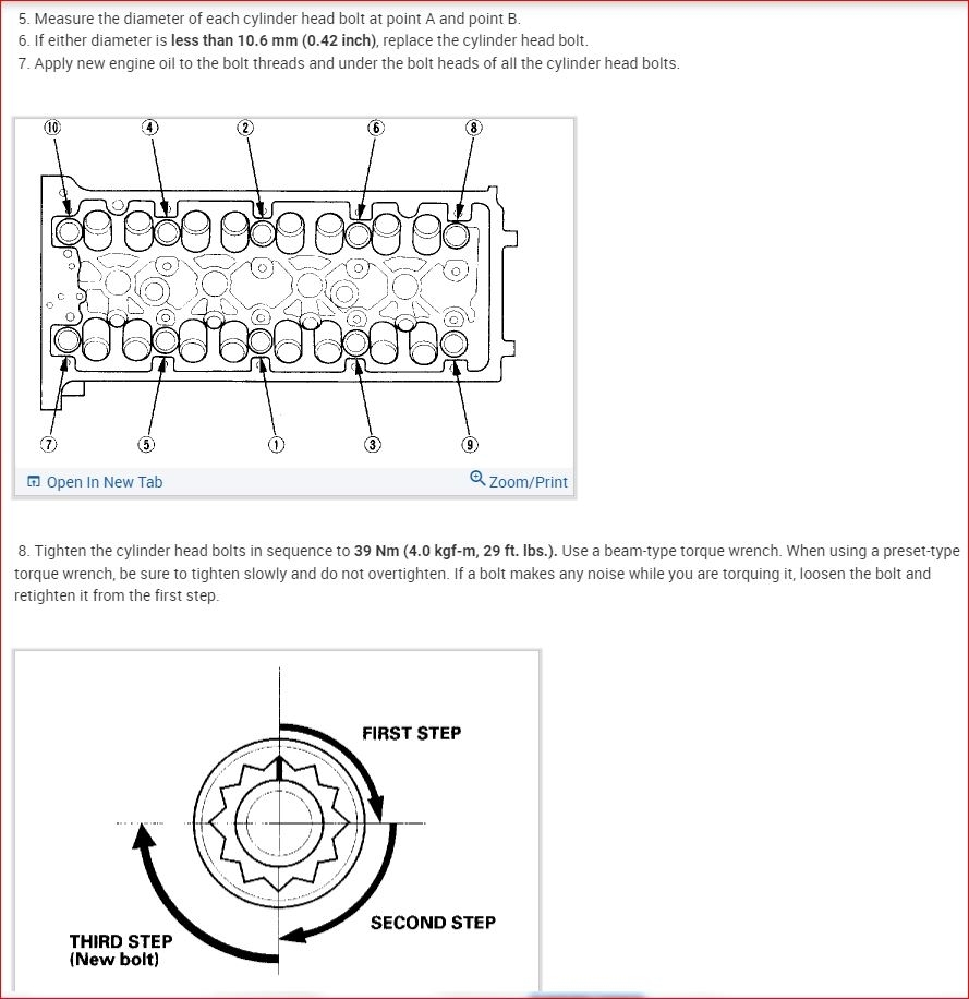

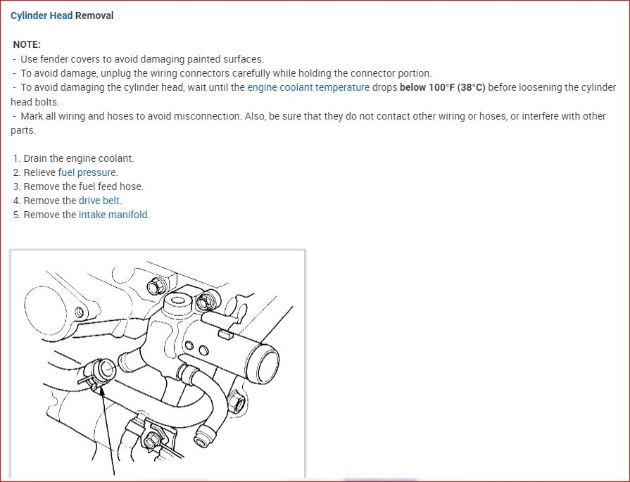

Here is a guide that will help test it. Also, I attached the process for replacing it if you want to do it yourself.
