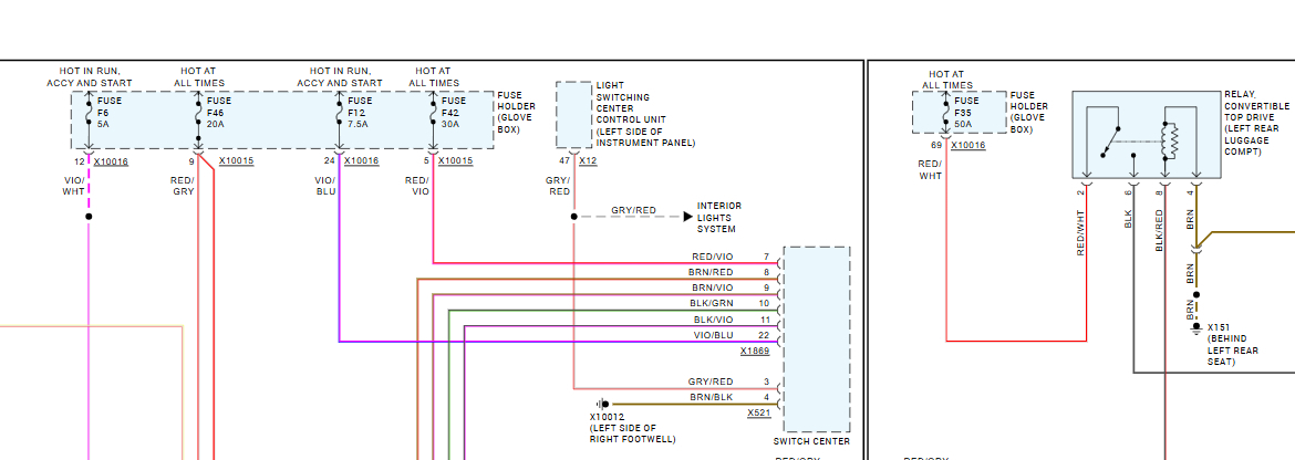

Yep, it is complex to say the least, there is a special BMW program that runs this system. It can be one of the 10 switches, three valves, also there are five fuses that run the system as well. I would start by rechecking the fuses and then run a CAN scan to see if any codes are stored, this video will show you how:
Here are the fuse locations so you can check it out. Check out the images (below). Please upload a video in your response of the problem.
