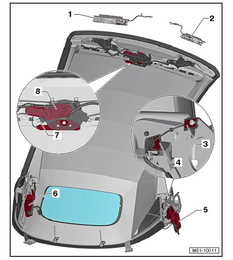

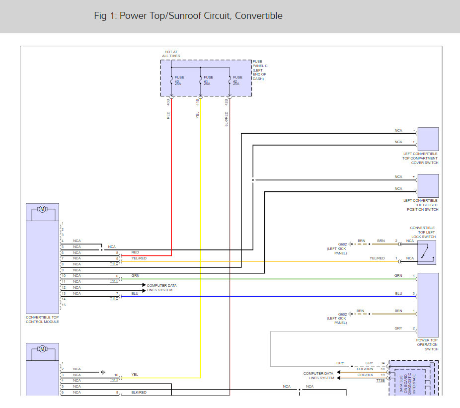

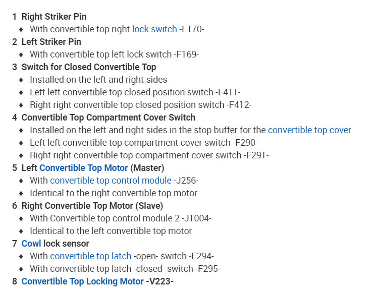

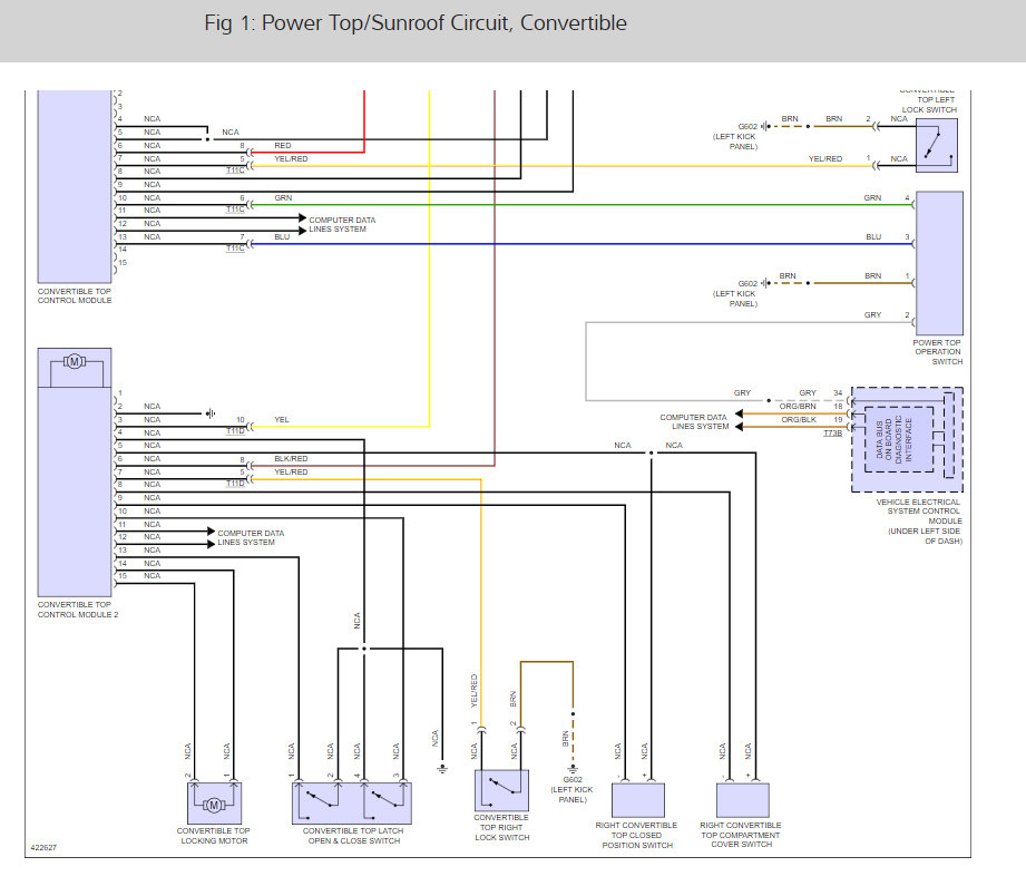

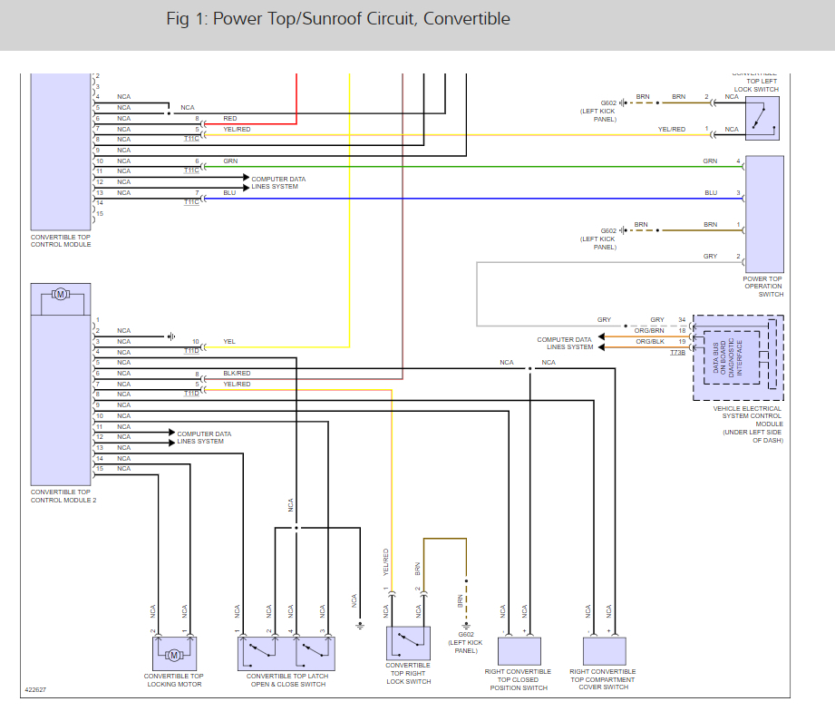

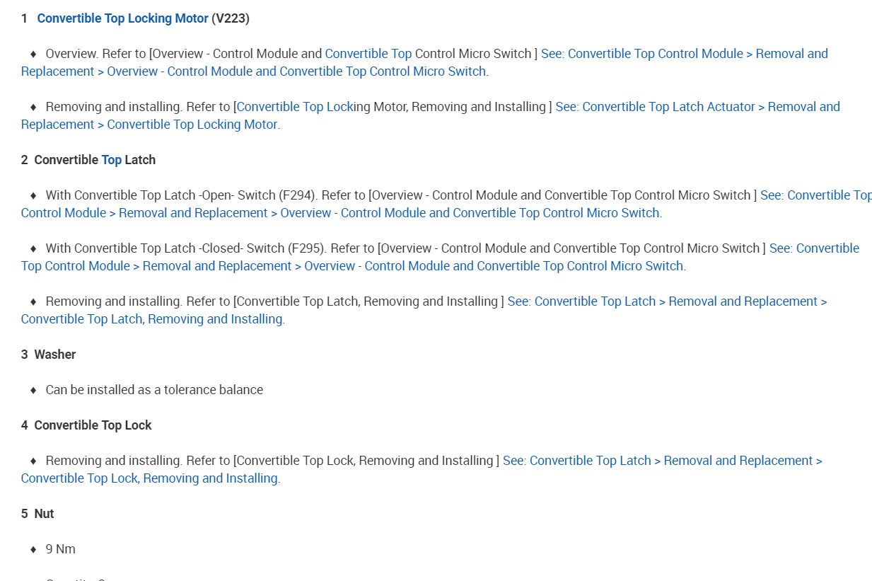

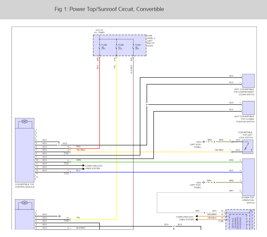

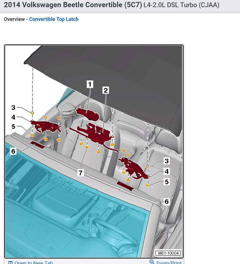

Did this start happening after you replaced it or before? It sounds like one of the top position switches is out. Here is a guide to help you test them and the top wiring diagrams so you can see how it works:
